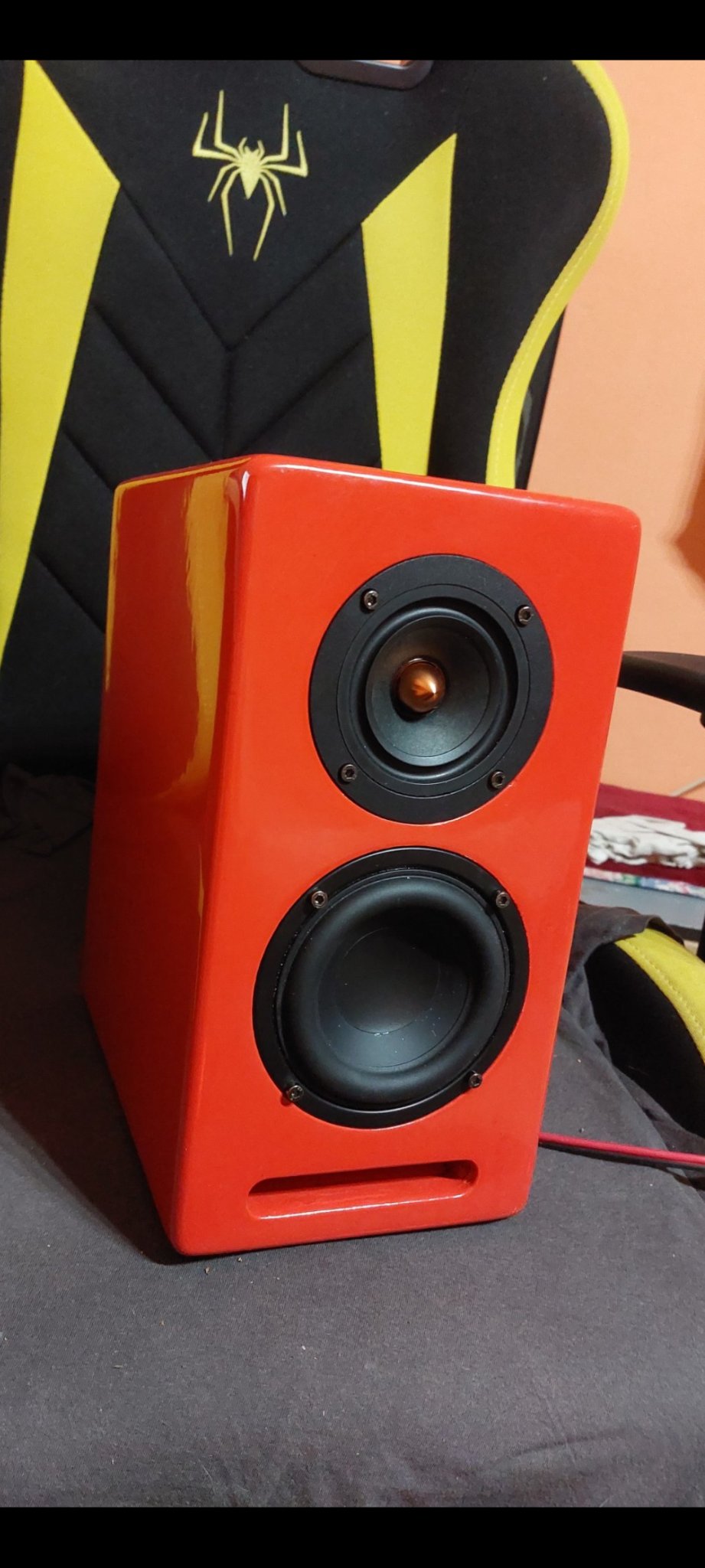

I've head these Dayton point source drivers hit way above their price point.I like the Dayton's PS-95's on mids highs. much more than mark audio ( a loved driver on this forum ). Cheap but nice built quality drivers .

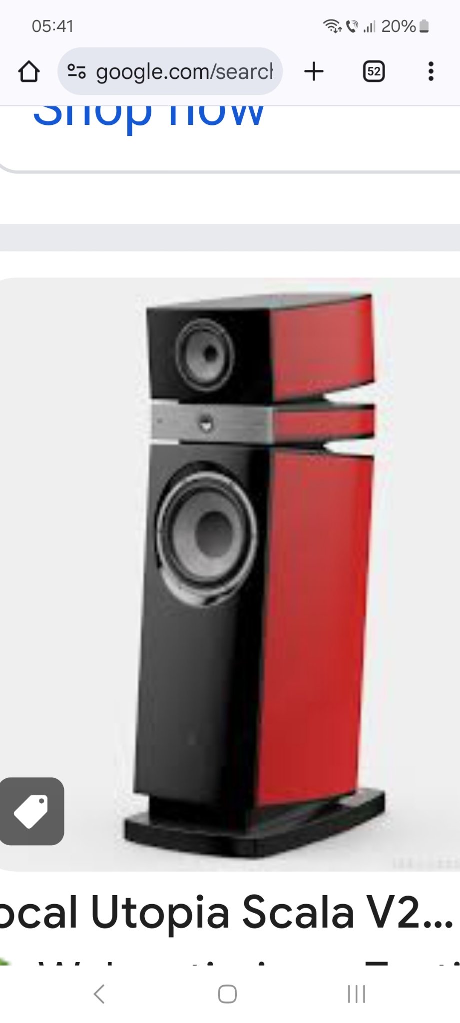

@Bmsluite initially I wanted to build a 3 way for my desktop.
5.25 or 6.5" woofers , these 3.5 daytons and some silk tweeters crossed at 4khz or higher. With separte box for each driver like Focal did . Maybe I'll make them one day .
About the daytons personally I find them very detailed , smooth , clear on the mids . Highs are maybe a tiny bit " to in your face " to say so. But still good sounding. Mark audio sounded dull in comparision.
Maybe some nice soft silk tweeters will improve the rs95's even more.I have to try a 3 way on my existing speakers.
Yes the dayton's are nice , especially for their price . Tho , I'm sure there are better drivers for your build out there and in that price range.

Interesting you show this because I was thinking about decoupling the drivers like this. If the lows are going to be handled by a 6.5 sub then I imagine putting a dome mid or a planar mid on top of that vibrating box isn't going to be very good for the response of the mids. Better I decouple it somehow.@Bmsluite initially I wanted to build a 3 way for my desktop.
