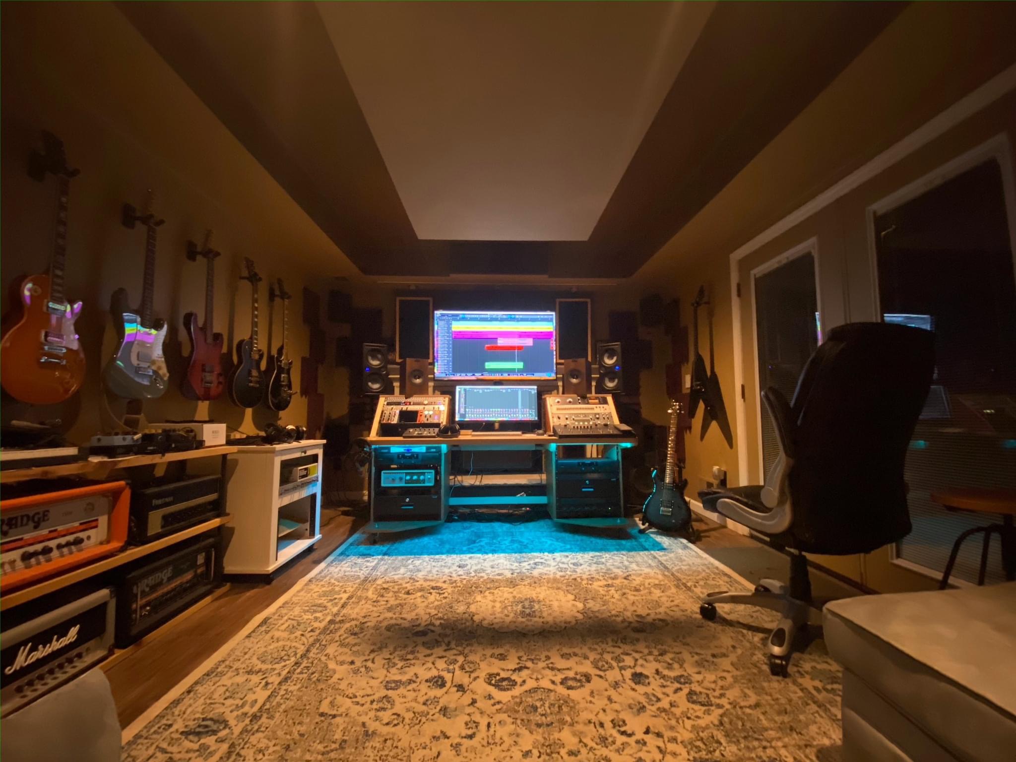

So since you’ve settled on a 3way for desktop near field use, you’ve defacto settled on a dome type midrange then. Let me share something with you
As an engineer, I’ve spent many critical hours of listening to mixes through the ATC dome……considered by most to be the finest midrange device ever. And in the near field, it is in fact very clear and revealing……..of everything….and I don’t mean in a good way for listening for the sake of enjoyment. Step away into the mid field and the issues are mitigated ……but in the near field?……the ATC will expose every flaw…….and most recordings are flawed……very flawed. Best you know now what you’re getting yourself into……dome midranges in the near field are a clinical application.
Reactions: Bmsluite
Mayhem,
Good to know. I know that is an aspect of my living room 3 way. Some tracks that are recorded poorly are hard to listen to on that system. You realize that not recording is created equal.
The flip side of this is recording that are done very well sound amazing
