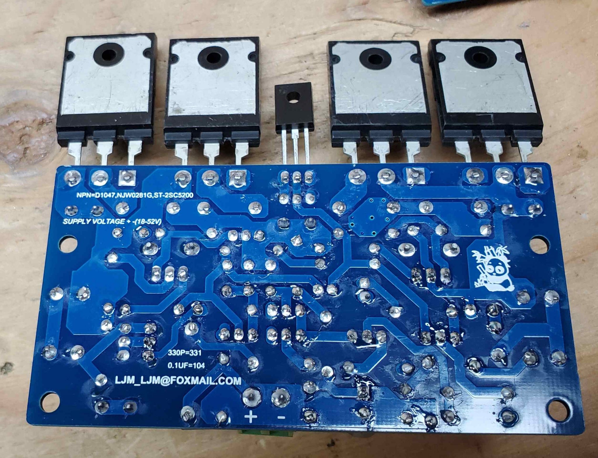

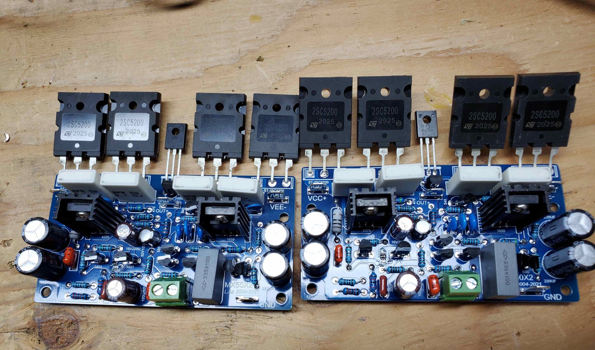

I tried the eBay MX50 DIY Kit, Class AB 100W+100W; Worked but problem
I used Nippon,i don't remember the series,i changed the first power supply electrolytic with 470uf ones ,the feedback electrolytic with 220uf.Also changed the crap input MKP? with 2.2uf MKT.Must change all the electrolytics on the board!

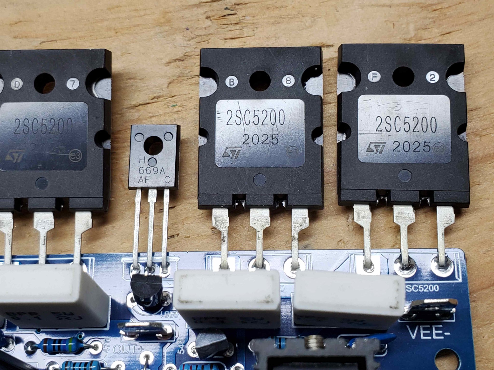

I would probably order and replace the 2SC5200 with a TTC5200 bought from Digikey or some reputed seller and not eBay.
The reason I commented was after seeing the 5200’s mounted on the board in the above pics having different marking style, which would not change even if the plant where the transistors were made are different.
Do you have a reference link to compare the 2SC5200??
Don’t have links but if you see the way those devices are marked they do not look correct when I m comparing it to my ST TIP3055 bought on RS.
And ST I think have obsoleted sc5200.
The way ST TIP3055 is labeled versus 2SC5200 is not proof.
Of course the 2SC5200 is obsolete, and we can say that this clone of the x-a50 is obsolete too, but I don't care because the musicality of the MX50X2 is really to my taste.
Pretty much anything xx3055 is ancient (50 years old) compared to xx5200 (10 years old). 3055s are 10 times slower, and 30% the voltage rating, .... ST "obsoleted" just means they quit making them, but that does not mean that other brands 5200 parts are obsolete.
I ST and OnSemi still makes TIP3055, and is an active product very much.
I am using them on Elvee’s circlophone - Class AA and they sound pretty nice.
Also 5200 are nearly 15 years old IIRC.
