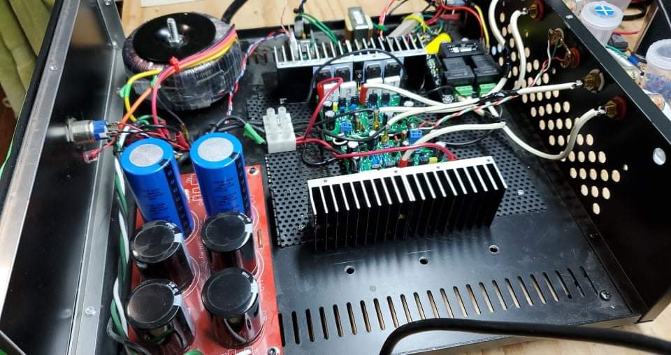

I tried the eBay MX50 DIY Kit, Class AB 100W+100W; Worked but problem

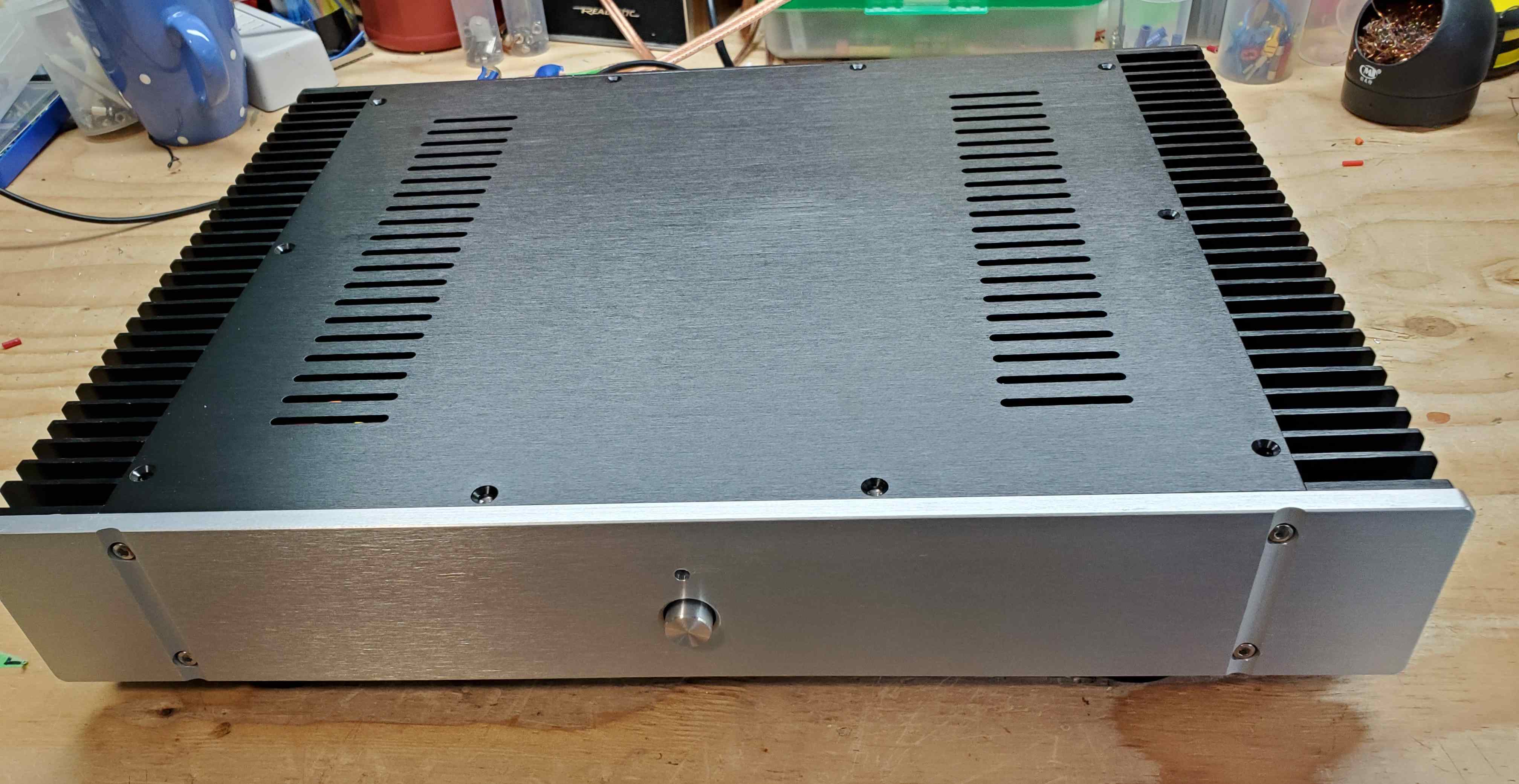

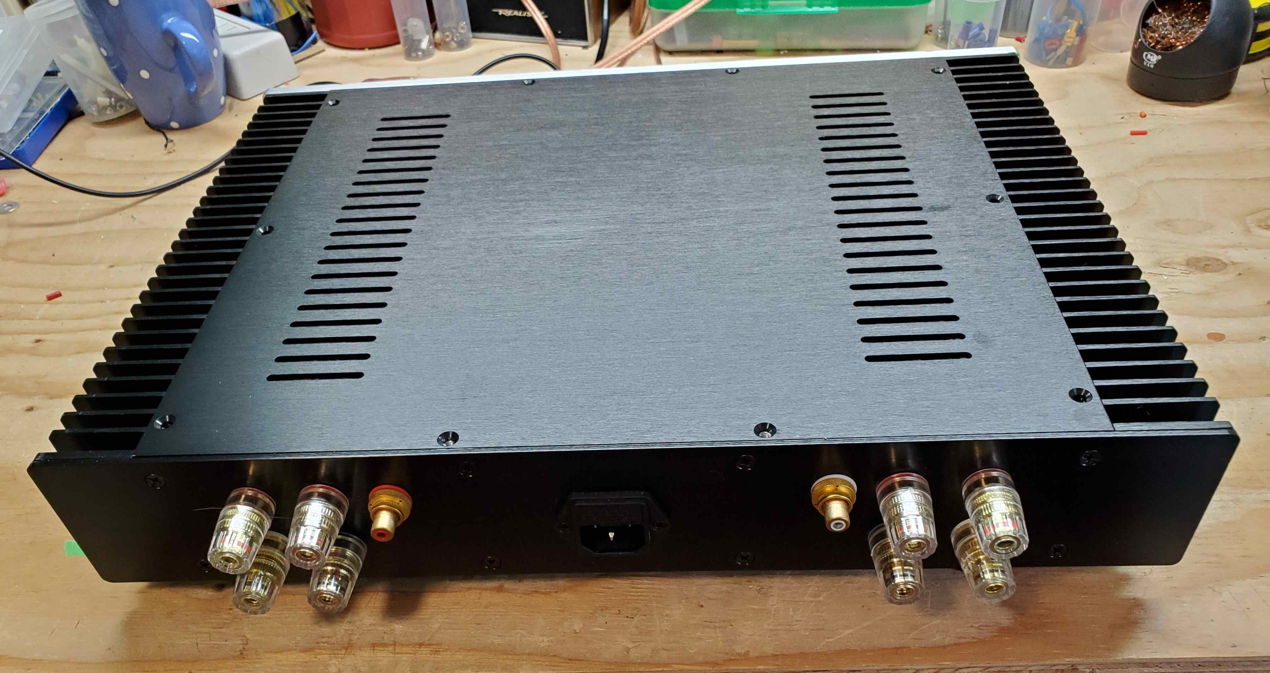

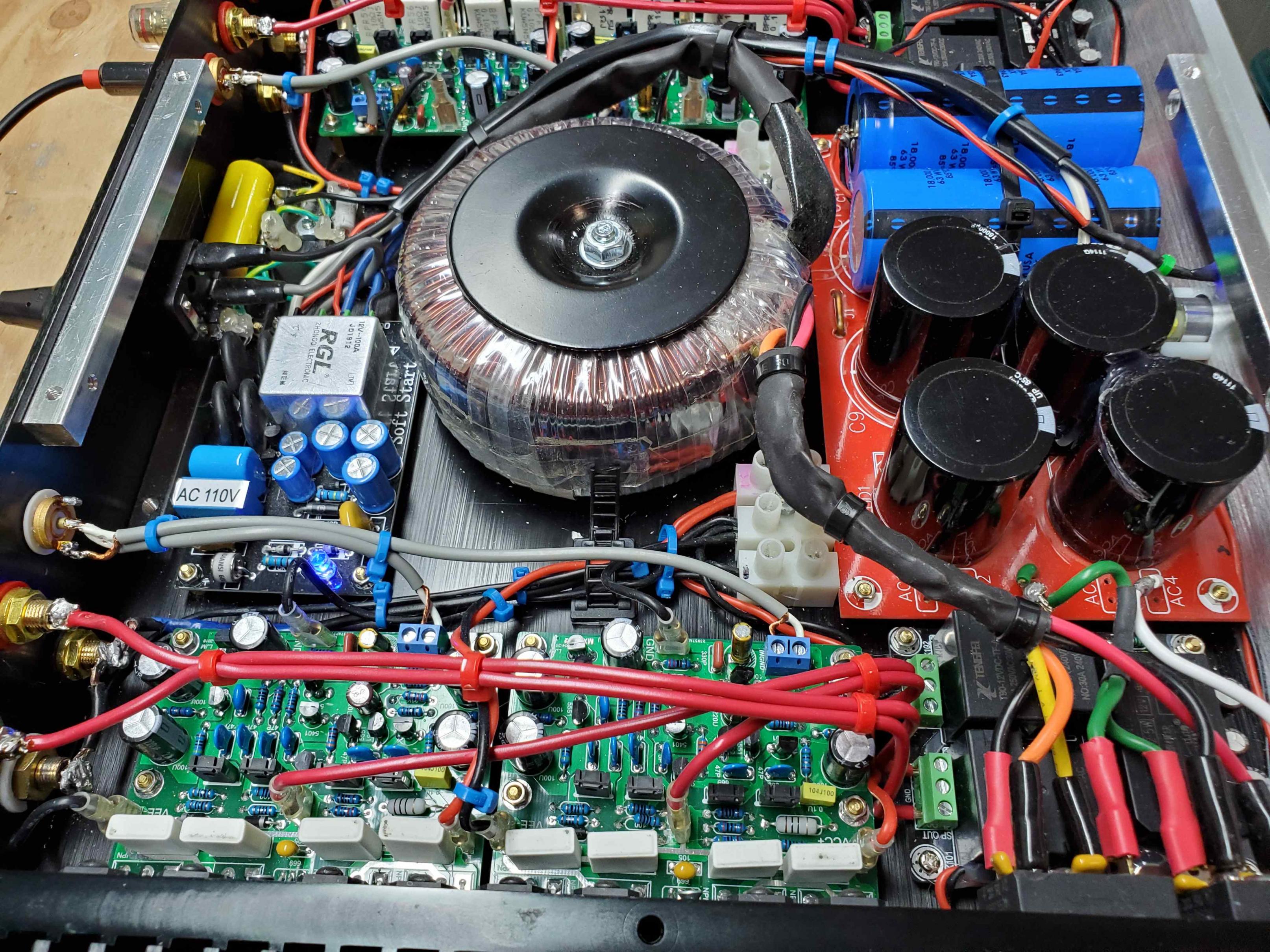

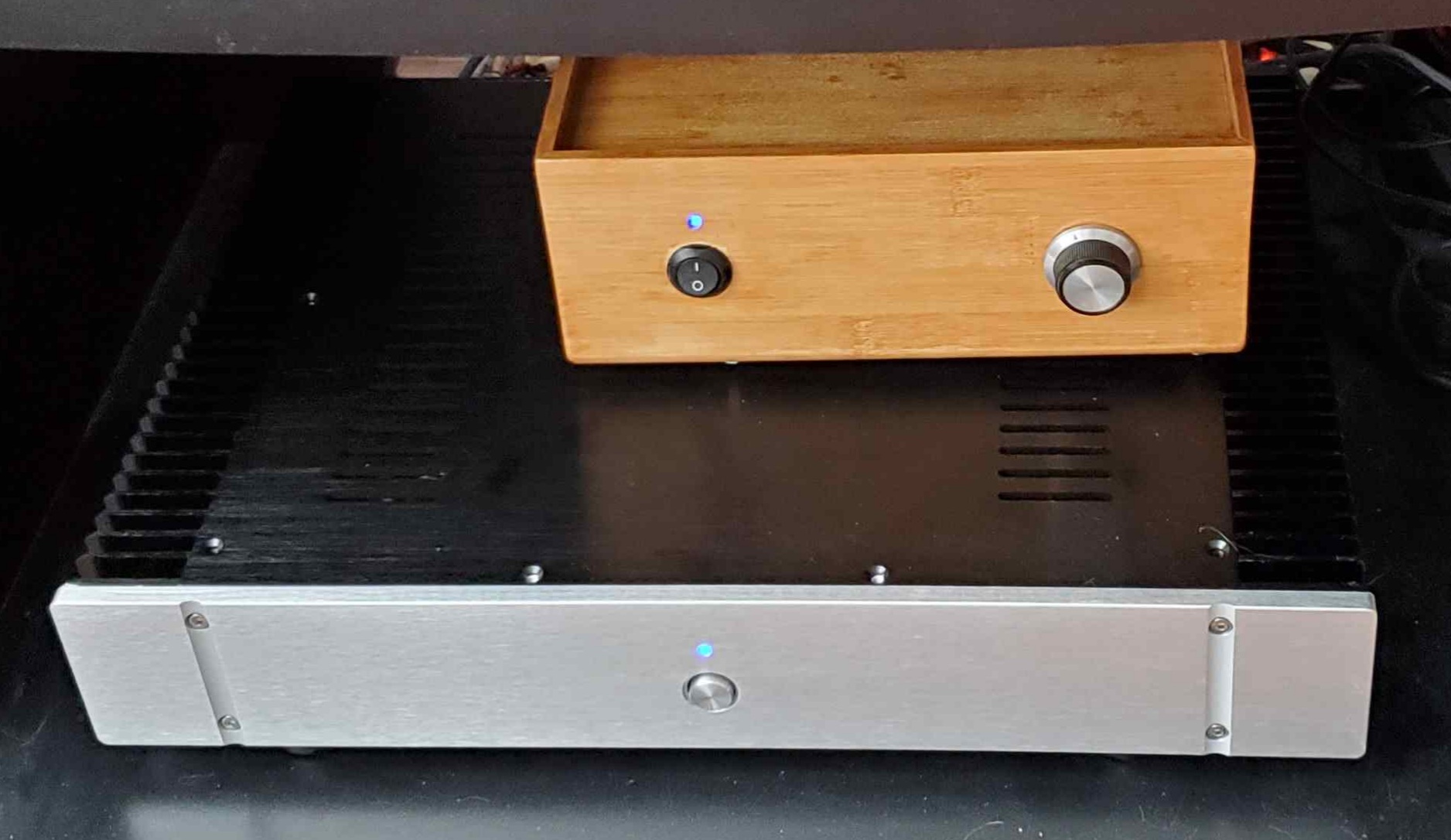

I have mounted the MX50X2 in another existing enclosure.
On the ljm thread, members told me that 47vdc was too much for this amplifier, especially with 4ohms. So I left the 37vdc transformer.

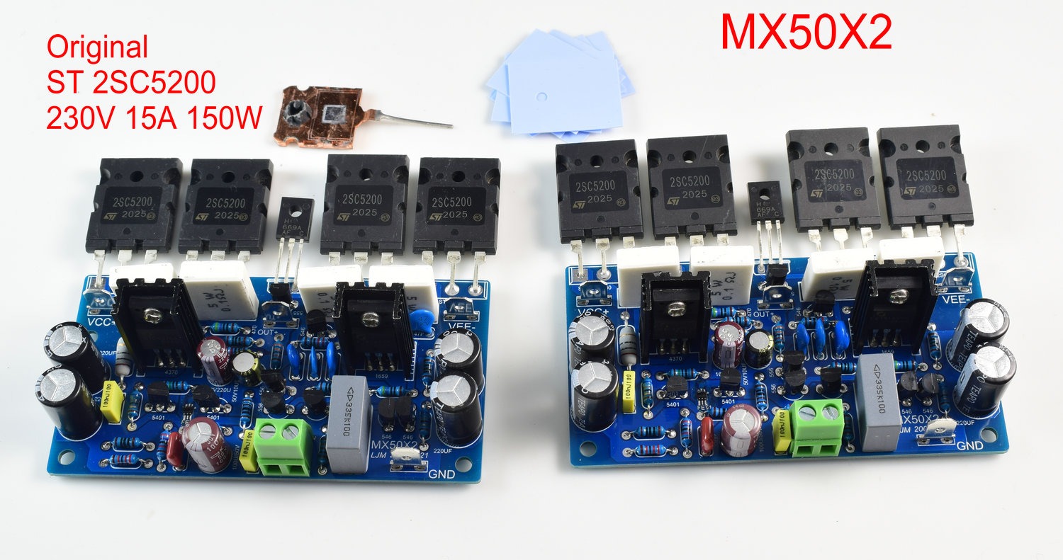

I would like to go into bi-amplification with this amplifier. I have a question, does anyone know this PCB from ljm?
1pair Original Clone British X50 Classic Musical Fidelity Power Amplifier Board | eBay
Unlike the other, it has its own PSU, it's more or less good news, because it doesn't seem great ... the good news is that I have 2 other 100va transformers that would go well with these PCB.

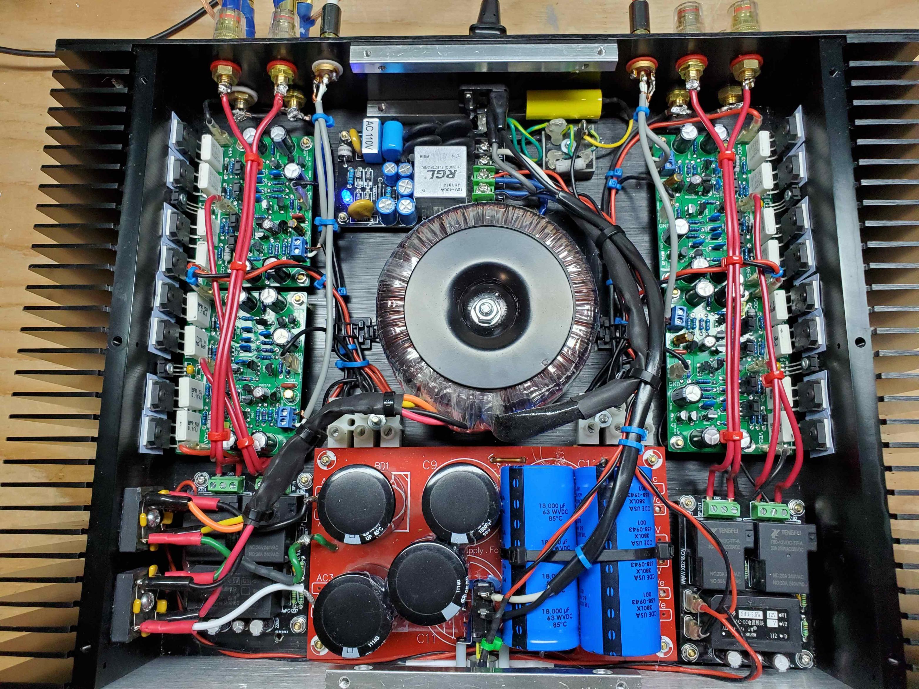

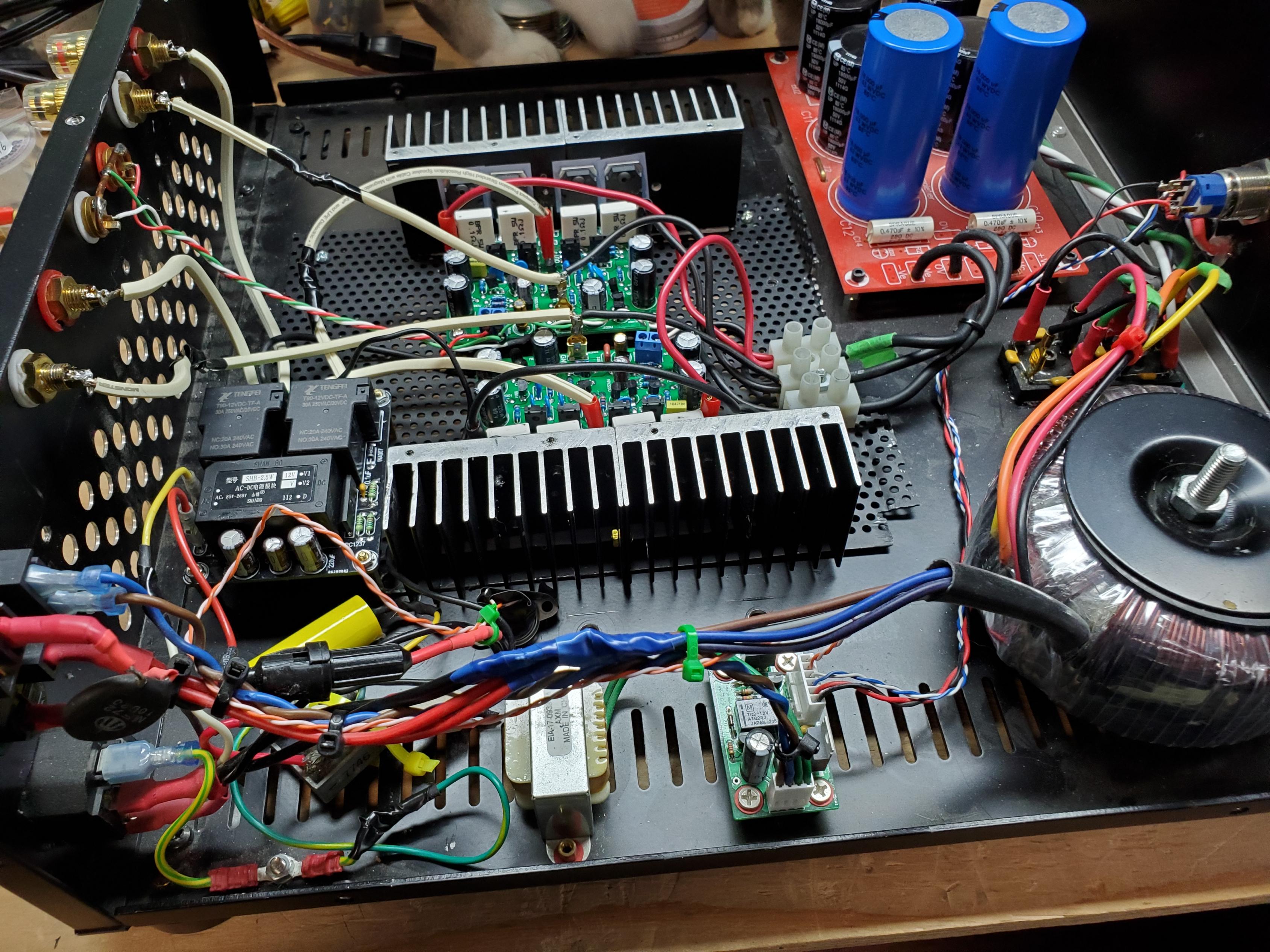

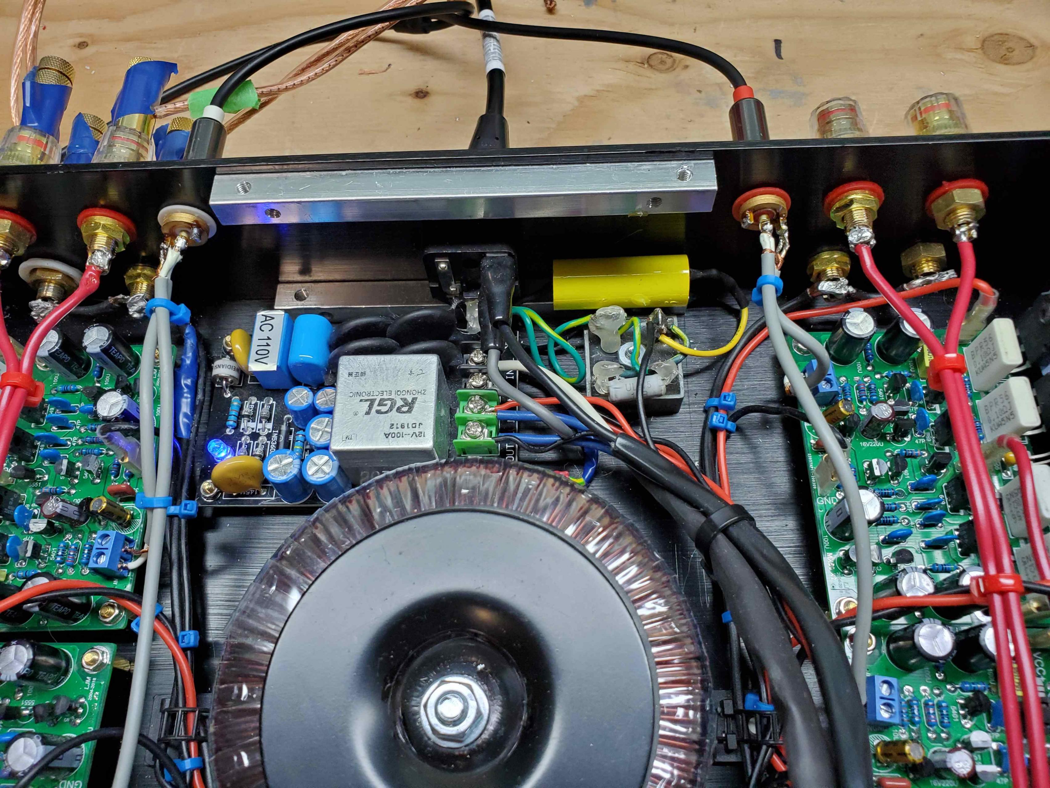

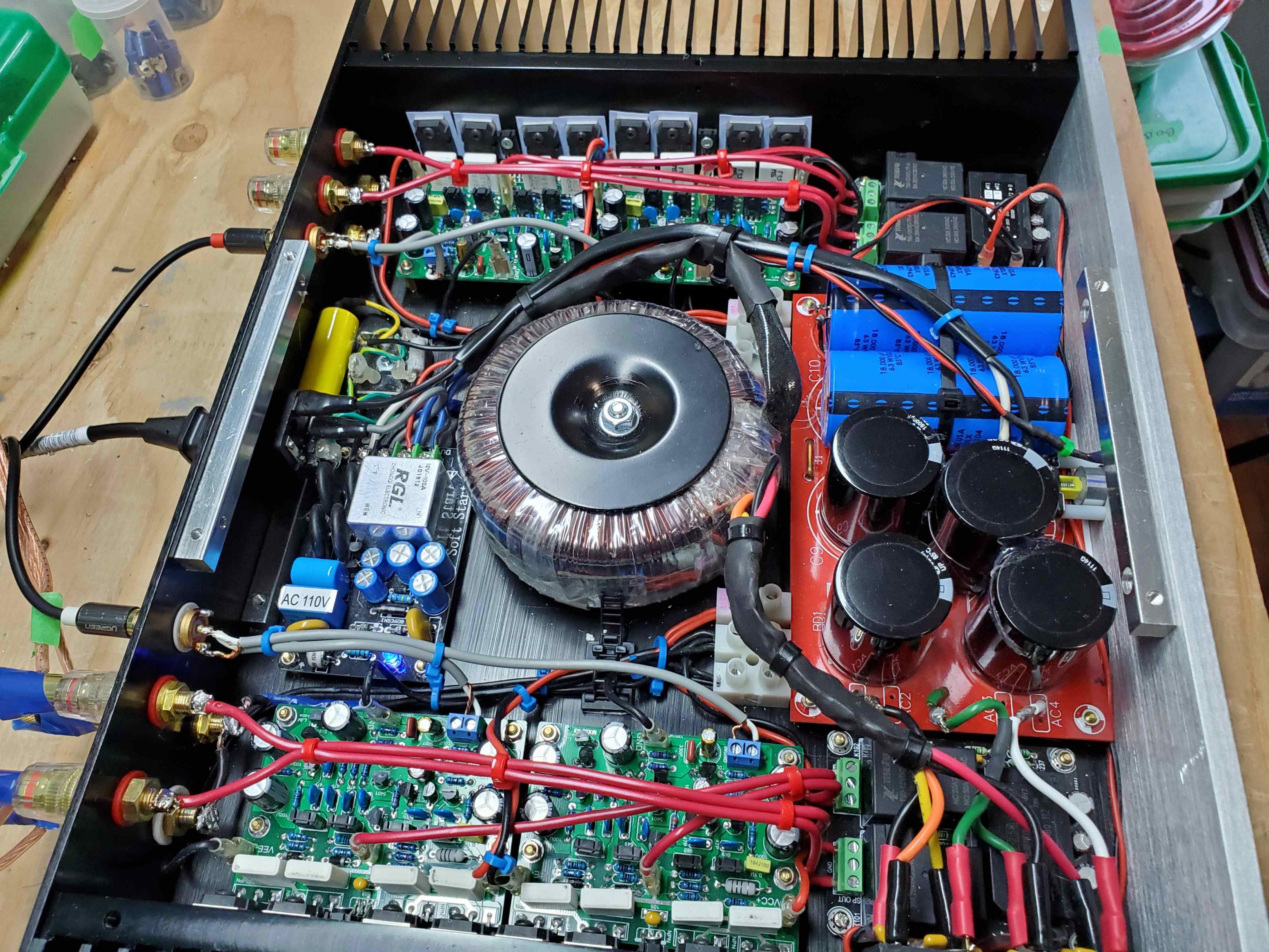

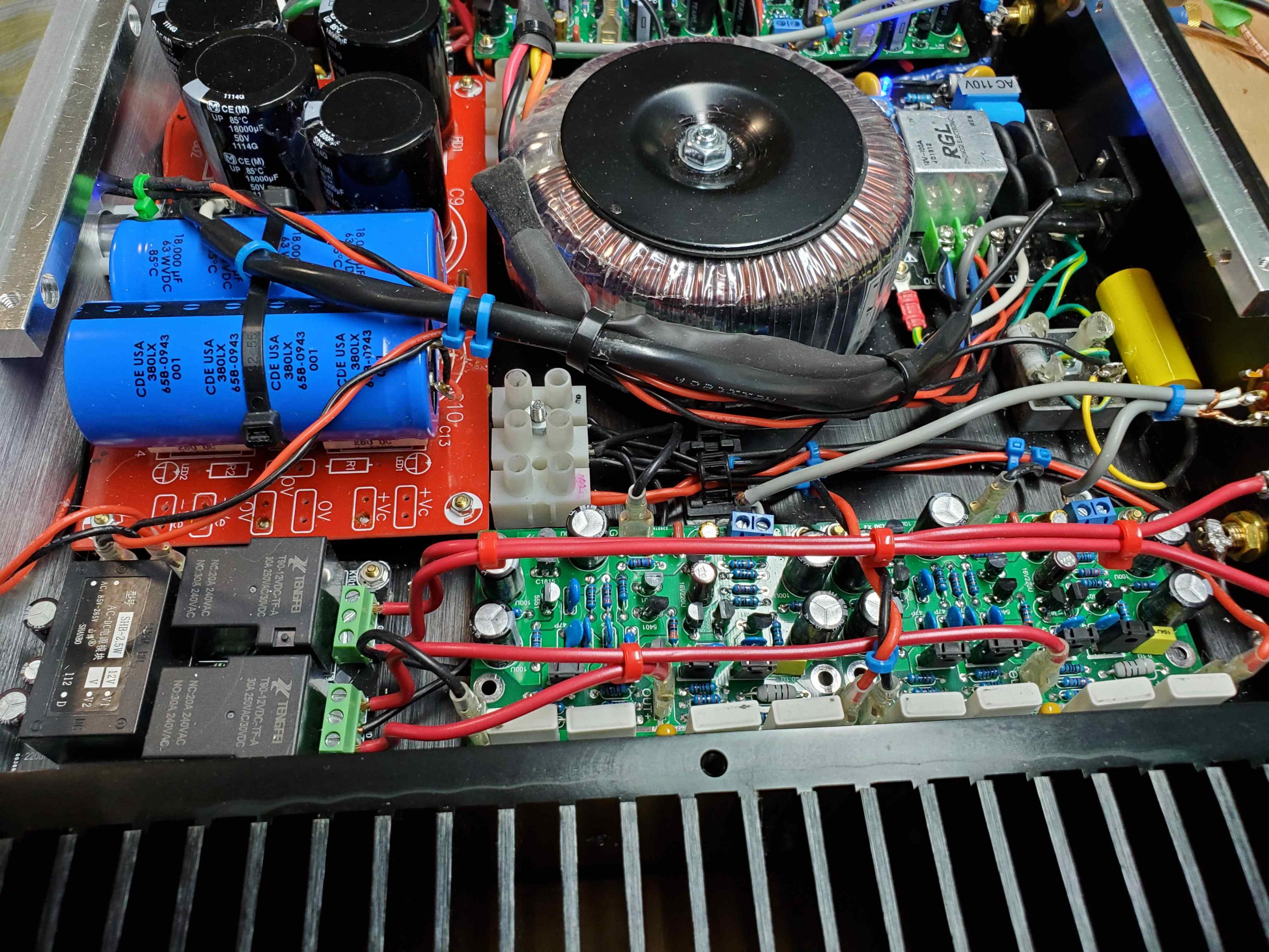

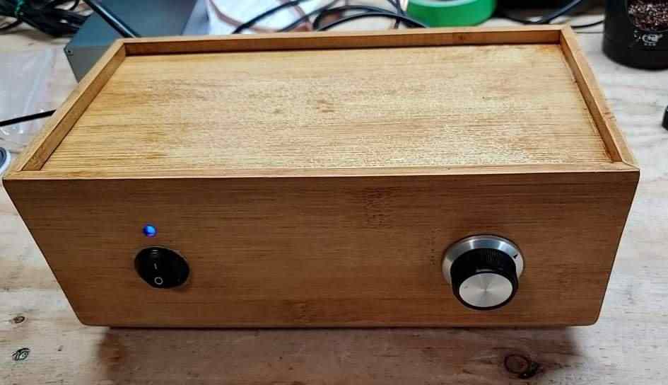

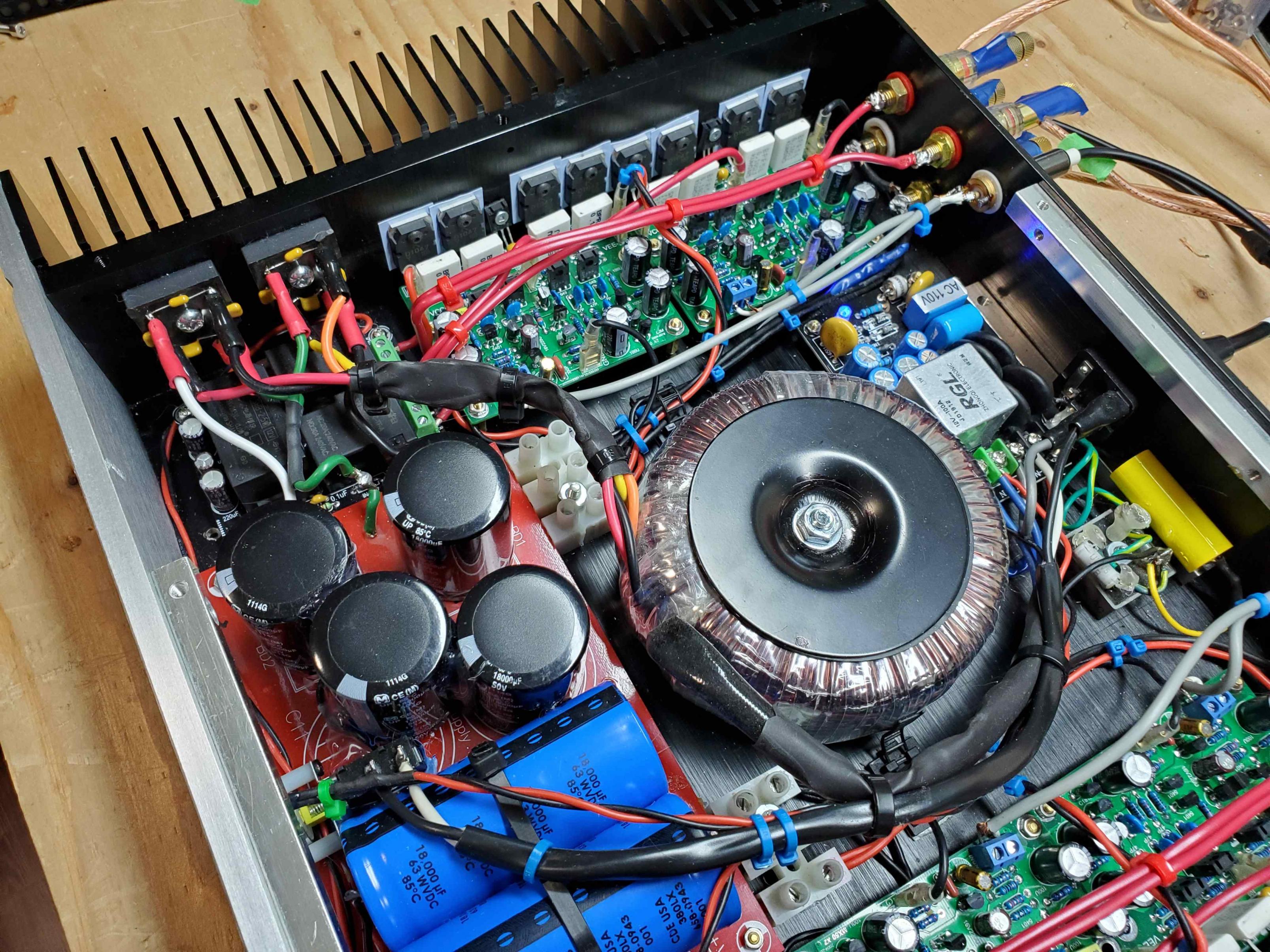

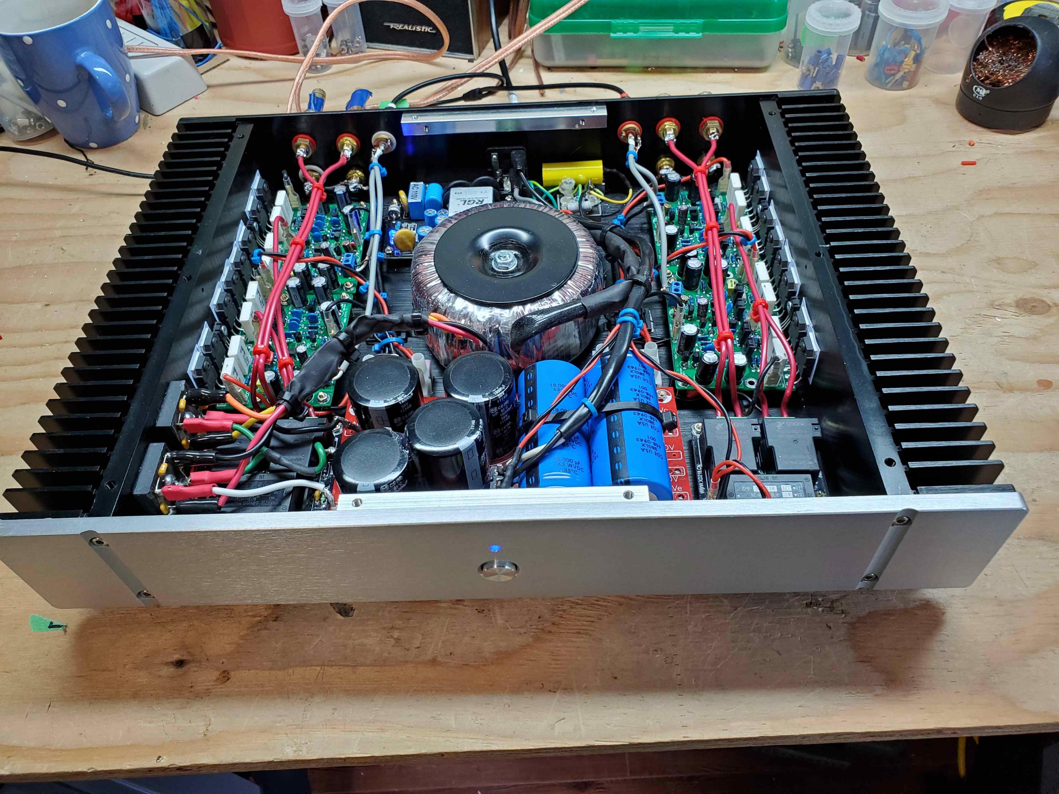

I'm still waiting for my new slim case.
I decided to put a 2nd pair of MX50X2 with a single power supply for the 4 PCBs.
I was hesitant to separate the amps, but I really like the sound, so my speakers will be bi-amplified drivers. These are 3-way speakers. The woofer is 4 ohms and 8ohms for the midrange which is cut into 800hz and 8khz.
So on a pair of amplifiers I will install a potentiometer at the back of the box to adjust the woofers with the midrange/tweeter.

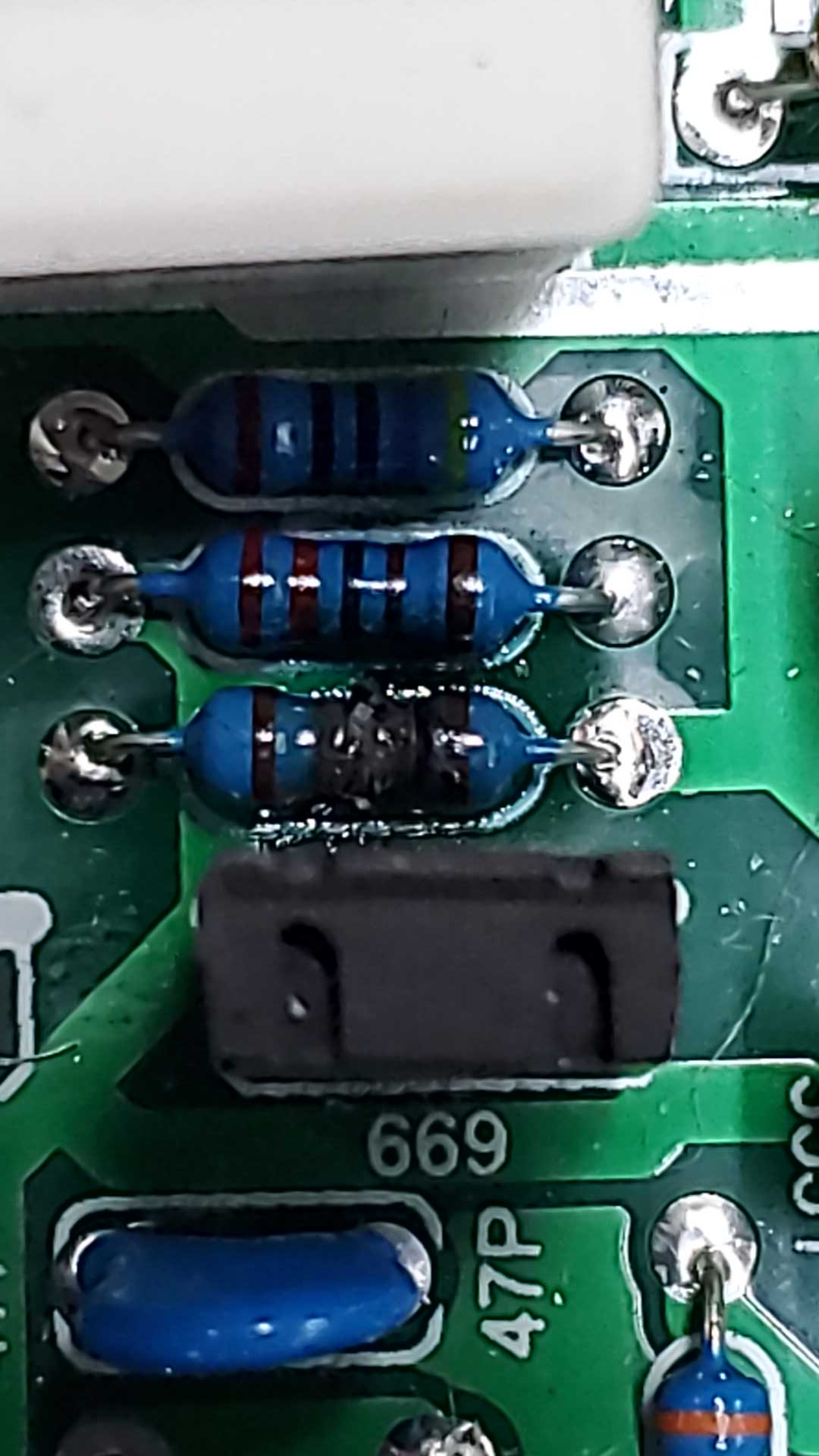

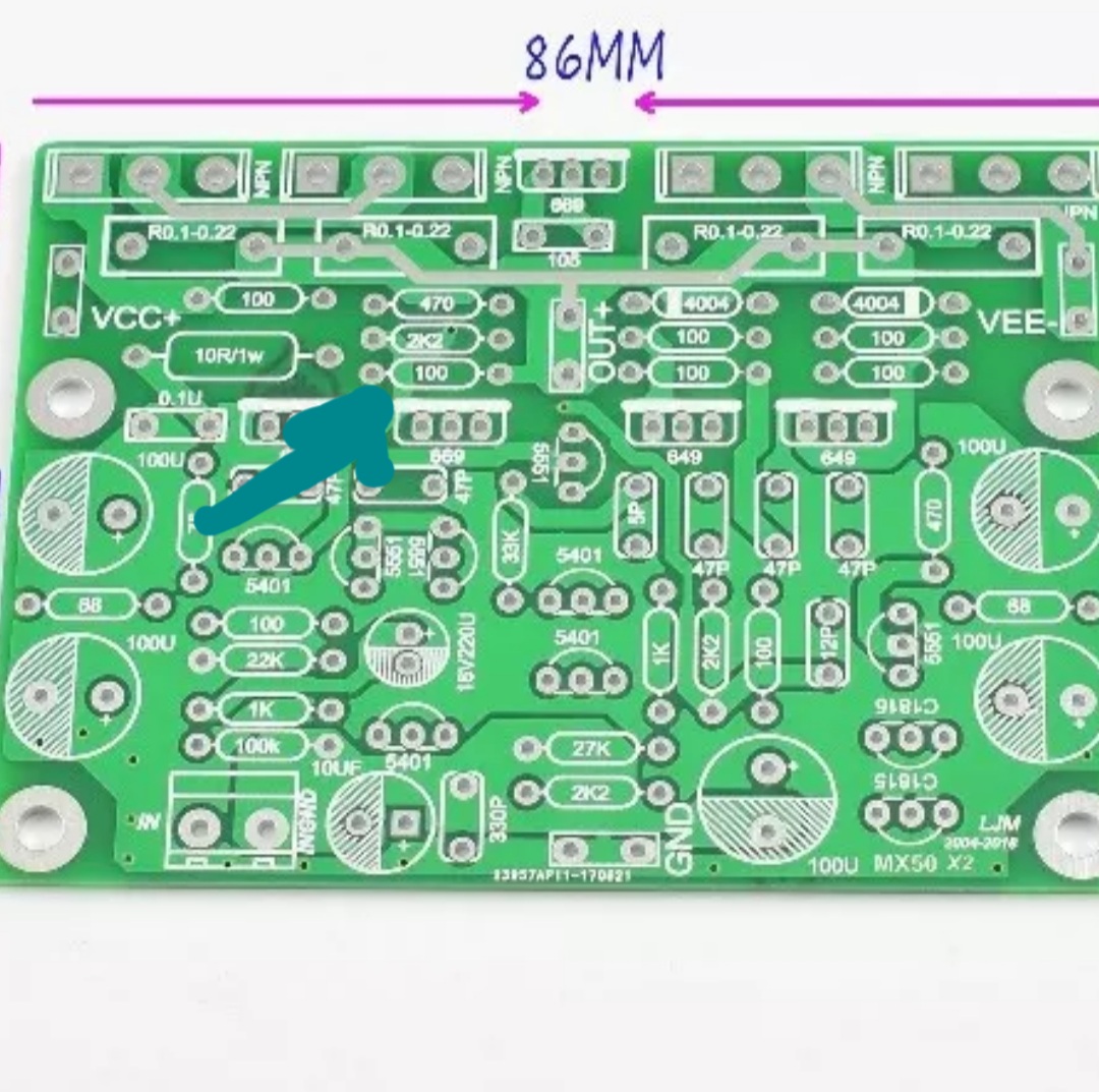

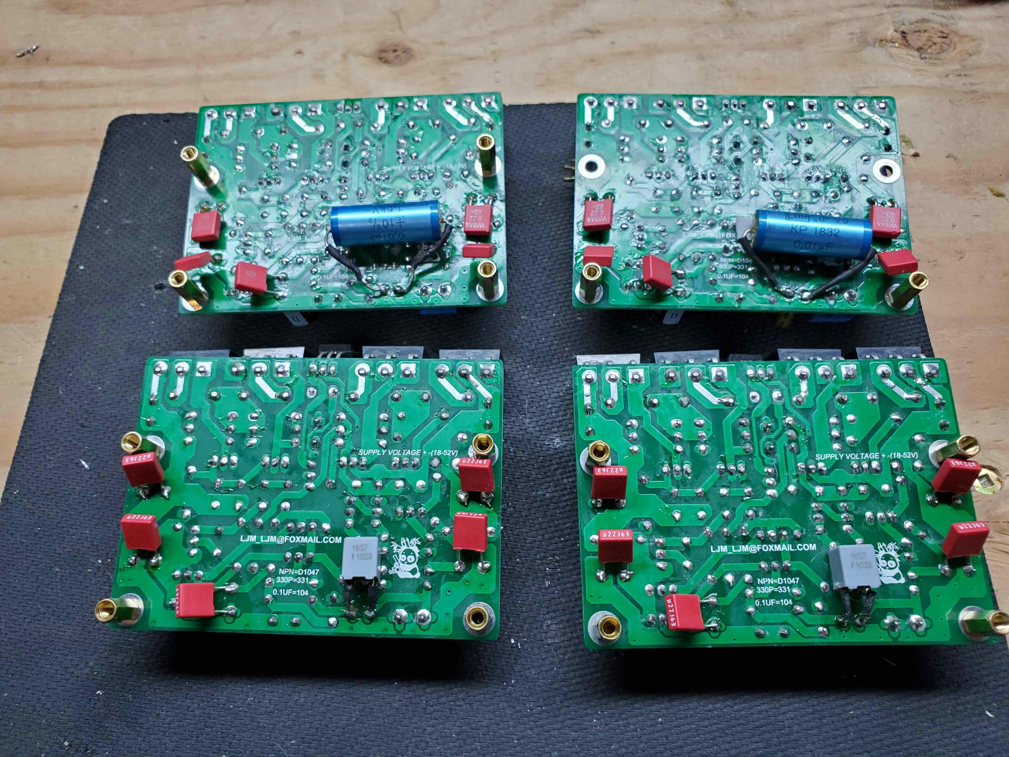

I have 4 MX50X2 PCBs, 2 that have been working for months.
I added 2 more, and 2 new ones, a resistor went up in smoke on my test bench, after only 2-3 minutes.
Could someone help me and tell me if the change in resistance is sufficient.
Check the photos.
Denis
