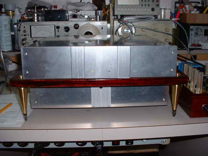

After months, I about to complete the actual mounting into the custom casing that I designed and built.
You'll see in the post of the next few days the birth of my Tube DAC. As you probably know, the casing is made of two enclosures mounted on a wood plate suspended on three points.

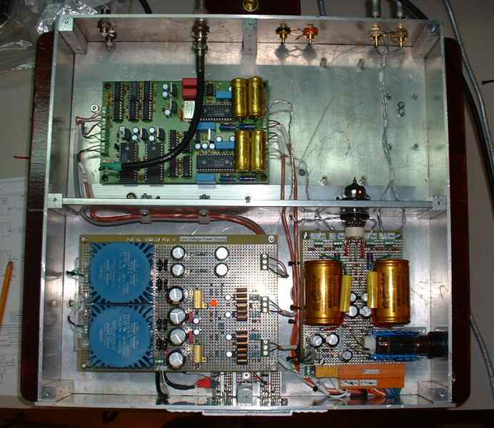

The top module contains: DAC digital, DC Supplies, Tube HV Supply and Tube Outputs and Op-Amp PCBs. On a central plate will be mounted the two bi-colors leds PLL and HV.
The bottom module contains: AC input and EMI filter with Main Power On Switch, HV and filament transfos and the HV filtration choke. On a central plate will also be mounted the HV On/Off switch and the Main Power On blue Led.
The central plates on both modules are desing to give some distinctive look to the front panel. You'll see what I mean in the next post.

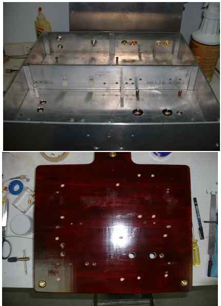

After completion of the case I had to drill all the mounting and wire assy holes. To do so, I had first to figure out what wires to install and where to run them through each modules and PCB.
To increase the mechanical strenght of the complete DAC and provide some insulation between the DAC PCB and the HV and Supplies, I install a big piece of 1/4"-2X2" alu channel in the middle of the top module. The piece is bolted between both modules. It is very rigid 😀 In addition to this central spine, there 4 others screws, one in each corner that hold the modules together. Finally there is cable clamps installed at strategic location to hold wires.
I had also to drill the wood base. Check the images

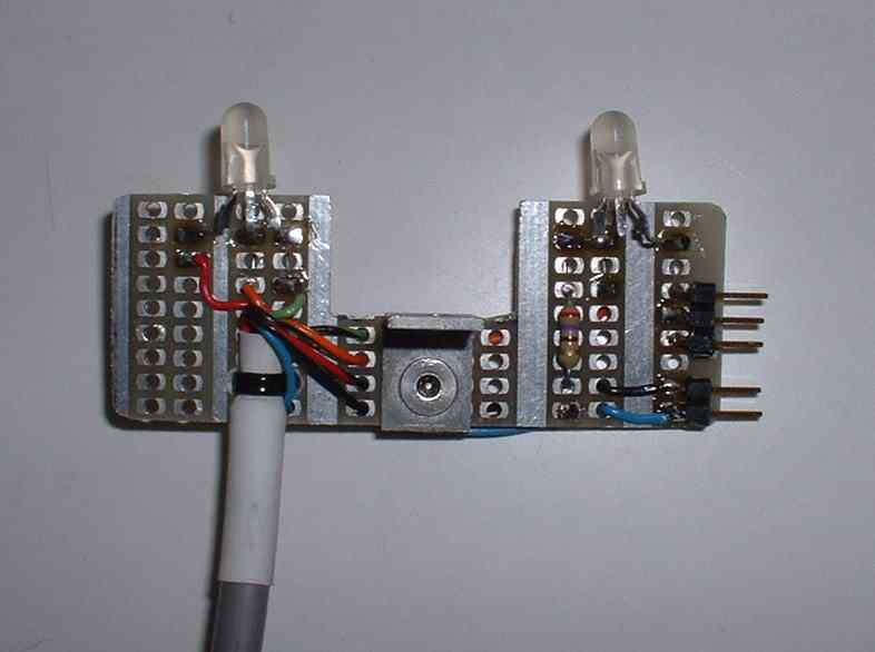

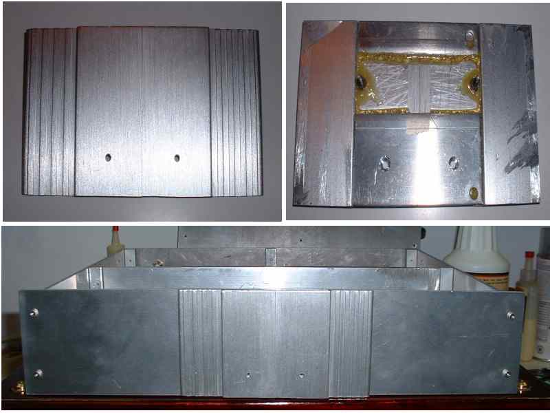

This is what I meant by the central plate. This is the one for the top module. It is done using piece of modem casing, cut and glued together. There is also two mounting screws glued on the back. The images are showing the plate, the plate's rear and the plate mounted on the front of the top module. It will receive the two leds, PLL and HV.

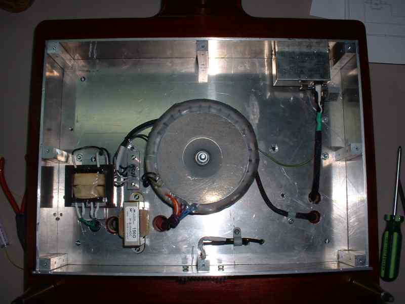

This the completed bottom module. The big toroidal is the HV supply with electrostatic shield. Then, I modified the Tube section to accept 6N1P tube and the filament section of the transfo had not enough current for this tube. So I added an separate Hammond filament transfo. There also a small Hammond choke for the HV CLC filter. They are all mounted just under the HV supply, so the wires are kept to their minimum. The transfos are mounted using a bitumen and neoprene sandwich to reduce vibrations.
On the back we can see the AC input module with EMI filter and Power On switch.
On the front we can see the blue Power-On led and HV switch mounted inside the small 3/8 bar. There is also two small insulated standoffs used to connect both transfo L-N supply lines.
The wire clamps keep the wires nicely routed 😎

I just completed the interconnection of all the PCB and the sound is superb. 😉
The only part missing is the solid stage amp section. I'm planning to rework the class-A Op-amp as my NOS 1545 DAC using FET's biais. This is not really a big miss because I included mainly the solid state section to demonstrate the much superior tube section sound in the first place, and to do some experiment.

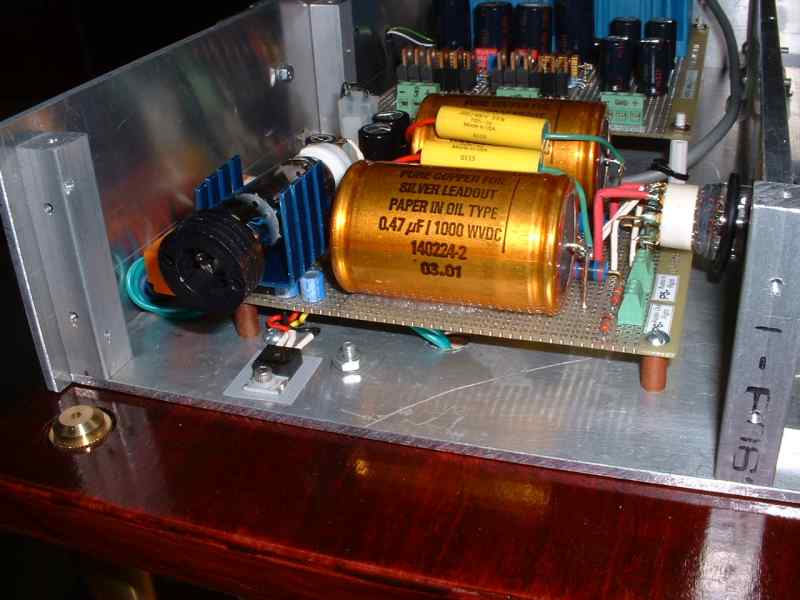

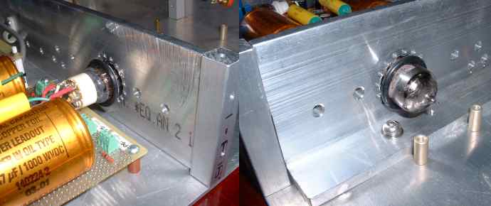

I had to rework the tube section to have the tube mounted horizontally, so I can close the top cover. Here some details of the tube section assy. You can see the rectifier tube with a small heatsink on top and the filament 6.3V LM317 regulator mounted directly on the frame for heat dissipation.
The amp tube pass trought the central metal cross member that then act as a heatsink, see next post...
