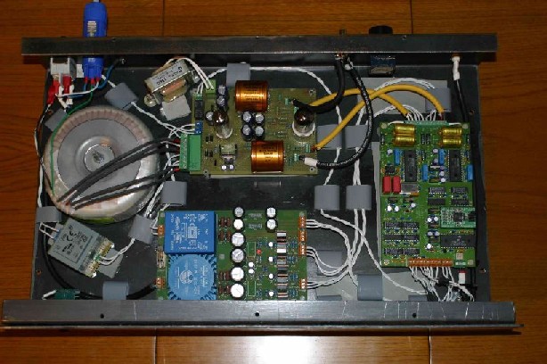

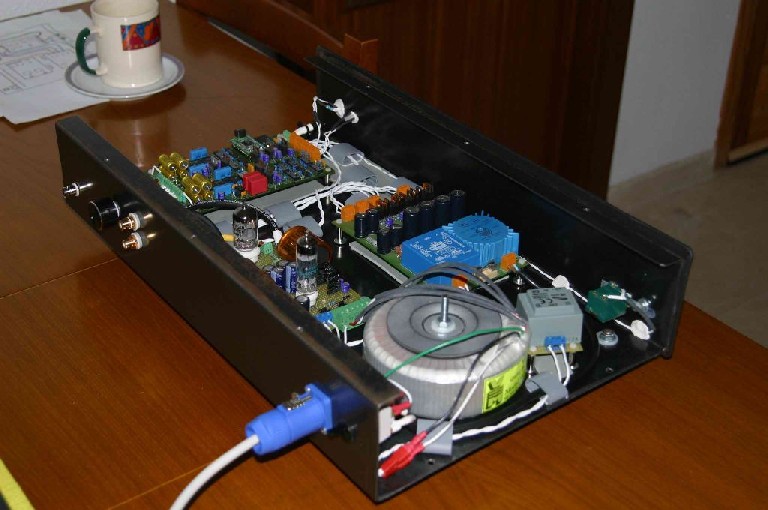

thanks for the picture
Algar,
Thanks a lot for the picture!

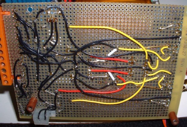

Wire I used
I used AWG 18, Teflon coated wire. It is a multistrain OFC cooper, silver tinned.
Bye...

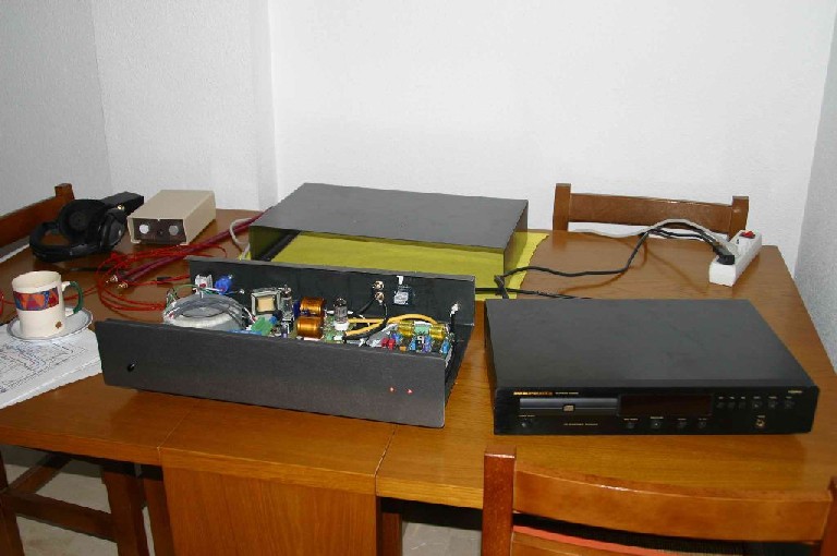

my tuba dac finished
Finally, I finished Guido's team "tube dac".
Thanks to Guido Tent and, specially, to algar_emi, who help me more than a lot.
The results are fantastic:
The combination of this Tube DAC with my modified Marantz 6000 (which include, among others, Guido's XO clock, fmax clock' supply and some suggestions by Rickpt) make my equipment to play in other league (first division).
Amazing on reproducing details, tones, and space.
I have compared this combination with a Cary 300 (with valves output stage) and some others players from some friends (including a Quad, a new Rottel and a modified Meridian. Only the updated Meridian is something similar about fidelity.
Higly recommended.
Again, Thanks a lot to algar_emi.
