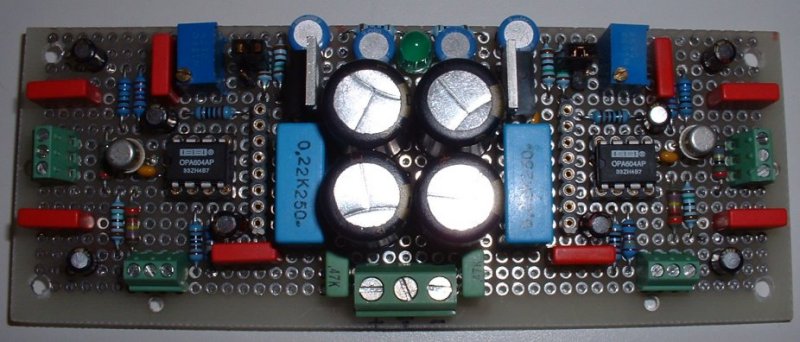

OpAmp Line Stage Completed
Here a picture of my Op-Amp Line Stage completed. I made a few change to my version 1.
Added a 100K input resistor to prevent OpAmp floating input.
Change OpAmp gain to compensate for the attenuation of the emitter follower following stage. Total gain 20.
I made a rather complex little supply running on the +/-26V of the AUX supply of my DAC.

OpAmp Listening Session
I'm really happy with my OpAmp Line Stage. Nice soundstage, high not agressive, good bass, voices are nice also. I listen to Garry Willis, Sting, Flower Kings, Diana Krall, Steely Dan and Stereophile Test CD2. All great!
The AD825 was a real winner over the OPA604. I don't have the OPA627 to compare yet.

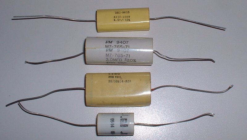

I have to use a coupling cap at the output. The circuit produces -4.45V dc at the output. So I had also the chance to compare 4 coupling caps type that I bought at a surplus store.
They all seems to be film caps from 3uF to 5uF.
Here also, a real winner, the top one on the picture, marked BEC-9613, 4uF +/-10%, 200V. Sound is great with it.
Final schematic will follow...
