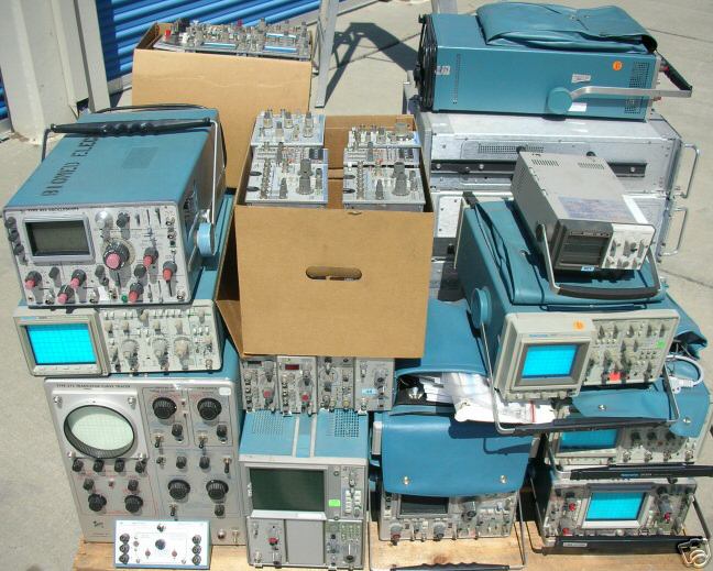

You could grab this pallet for $1,600 at eBay

@apassgear:
Yep, it'sallways that we hear of guys who get so good things so cheap in ebay.
Well, we sometimes hear from people who got terribly s..cked do to a ebay rip off - but let's ignore this simply ;-)
So apass, go and try your luck ;-))

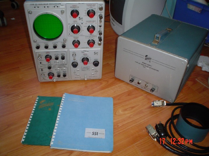

I was already hooked when i saw this scope.
The owner had difficulty parting from it.
The scope is fully functional and well maintained, with CA and L plugin units, and all the manuals in as new condition.
Don't tell the girlfriend i am starting a Tek collection.
