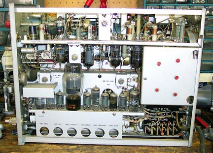

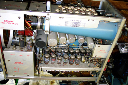

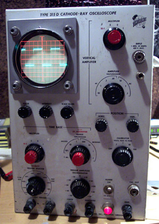

Actually I was wrong on the model#, its a 315D... donno why I thought it was a 310. Here is a bottom view showing the ceramic strips. These strips have silver inserts where the solder connections are made. TEK always placed a small roll od the correct silver solder inside each scope clipped to the chassis. If one does not use silver solder then you risk the silver insert seperating from the ceramic strip.

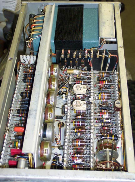

On the left section you can see the black tubular caps that are clolr coded. According to one retired TEK engineer on the TEK Group forum these caps are the main reason why so many tube TEK scopes cease to finction. Merely replacing all these caps brought my scope back to life. All the tubes tested good as did the electrolytics!!
All photos were taken before restoration!!
Mark
Mark
