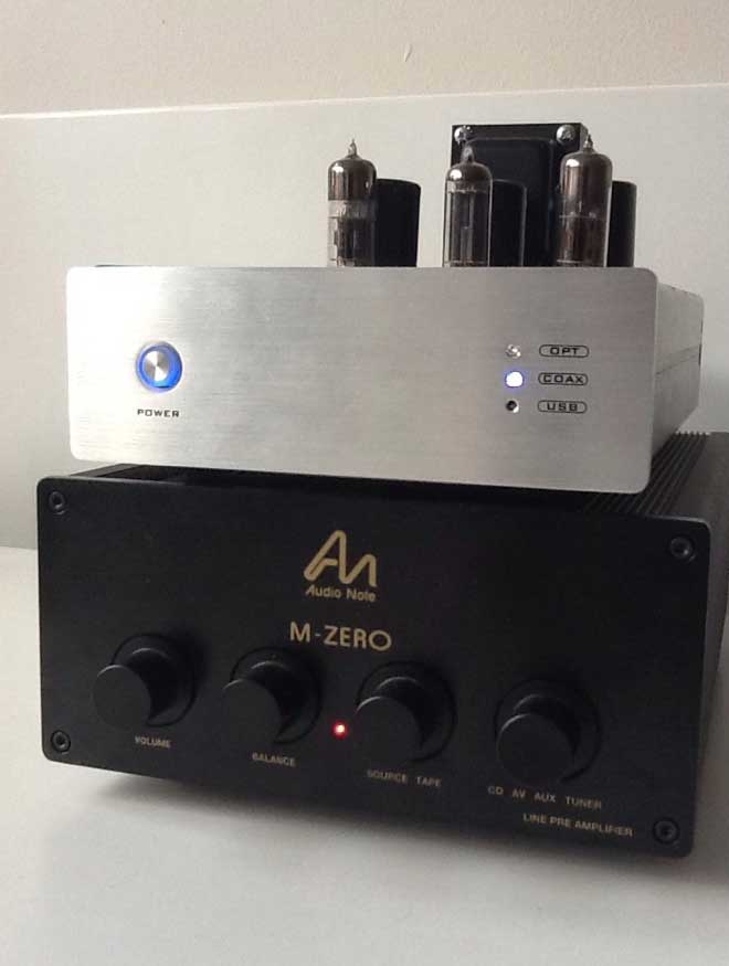

Wolfson meets tubes
Last week I did a few mods : removed filter and amplifier stage, replaced all caps round wolfsons, used Oscons, placed tube buffer including tube rectifier and extra power supply.
