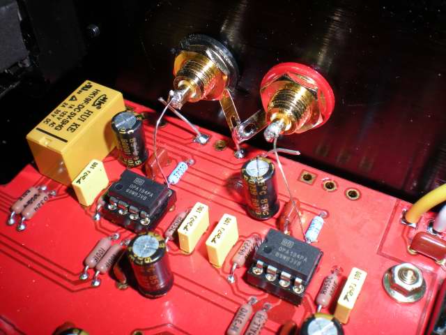

Thanks Riddellsr. The output cap and relay were not shown on the circuit diagram given by Hui. I further checked the circuit, the caps near the output terminals are not connected to the output. They are caps for the power bypass.

which confirmed the connections for the power from the burnt toroid as already stated by bigpandahk the front ones are 0-9, 0-9 while the other two are 0-15, 0-15 however on brief power up there was a wisp of smoke means there is a short circuit. Checked with multimeter which confirmed that some of the rectifier diodes are bad will replace are 16 diodes (IN4007). Could someone suggest a better one in its place.

I will replace those 1N4007 with UF5404, a fast switching diode. Regarding the transformer, please note that the second 9V output should have 1 Amp current.
Unfortunately I have already ordered the transformer 0-9v lines being 0.6 ampere. Replaced all rectifiers and the DAC is up and running. There are many suggestion to tweak this DAC what should be the most effective mods which can be easily apparent on listening. Not interested in minor improvements.

There should be no problem replacing the damaged diodes with the same 1N400x. The AC frequency is no where near needing any kind of fast switching diode.
As already posted the DAC is up an running. Few of the rectifiers had malfunctioned leading to a short circuit in one of the secondary windings leading to heating and short circuiting of the rest of the primary and secondary windings turning into an inferno before the fuse blew.
All it took was a change in all rectifiers, toroid and a voltage regulator.
