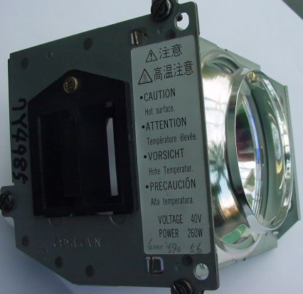

Hello Ywh,
I really am not shure that my lamp is 40 volts, other than the text on the lamphousing. I include a picture of it, maybe you can read the Japanese (chinese?) text on top.
Thanks anayway, I will just try the lamp you are sending me, and I will keep in touch about the results. It is pretty exciting stuff, these lamps..
Harrie
Harrie
Hi !
the Chinese is same as English: Caution hot surface.
thank haver1 ! you help me now. I see the "40v ".
