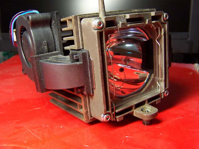

ok, just loosen the plate? i thought it wasnt tight enough. and the other terminal, am i fine with the screw holding the wire down to make the connection? see there was a wire attached to solder or something on the piece of metal about that screw. i'm confused about that.
pfloydphan,
No you're fine on that neg terminal as far a using the screw , just shorten the wire as in directly to it.
Re-tighten the plate you need good contact with DC current.

yeah i guess it could be that... because its doing the same ****. its making an arc sound. i shortened that wire too.

It's still possible that you have the polarity wrong on the bulb. I'd guess that a DC bulb might still run for a short while if the polarity was wrong (as it is just an arc gap after all), but running it like this would seriously degrade the chemical processes that happen when the bulb is running (probably causing the bulb to go hazy and / or the arc to collapse / power supply to re-ignite etc.)
(The replacement bulbs don't always have prefectly clear glass, but it shouldn't go really cloudy either.)
If the positive connection on the original bulb was at the back, I personally wouldn't be confident that the ywh bulb would be the same unless I tested it with a multimeter AFTER the bulb is running. (btw, I already destroyed a multimeter by testing my X1 bulb 'cos I had the meter connected before the lamp ignited!).
Also, the JYd DC bulb I tried in an InFocus X1 worked for a few hours, but it didn't start when I tried it the next morning. This was probably because it was cracked right along the glass part! (most likely to do with me getting tons of plaster on the bulb - any contaminants on the glass part can cause a bulb to fail.)
So, I'm not sure if there is a specific problem with the life of the JYd DC bulbs on some ballasts, but this has been mentioned before.

Another silly question, but is the wire from the front of the bulb actually tightened under that screw? And does the ywh bulb have a similar arc gap length to the original bulb?

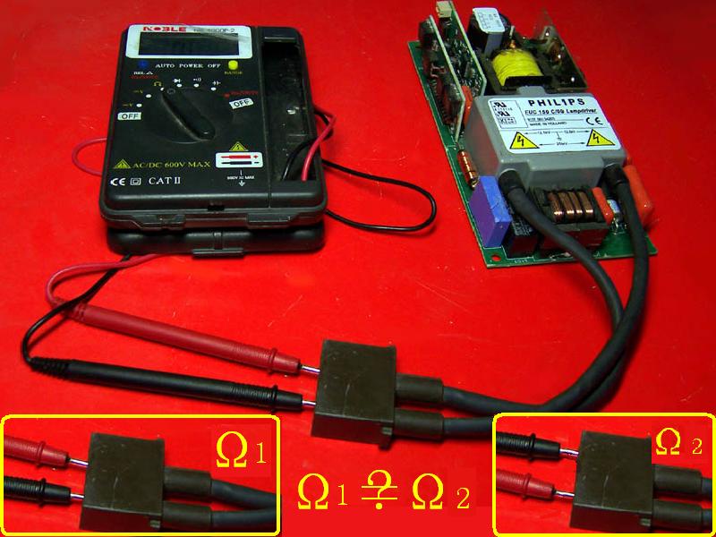

but, i haven't tried the multimeter thing... just what setting does it need to be on to test?

Hi again,
Most digital multimeters have 20, 200, 2000 volt ranges, and most projector bulbs run at around 65 to 85 volts, so you should start with the meter on 2000 DC at first, just to be on the ever-so-slightly-safer-side!
Then, you need to be sure that the projector won't try to re-ignite the bulb while the meter is connected, 'cos it will FRY the multimeter, and is obviously more dangerous. So, if you're confident that the bulb runs for a fair few seconds before going out, you should be able to touch the meter probes onto the bulb connections AFTER it has ignited.
If you feel like trying this, and get a reading on the meter, you might find that the minus sign "-" appears on the meter, which means that the polarity of the bulb connections are reversed to what the colours of the probes suggest (ie. red = negative / black = positive).
Hopefully, you should also get a voltage reading, which might be helpful. If you don't get a voltage reading when holding the probes on the bulb for a few seconds, or only get a quick "burst" of reading when the probes are first connected, then the ballast might even be AC. If this happens, just switch the meter to AC instead and try again.
It does look like the ballast is probably DC though (judging by your previous posts about the original lamp).
Just a quick tip: please remember NOT to plug the probes into the current (AMPs) holes on the meter then try to measure the bulb again, 'cos this will cause a complete short circuit, or blow the meter up. Current measurements must always be done in series!!
