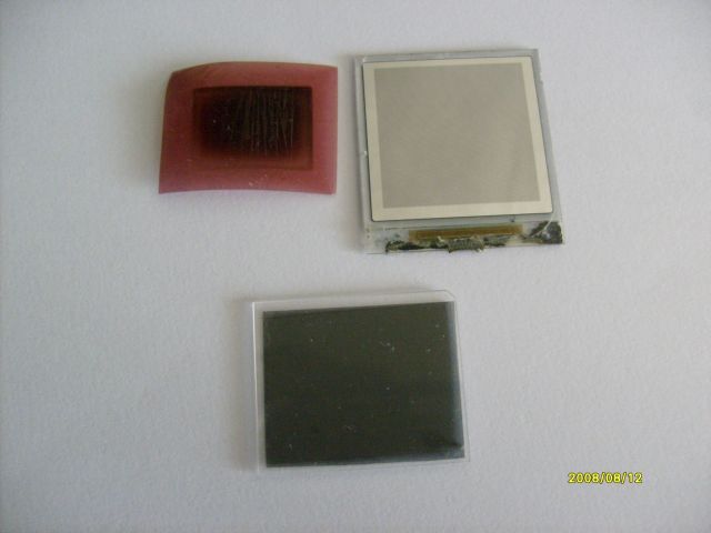

polariser
I need polariser to a 3 lcd projector (lp 280)
has bought a sheet,changed,and it has burned out shortly.I cannibalized now from a nokia cellphone's display,and it is perfect.
Still I'd appreciate a suggestion where to buy good quality polarizer otherwise I'v gotta kill a cellphone each time .

polariser
Hi YWH,
As you know, it is needed to change the blue polariser when the picture gets yellowish-greenish.
On the pic there's the old polariser (you can see the burned part on middle), the donor nokia display and the finished polarizer.Works 100 %.
The new should be applyed the same direction of course.

Hi !
your old polariser look like red, bu it is blue polariser .
nokia polariser is no color polariser. I have this color polariser.I can send to you.
please test color with some pictures
polariser
You mean you have polarisers for different colour channels?
I just have built in polarizers (changed all the 3) to an othe projector and it's OK.
Those were coloured all the same.
Hi !
no, I have NO polarisers for different colour channels, but only normal polarisers for color LCD.

Polarisers
Actually the reddish polarizer used to be the only "coloured" one .The other 2 were simply grey-blue.Now all are changed ( to be on the safe side) but normally it's enough to change the blue, since the blue filter passes too much UV cross and will burn earlier.
Nokia filter rulez 😉
