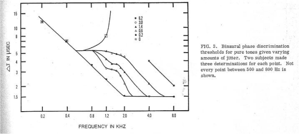

As posted before, the case of the impact of listener movement on localization issues has been studied before, the current state is that small movements of the listener improve the localization ability.
Nordmark (JASA, 1976, page 873, fig 3.) detailed how jittering the stimulus brought "lateralization"sensitivity thresholds DOWN from a min of 6 uSec to a base of 1.5 uSec discrimination in the frequency range of 2 to 8 Khz.(graph attached) This helps define the baseline human response capability a tad further....and this screams "single driver effects" and cone excursion..
Jakob2 said:
There is a lot of literature/papers available in this field and i think you´d be amazed to find out about all the things that are still not really known about our hearing ability.
I lament the lack of direct application of localization theory to the electronics' transfer function criteria.

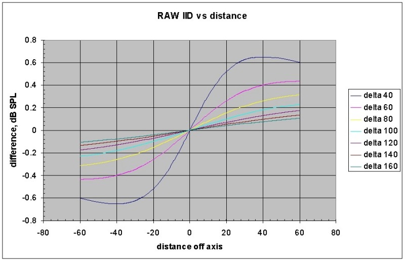

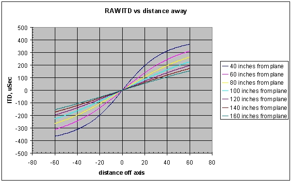

With those "massive changes", why is it I can still image something in the center where there is no driver.
Why can I image something that is off axis by 10 or 20 inches?? Do you have any idea how tight the system response has to be?
A point source 10 feet away, 20 inches off axis will have about 90 uSec ear to ear diff(ITD) and .08 dB IID. (graphs attached).
1. How the heck do we hear .08dB ear to ear difference??? The 90 uSec is easy enough to understand...but pan pots don't alter ITD..
2. How would we measure .08dB change in one channel with uncorrelated music running also?
The disparity lies within how we test and specify the equipment vs how we actually hear. We currently are far more sensitive to localization errors than the equipment.
Unless you or anybody else are aware of equipment which is capable of duplicating our ability to discern synthetic images in a soundfield..?.

ps. This graph is for a point source, with intensity falling off as 1/r^2. The numbers go down if a line source is used, and they go away essentially for planar sources near field. Is this not confusing???😕 😕
