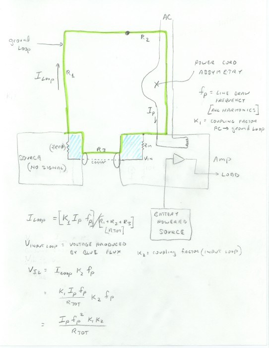

It is clear that an unbalanced set of currents in a shieled cable will both generate and receive stray magnetic fields - the physics is pretty simple, but my question is "what is the order of magnitude"? of what you are saying and has the audibility of this been tested? Years ago I found hum a problem, but these days I don't find it an issue at all. Virtually all of my signal paths are digital, so I guess thats part of the reason, but even on analog ICs the unbalanced currents in the audio frequency would have to be pretty small.
That depends.
First, not all audio gear has a line cord safety ground.
Second, in many cases, the equipment's signal reference ground is isolated from the line cord safety ground.
Third, in instances where it's not, the IC shield and the line cord safety ground are effectively in parallel, so the IC shield will share some of the return current.

First and second points...concur, especially for 20 hz.
Second...signal ground not connected to safety ground...me no like..specially on a diy site where double insulated is... just a word...
Third...yep, yep, yep. But the currents will depend on the path resistances. Safety ground resistances are in general much less, typically an order of magnitude.
But as frequency rises, the safety ground impedance decouples.
Cheers, John
Primary coupling of the immediate loop which shows as input IR drop is simply proportional to frequency. This is most of the hum in unbalanced as well as within pin 1 issues.
Secondary coupling of the loop currents occur within the chassis and are proportional to frequency squared. Fixing the pin 1 can still leave this, but typically 60 hz is buried by the balanced leaving buzz.
Primary is the largest, and most believe gone when hum is inaudible. Unfortunately, when the system draws power, any haversine coupling via line cord or romex to the input loop is confounded by the acoustic power. Listening is a mixed bag in that case. I would prefer measurement.
Secondary coupling I consider more nefarious and difficult to physically locate and remove.
Both are easily tested for. Bill Whitlock details methods of finding primary, but does not touch on secondary. He also considers only IR drop, but not magnetic coupling nor star ground issues.

However this would not be changed by swapping interconnect or speaker cables, right?
I am not speaking of speaker cables at this time.
IC's? Simple.
The return current to the preamp follows 3 paths. Two IC shields, and one power ground (for the example I started with).
The relative current levels are dependent on the path resistances and the path inductance.
Do all IC's have the same shield resistance and the exact same shield connection resistance, such that the currents distribute exactly the same as before and have the same break frequencies?
The same applies to the line cord safety ground, outlet, and IEC connector.
Earl..here's the test I developed back in 2004..it requires breaking the input to power stage connection, and reading what the input sees when the power stage is pushed. Things to watch for are chassis based loop currents compromising the measurements at the input section, supply based coupling doing the same.. Oh, and this depiction obviously ignores the sheild current's contribution to the integrated loop field, this is out of phase and therefore reduces the total induction. But this test looks for and isolates haversine currents caused by the supply draw, allowing direct measurement of the input problem without having to differentially subtract them from an audio signal.
Cheers, John
