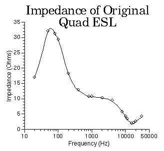

mwaters10 said:
There are some loudspeakers that have high impedance at high frequencies, ( like the original Quad ESL ) and maybe one or 2 other designs, and certain types of cable are not suitable.
Don't you mean low? Electrostats are effectively big caps.
