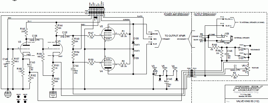

Back in the 70's and 80's I made guitar amps and did repairs. A friend brings in a Fender Bandmaster and it's got one 6L6GC and one EL34 in it. I asked WTF? and he replied that he and a friend who had a Marshall started messing around swapping tubes to arrive at a better (different) tone. He liked it that way and nothing was overheating, so I fixed whatever ailment it had and never saw it again.....but I had to try it myself.
I would wind up making a few guitar amps with "lopsided" power amps over the years. The 6L6GC / EL34 was the most popular, with the KT88 / EL34 right behind. I kinda liked the lower powered version with one 6L6GC, paired with two 6V6's in parallel. Nice bluesy tone turned down, good lead guitar scream when cranked.
I've heard of one simple mod on a large guitar amp, if it was six in PP, pull a tube from one side. That resulted in something the user liked.🙂
""lopsided" power amps"..."one 6L6GC and one EL34"..."if it was six in PP, pull a tube from one side"...
Isnt that net effect similar to simply and deliberately unbalancing the cathodyne / whatever phase splitter drive to the output tubes? I.e. the second harmonic no longer cancels in the OPT?
I think this has been investigated by others - to the point where a "sweetness" control design was offered (given the term "sweetness" can be typically associated with an increase in 2nd harmonic content...)

Miss-adjusting the balance of the cathodyne splitter (or other splitter) is "similar" to either using different tube types in the output stage, or "similar" to pulling one tube out of a quad, six-some, or octal push pull output set.
Those will both create some 2nd harmonic distortion.
Three things determine the amount of 2nd harmonic distortion thus produced:
1. The degree of the AC un-balance in the cathodyne splitter (or other splitter).
2. The degree of the AC un-balance in the output stage.
3. The amount of negative feedback that is applied that includes the un-balanced stage (splitter stage or output stage) in that feedback loop (more negative feedback, less 2nd harmonic distortion).
Remember, negative feedback can "cover a multitude of sins".
"Similar" is one thing.
But as to the output stage, whatever you do that un-balances the DC currents in the output transformer causes a completely more complex effect.
"All un-balanced circuits are equal, but some un-balanced circuits are more equal than others" - I stole that from George Orwells "Animal Farm", and I modified it so that it would be more "distorted".

Simply unbalancing the AC outputs from the phase splitter produces the mildest effect.
Misadjusting the bias to cause unequal DC currents on either side of the OPT will produce a different effect, and may induce OPT saturation on low frequency sounds. Saturation is generally not a good sounding distortion, but some bass guitar players like it. It does tend to drive the tube current up, possibly leading to dead parts.
Dissimilar output tubes can cause a different more complex effect. It the tubes have unequal Gm, but are adjusted to identical idle currents the effect is mild at low output levels, but more extreme as the volume is increased.
I have found all sorts of ways to alter the tonal palette of a vacuum tube guitar amp for unique sounds. Want to try something really crazy, try sticking a tone stack INSIDE a negative feedback loop. WARNING, this WILL lead to instability, often LOUD instability.....but some extreme sounding guitar sounds can be found right on the edge of instability.

FWIW in the Musical Instrument world things can be pushd well beyond the border, in search for a new sound.
In particular Peavey introduced a "Texture" control, which they falsely claim to "smoothly go all the way from Class A to Class AB sound"
Truckload of Marketing cow manure , but what it´s actually made of is a "volume/Master" control affecting *one* of the PP sides, allowing it to be turned down almost to zero.
Since the other half bias is NOT adjusted to simultaneously send it into Class A territory, the promise is unfulfilled.
On the other side, you end up with MASSIVE asymmetry (unless you are playing around 1W , that is, in the *already* Class A section of Class AB) .
This is Peavey Valveking 50W, notice Cathodyne PI plate signal goes straight to V5 ; while its cathode one goes to V4 grid through an external volume control labelled "Texture".
It is not allowed to go down to 0, which will probably sound ugly choppy, but 1M Log pot goes to ground through an 82k resistor, so attenuation stops above some 20dB.
Drastic enough anyway.
DC through OT is not directly affected, although the very asymmetrical signal will generate a DC component.
But different to fixed uncompensated core saturation caused by tricks mentioned above, this one will be dynamic, following signal level, so effect will be more complex.
