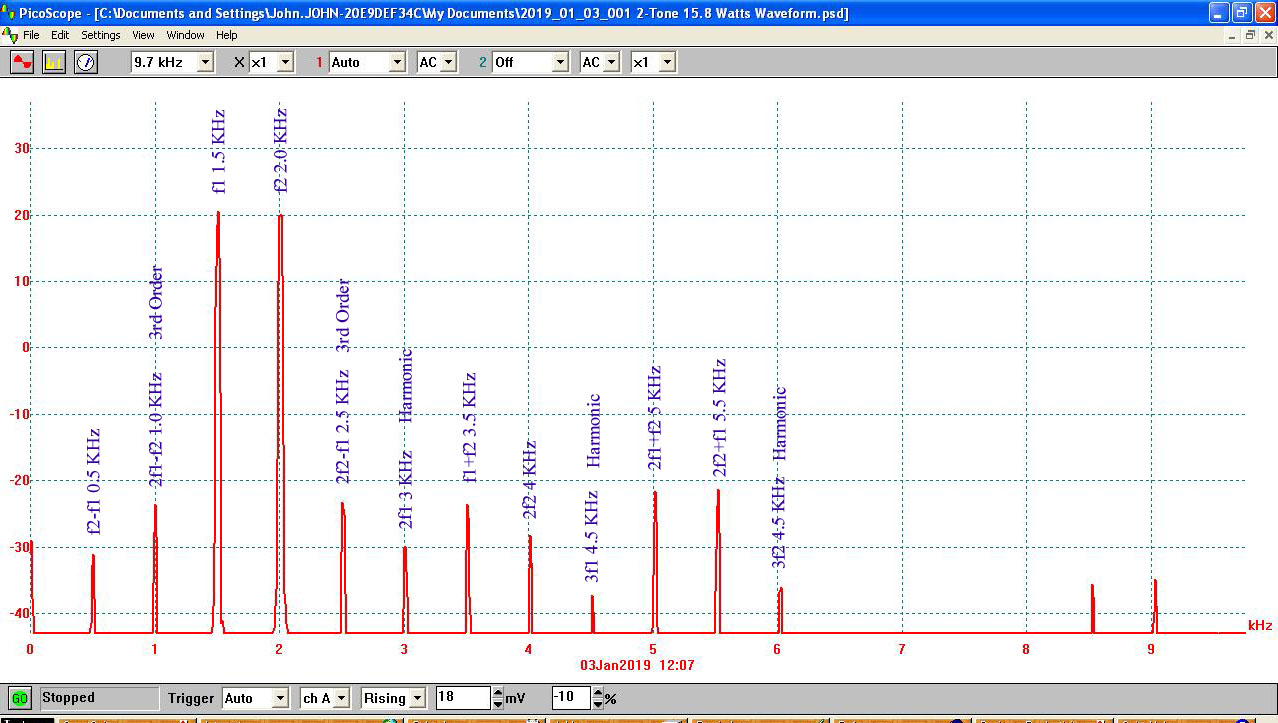

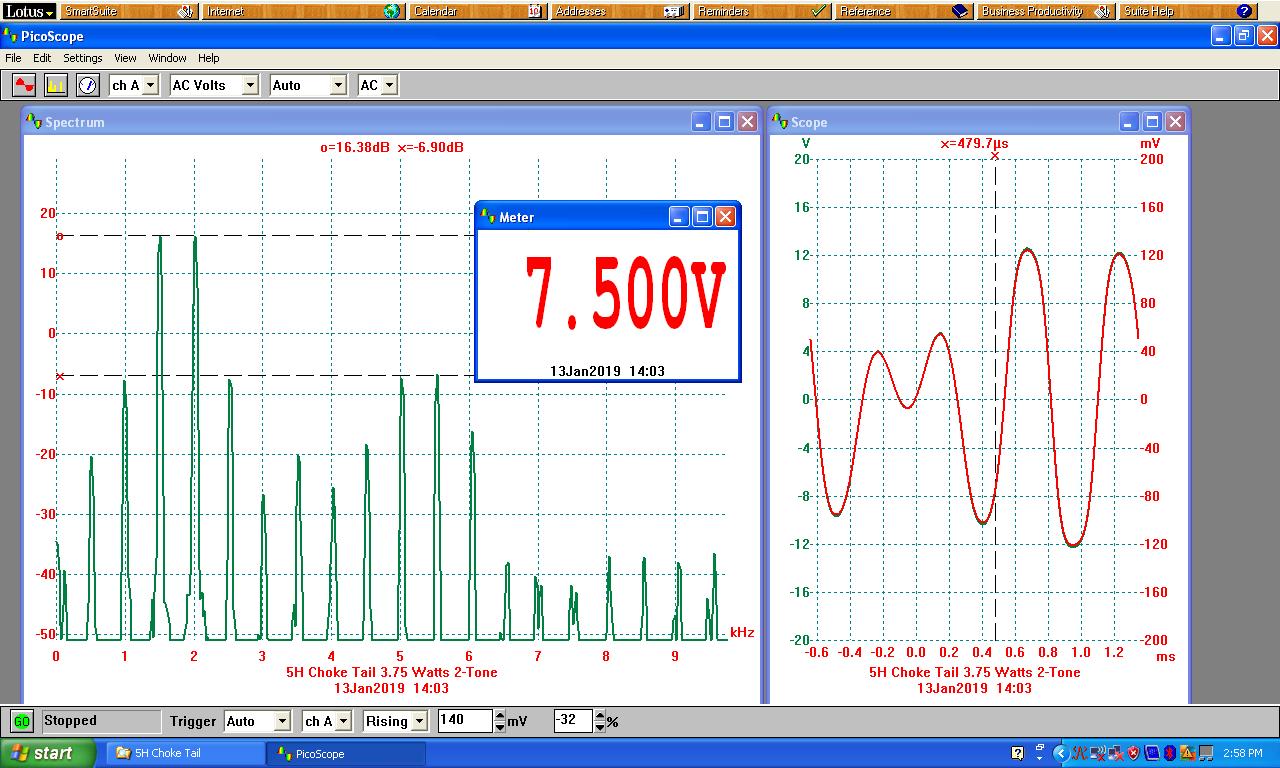

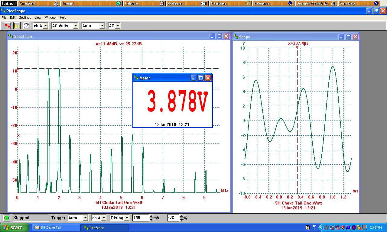

Some 2-Tone Examples Using 3,4 Method
These IMD tests were done on the Self Inverting PP 6V6 Test Mule using the 3,4 Frequency Test Method proposed by Graeme Cohen. His paper included here. The IMD products increase quickly as the power level is increased. Percentages to the 3-order products are 1.45% at One Watt, 6.85% at 3.75 Watts & 11.72% at 5 watts. Test frequencies are 1.5 KHz & 2 KHz.🙂

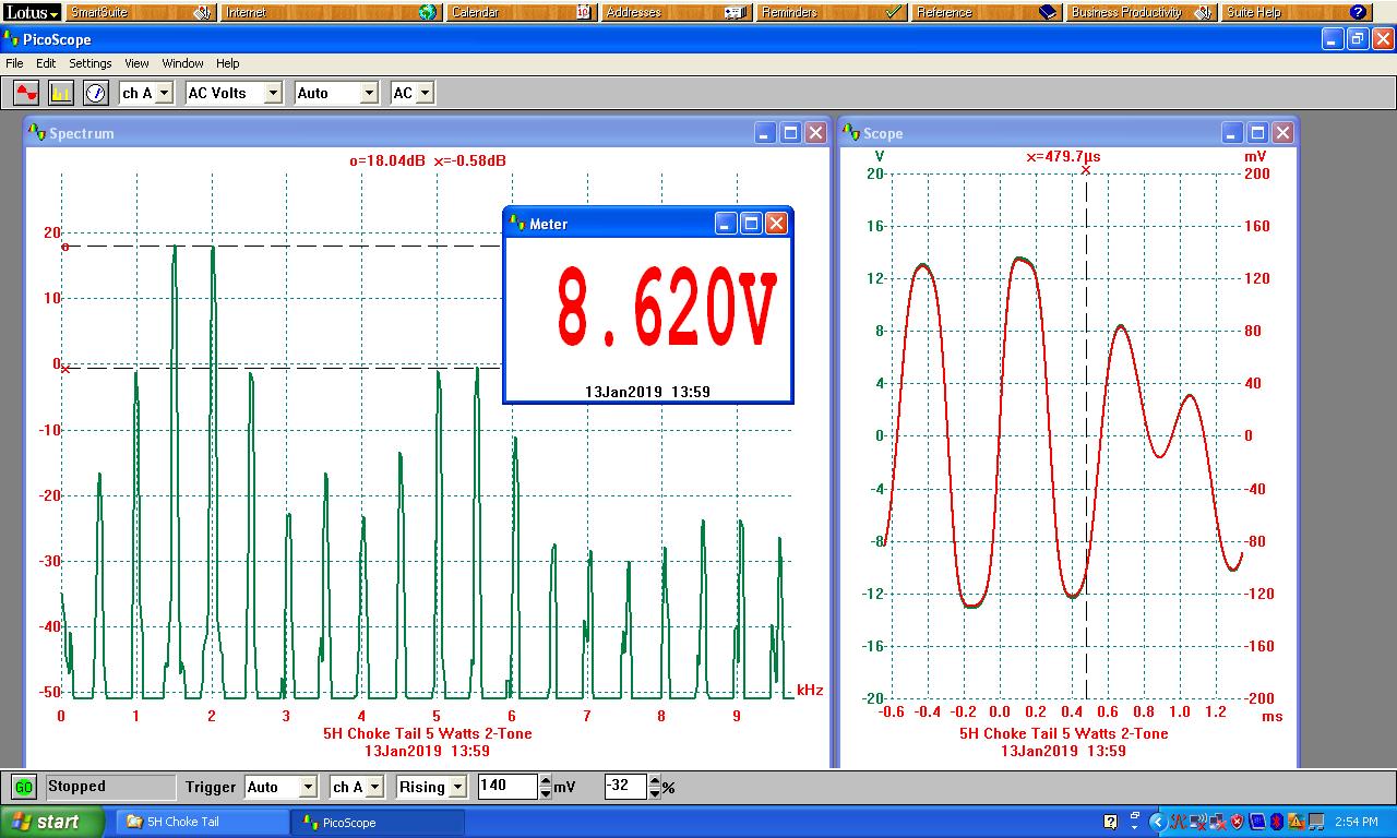

jhstewart9,
Thanks for the plots.
It shows me that I need to check not just the IM; but also the 2nd harmonics of the two original tones and the IM products that are on them.
One problem to test that, is the only clean two tones for 3rd order tests I have are at 11kHz and 12kHz.
That puts the 2nd harmonics up at 22kHz and 24kHz By that time, most of my amplifiers are already down at -1dB.
That is OK for my ears and speakers, but it does skew the test results.
And of course, I can also see the 1kHz 2nd order IM that is created too.

Tubelab_com, are you reading this?
Is this a valid test of an amplifier IM distortion?

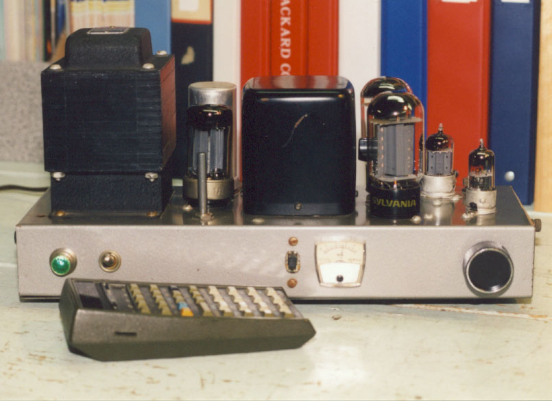

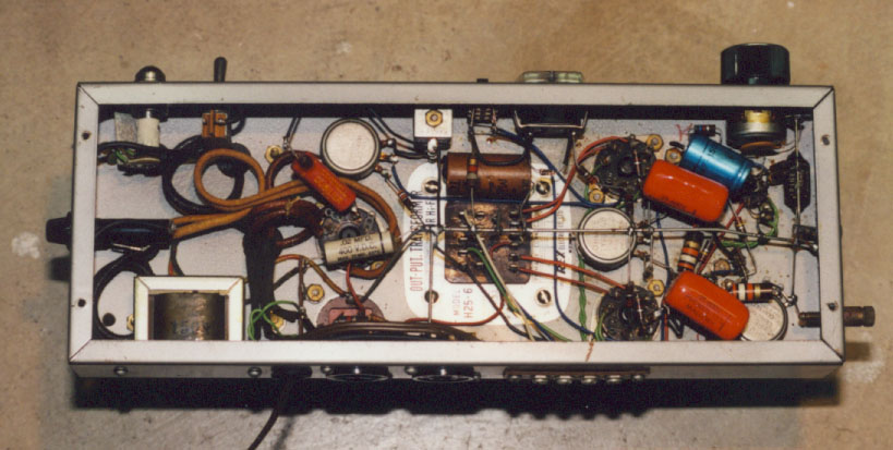

This amp & another identical were built circa 1960 & used until 1977. Still on the shelf, the coupling caps replaced a few years ago. So this test was done in 2019, still looks good. All the IMD products are down more than 40 db ,<1% dist. 15.8 watts measured by a MetraWatt 29S Precision DVM & Wattmeter..🙂

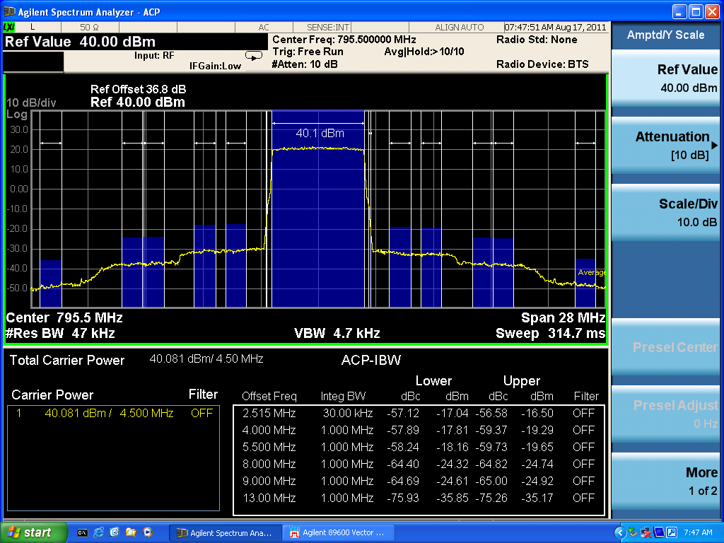

For those measurements required in digital modulation systems the Aeroflex 3920 does many & others by the Boonton 4500. Motorola, Kenwood & what was the Early Warning System used them locally. I got to drive a lot of these as I worked for the local rep. Check also Boonton App Note 50, a good description of digital modulation & measurements.
Attached my App note on testing SSB for Coast Guard & Airforce, they were using the IFR/Aeroflex 2975.
