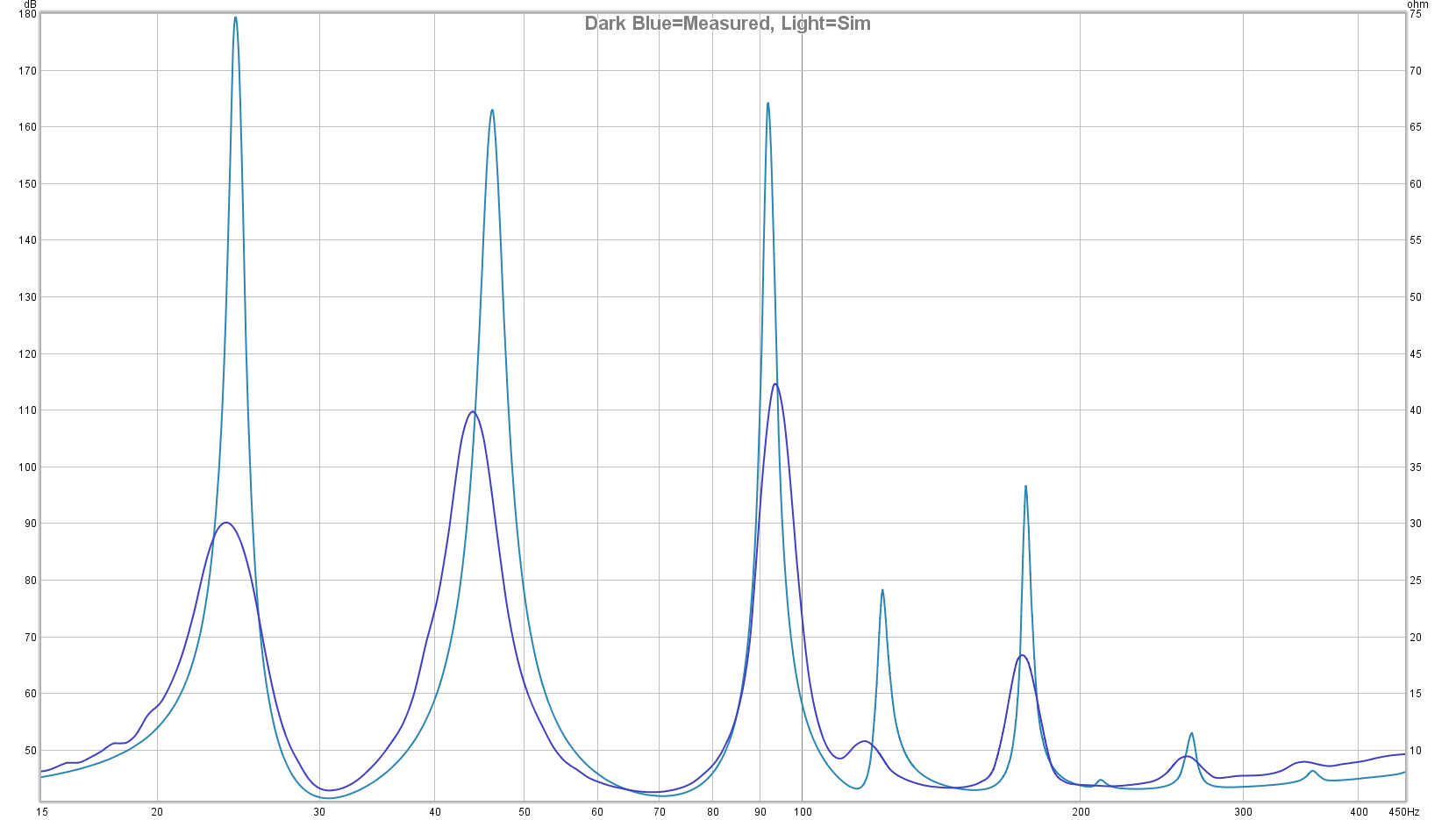

It's easier to compare the impedance curves if you export them from Hornresp (for the sim) and DATS (as measured), then import them into REW for comparison purposes.
Having said that, don't worry too much about the level of the peaks. The Hornresp simulation doesn't take box losses into account, and the more the actual box losses, the lower the peaks will be compared to the sim. What I do sometimes is add a tiny bit of theoretical fill to the Hornresp sim to roughly simulate box losses. This brings down the level of the impedance peaks, and brings them closer in line with what's measured. I suspect that the sim'd FR would be closer to measured FR as well.
When doing impedance measurements, check to see if the dips are where they are supposed to be (the minimum points in the dips should be a good match for the minimum impedance points in the sim) and that there are no additional peaks in the impedance, or that the peaks aren't degraded, which would suggest that panel resonances are impacting the performance of the speaker.

Pink is simulated (no filling added), blue is measured:
That's pretty decent correlation. Looks like the resonance frequency might be slightly higher than Hornresp predicted (all of the peaks seem to be shifted upwards in frequency a little), and the peak just above 100 Hz is a bit degraded, a possible sign of some panel flex, but it looks pretty decent.
As you have an impedance meter, try doing the sim again using the semi-inductance method (check the Hornresp thread for more details). You might find even better correlation between sim'd and measured performance (both FR and impedance).
I have DATS, can you extrapolate semi-inductance from that? GM, my inputs are post #4 and #13. Here is my record that contains my measured FP 12RS550.
You can use DATS to save the impedance curve for the driver as a ZMA file. Use the semi-inductance spreadsheet provided in the Hornresp thread and that ZMA file to generate the additional semi-inductance parameters.
Double click on the 'Le' and it should turn red. Your sim will look quite different 🙁.
