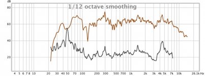

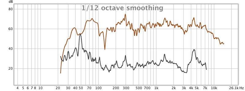

I built Cowan's 30Hz Tapped horn

Still looking forward to your near-field distortion plot. Nice to see measurements well below the max of the speaker so they represent more realistic listening conditions. No need for an SPL meter unless you are in a car-audio competition.

Thank you Brian for doing the spreadsheet work to figure out the Semi-Inductance specs of these drivers. Measured mouth area is 945 square CM. Here are simulations vs overlays with my Faital Pro 12RS550 and my B&C 12PLB100. Faital Pro:
Group delay:
B&C 12PLB100 and doppler shift (probably from a plane) around 68-73Hz:
Here are the advanced thiele-small parameters for my two drivers if anybody wants to use them:
One thing I should mention to anyone wanting to build this: Route out the corners on the inside of the mouth because I notice a high frequency sound from turbulence. I would in fact refold the entire horn using Brian's Boxplan-SS w/ optimization to have a larger mouth (or at least get rid of that immediate 90 degree turn) because chuffing is the problem with this horn.
