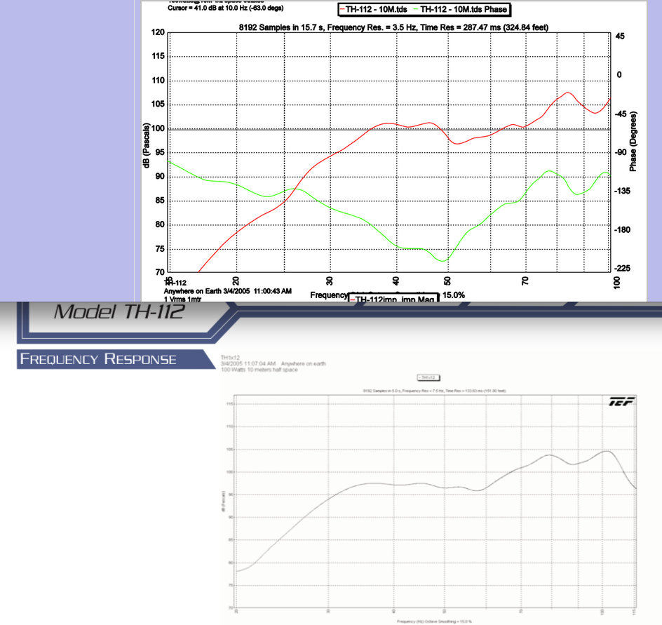

I finished this cabinet, I got a Faital Pro 12RS550 and it sounds amazing with tons of output. Here are 1 meter ground plane measurements I took with my professionally calibrated EMM-6. Blue line is 1 cycle group delay which is lower than the threshold of audibility.
Group delay
FR and Phase. I don't have an SPL meter so the SPL is uncalibrated, but this was a 8.7v 1M long sweep.
The driver is rated to 500 AES watts and it will take about 1200 to reach maximum output:
The cabinet is currently coated in about 3/16" of truck bed liner, has a routed recess and t-nuts around the mouth for the grill, and all the edges have a roundover on them. There's a handle on the top and bottom. It is 37 liters smaller than the TH112 (it's 10.6 cubic feet or 301 liters, TH112 is 338.5) and about 10dB louder at 31hz.
TH112 Frequency response and phase:
Group delay
StainlessSteve,FR and Phase. I don't have an SPL meter so the SPL is uncalibrated, but this was a 8.7v 1M long sweep.
Your sub's response looks amazingly smooth for being "unsmoothed"!
Your sim would indicate around 94 dB sensitivity at 30 Hz, with no SPL meter and no calibration, why do you figure around 104 dB sensitivity for your sub at 31 Hz?
I thought you might like to see the more "smoothed" version of the TH-112, downloaded 3/9/05, the measurement date for both the one you posted and the smoother version is 3/4/05.
Art
So by "about 10dB louder at 31Hz" do you mean 10 dB more "maximum output"?I don't figure 104dB sensitivity. I'm talking about maximum output.
The Faital Pro 12RS550 has 9.25MM Xmax, the TH-112 probably uses a driver with around 13mm Xmax, don't understand why you figure your smaller cabinet would have more "maximum output".
Because I've seen how Danley measures their maximum SPL. They quote from the peaks in the FR, you can see it on Data-bass's measurement of the DTS-10 where the only place reaching 133dB is above 63hz, they don't quote from the 0dB point. My driver might have an xmax of 9.25mm, but it has an xmech of 20 and a larger SD.

The measurement was a 1 meter groundplane, 1M sweep length, 7 volts at 30hz and 73f with ~38 percent humidity one thing I would never use is smoothing. The nearest object was behind it and 88 feet away, and the next nearest object was to the side of it and 376 feet away. The was a Crown XLS 1500, the soundcard was a TASCAM US-1641, the mic is an EMM-6 independently calibrated by Cross-Spectrum Labs. I wish I had an SPL meter and a better mic, then I would post distortion measurements and have SPL data.
Here is the impedance curve of the enclosure:
Do you guys think there might be leaks? Everything seems to line up within a few hz but the levels are weird.
