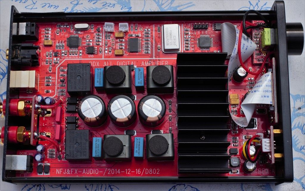

My D802 also has a bit of noise but not really noticeable unless there is very very quiet passage. However I did some mod to lower the noise floor (now I have to get close to my 85db efficient speaker to hear it )
I believe the problem is the power supply for the digital section, both the 3.3v of the st326 and the digital input/processor which uses a lm2956 buck converter to step down to around 11v and then to 2 x lm317 for the 3.3v used in the st326 and other ic (ak4113, usb ic, and processor).
D802 made it worse by splitting the digital supply off very close to the st326 supply (in fact from the closest power cap), imagine all the noise from the st326 switching injecting into the digital section. From the underside of board I cut off the digital section power trace and directly solder a wire from power input to the cut off point with a 10R resistor in series and add few 10uf/50v smd decoupling. The result is a quieter amp and reduce digital glare in some less well recorded music.

You have any pics?

As I read it, the "hiss" described by Launagis is not as serious as the problems of hiss/auto-muting/low-gain described by Solve.
OK, this isolates the problem to the amplifier. Either there's a really bad setting in the menu, otherwise I think your unit is faulty.Same hiss in all inputs also same with an external cd player.
Yes It maybe a faulty amp.
Read at Amazone one had similar problem.
Bad firmware?
