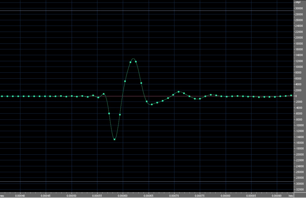

IT IS A FACT that the steeper the filters, the more ringing is added to the original signal.
Look at the picture Hans, that's the pre-ringing you get from a real acoustic signal and a microphone (fairly good,+1, -3dB @ 500~20k). I stop reading when the examples shown violate Nyquist and the point is about real music. Where is the MILLI-second "time smear"?

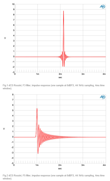

Hi Scott,
In the MQA article a 2.5 millisecond time smear is displayed for CD and 0.5msec for 96Khz sampling rate. Those figures are dropping from the sky because this depends largely on the filters used.
Two examples showing time smear for reproducing an impulse are shown below for a typical D/A at 44.1Khz for a Fir filter and for an Apodizing filter. The first being smeared over 0.6 msec and the second over 2.6msec.
This already shows that time smear is very dependant on the type of filter being used.
Your sampling rate was 96Khz, but sampling does not cause time smear, filtering does. So how did you produce this figure.
Was any filtering at all involved in this process.
And when using a more relaxed 48Khz filter, this would almost produce no ripple, making time smear completely invisible in your graph for the ca 10Khz signal, confirming your measurement.
But I agree in general, there is a lot of bla, bla in the article.
