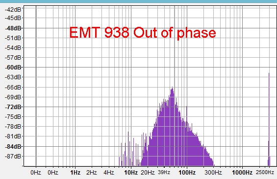

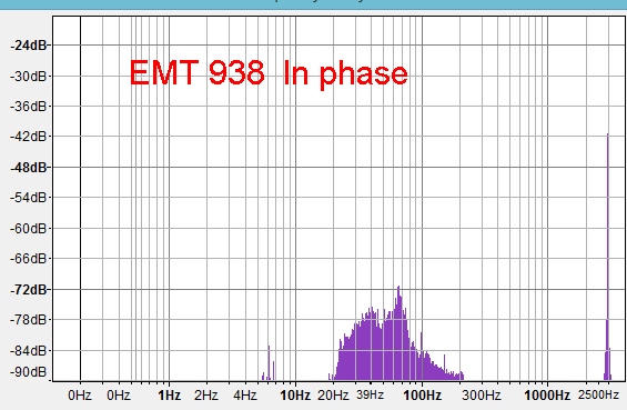

Here's a swift and rough spectrum analysis of in-phase versus out-of-phase rumble.
The recording is of a 3kHz test tone from a test disc. TT is EMT 938, well respected broadcast TT.
Using Audacity, stereo track folded to mono, resampled at 8kHz (slowest avail), and 1min30s sample analysed with 64k FFT.
Result posted below shows that there is low level low frequency audioband out-of-phase content, exceeding that of in-phase noise. There are also spectral artefacts which are unique to out-of-phase content.
Appols the vertical scale of these graphs is not the same due to autoscale of Audacity, so read carefully!

Not much of that will be associated with the main cart compliance/arm mass resonance, except for the stuff down below 20Hz or so. Though there are excellent pitch stability and trackability reasons to control that resonance via damping, it can't explain the rumble spectrum in those plots which is squarely in the lf audioband, a good few octaves above the cart/arm resonance.Interesting. Assuming no warp wow effects how much of the out of phase is resonances of arm and cartridge? And can they be effectively damped mechanically?
The miracle of the main c 10Hz cart/arm resonance is that for stylus motion below the resonant frequency the headshell follows stylus motion in-phase. Above the resonant frequency, headshell pretty much stays still so cartridge transcribes stylus motion which is then always out-of-phase wrt headshell motion. This is why the whole system works, and it's so simple, just a physics property of mechanical resonant systems. The penalty is that at the resonant frequency there is poor stability, which is generally tolerable but open to improvement.
Most of the out-of-phase spectral content in those plots is audioband lf, not associated with the cart/arm resonance though. That audioband content seems far more likely to convey pseudo-ambience, if any such effect is real.
Or, put another way, it spans the spectral range at the bottom end of what most domestic replay systems will reproduce ..........I'm coming round to thinking there might be something in Douglas' OP hypothesis about pseudo-ambience!Ah yes missed that. It's centered at 55Hz, worryingly close to the hum region...
