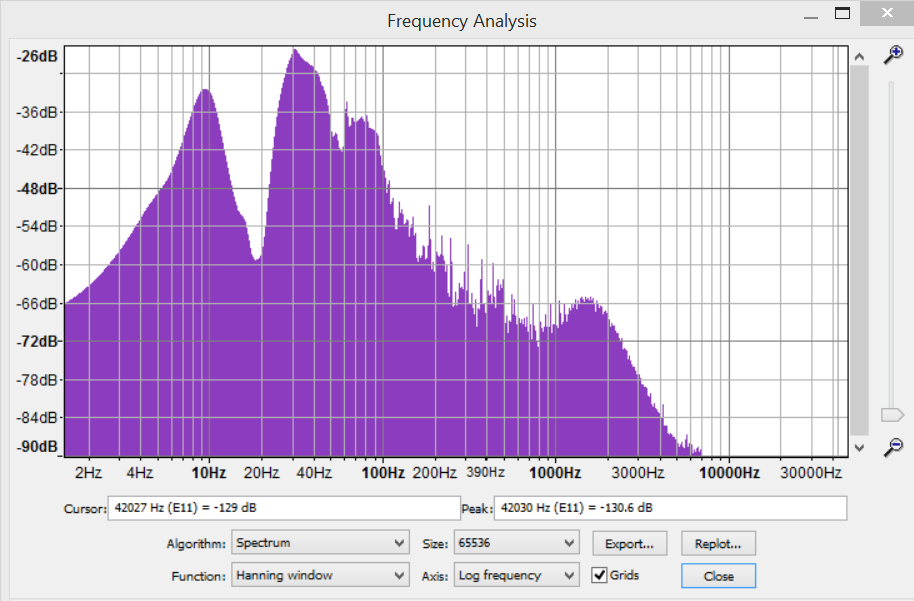

What does the spectrum look like?
Looks a lot like this. Below is NOT my TT, but the 10Hz spike is similar. This is "Speak to Me" from Dark Side of the Moon. If it were a blank groove the 10Hz would be the highest peak, by far.
I found this rip has out of phase signal < 200Hz that is 10dB under the in-phase. So far, I haven't done a good job removing it from the original. :xeye:

From that, it looks like the crossfeed needs to start at 100 Hz or even higher, not say at 20 Hz.

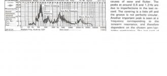

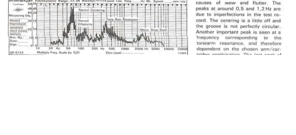

I am currently reading the very interesting B&K document that George linked to in post #401, and I've got a feeling that it will reach the same conclusion

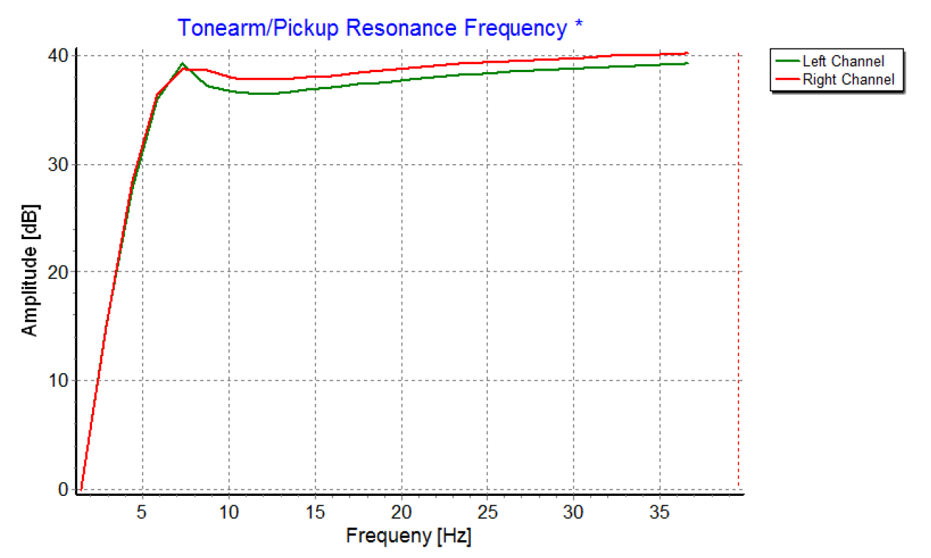

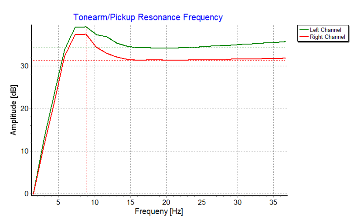

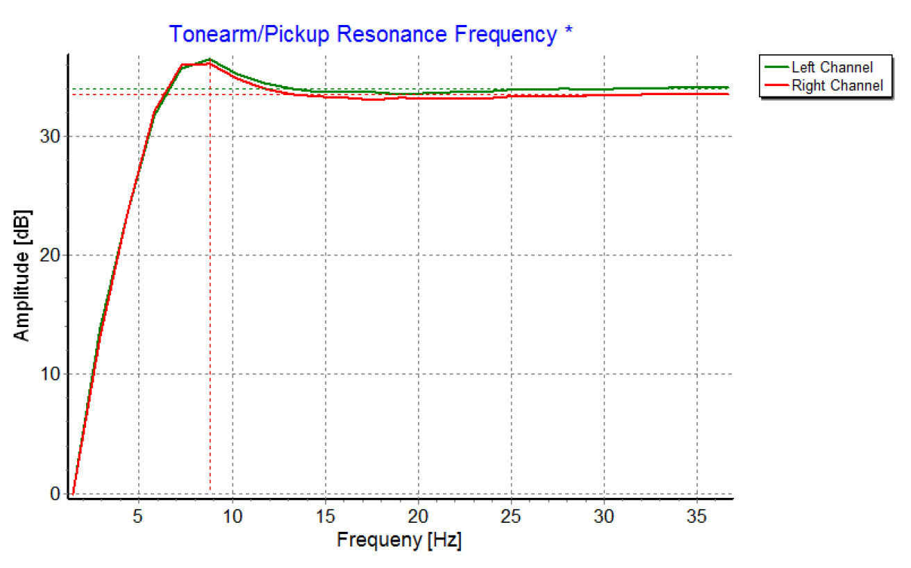

That B+K paper got me to dig out the resonance measurements I've done last year for a potential article (which is still very much in Status Nascenti)...
These measurements have been done with a test record through a phono pre into a sound card, and Feickert software. Note that these are cartridge/tonearm resonances - you also have tone arm resonances as such which however can be anywhere from a few 100 Hz to a few kHz or over a rather broad band.
Hope this is of some interest.
Jan
