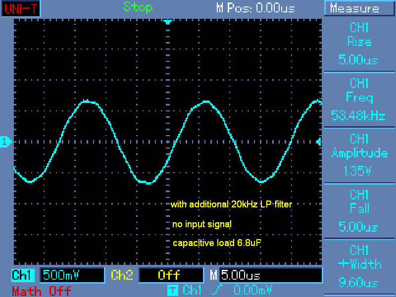

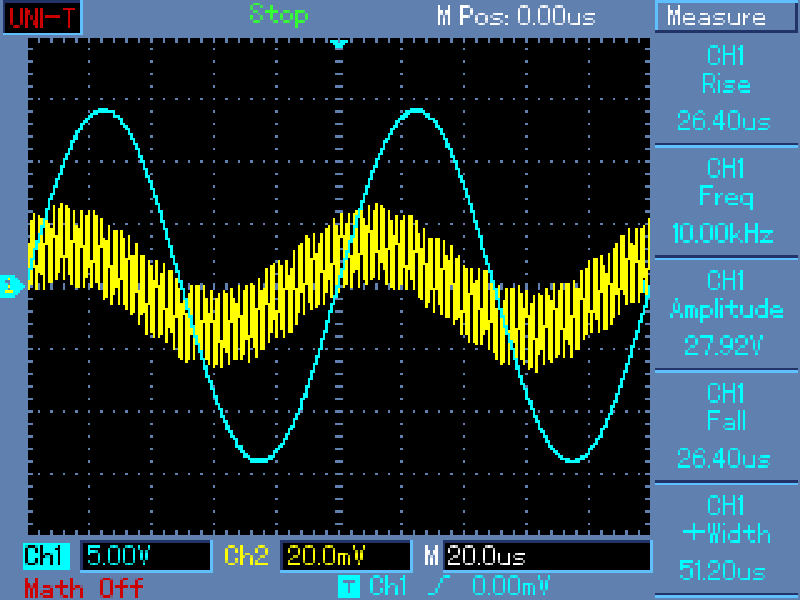

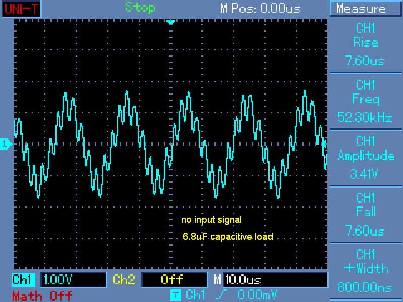

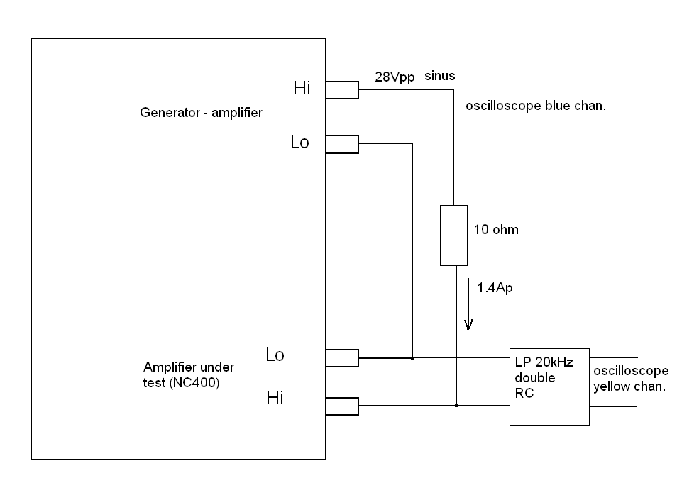

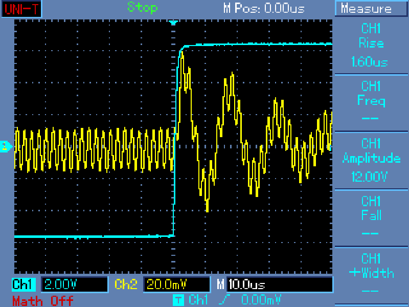

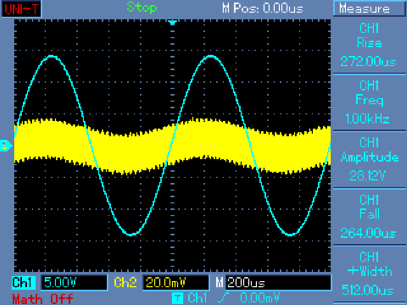

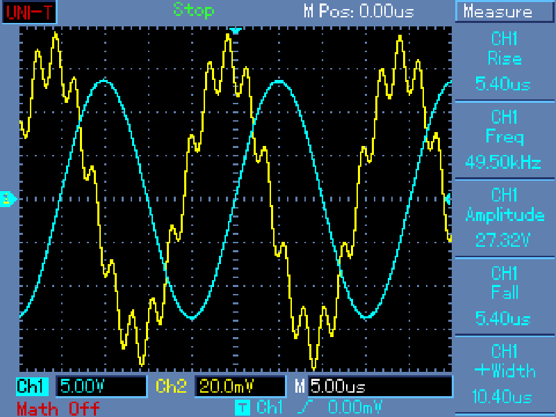

I have made some measurements of Hypex nc400 output impedance by a current injection method. LP 20kHz (2 x RC) had to be used to suppress 450kHz carrier frequency. You will see description of the method in one of the attached images, plus measurements at 1kHz and 10kHz.
