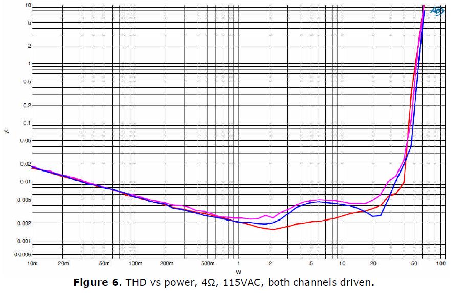

Ncore might have a contender in town very soon. Anaview is releasing some new class D modules. First one is only with 25w in 8 ohm (50W in 4 ohm) but more powerful amps will come later. PSU is on board.
Someone said measurements are said to be better then Ncore. Anaview uses something called AMS-servo, so in other words not much use of feedback.
I've personaly only seen Gain and phase vs frequency and THD vs power measurements.
Here's one preliminary of many:
