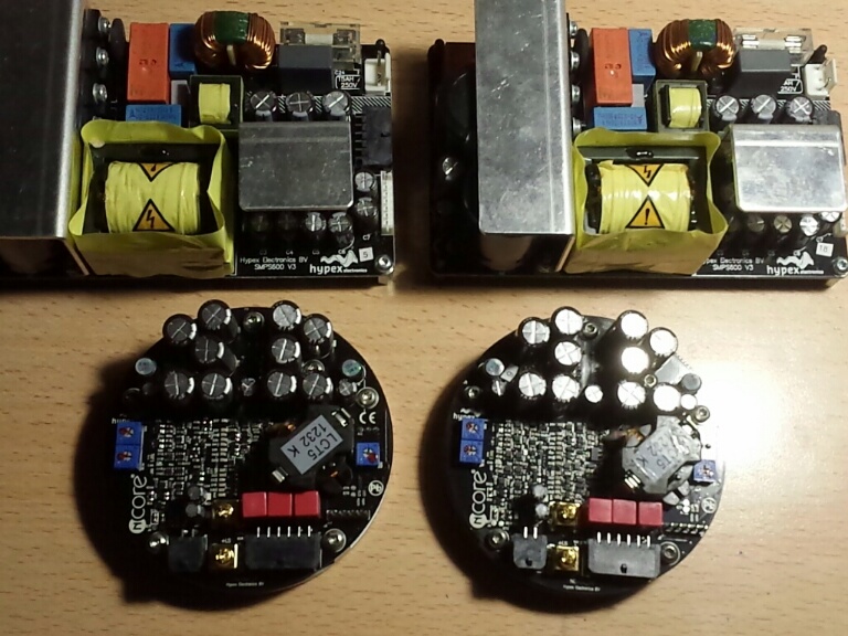

so wanted to know...is it possible to join 3 ncore and get 1200W on 4 ohm...i have pair of 3 ncore each pics here..
FS: Pair of 3Ncore each
can they be joined to give 1200W output power....or two either for 800w...
thought i ask....need for some maggie 1.7...heard more the power more they sing....

The nc400 is specified to work OK down to 1 ohm.
Are you sure you need 1200W, 400W is a lot. It will give you 112 dB @ 1 m with 86 dB efficient speakers. If that's not enough I'd recommend you to turn down the volume 😉
James Romeyn sells bridged monoblock NC400s: “Bridged mono bloc powered by SMPS1200A400, 1200W @ 2 Ohm”.
