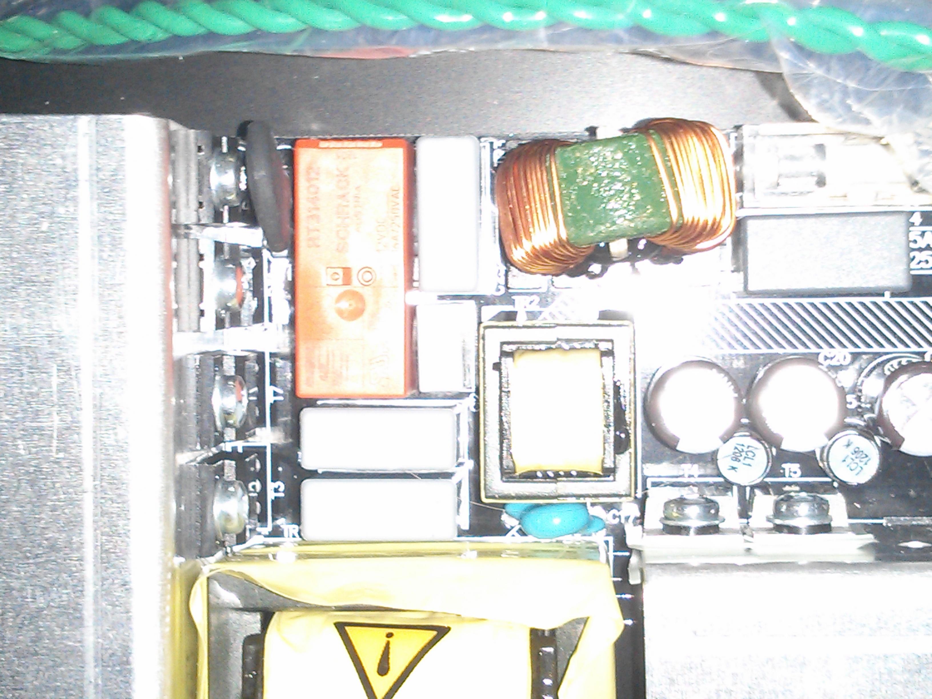

Nice to see versions. Can you post a pic of the SMPS?
I got my amps and supplies in may and the revisions were 3 and 2 respectively.I just purchased a third amp/power supply and notice they are version 3 and four respectively.
So it seems the SMPS has evolved quite a bit whereas the nc400 was unchanged for the last 6 months.

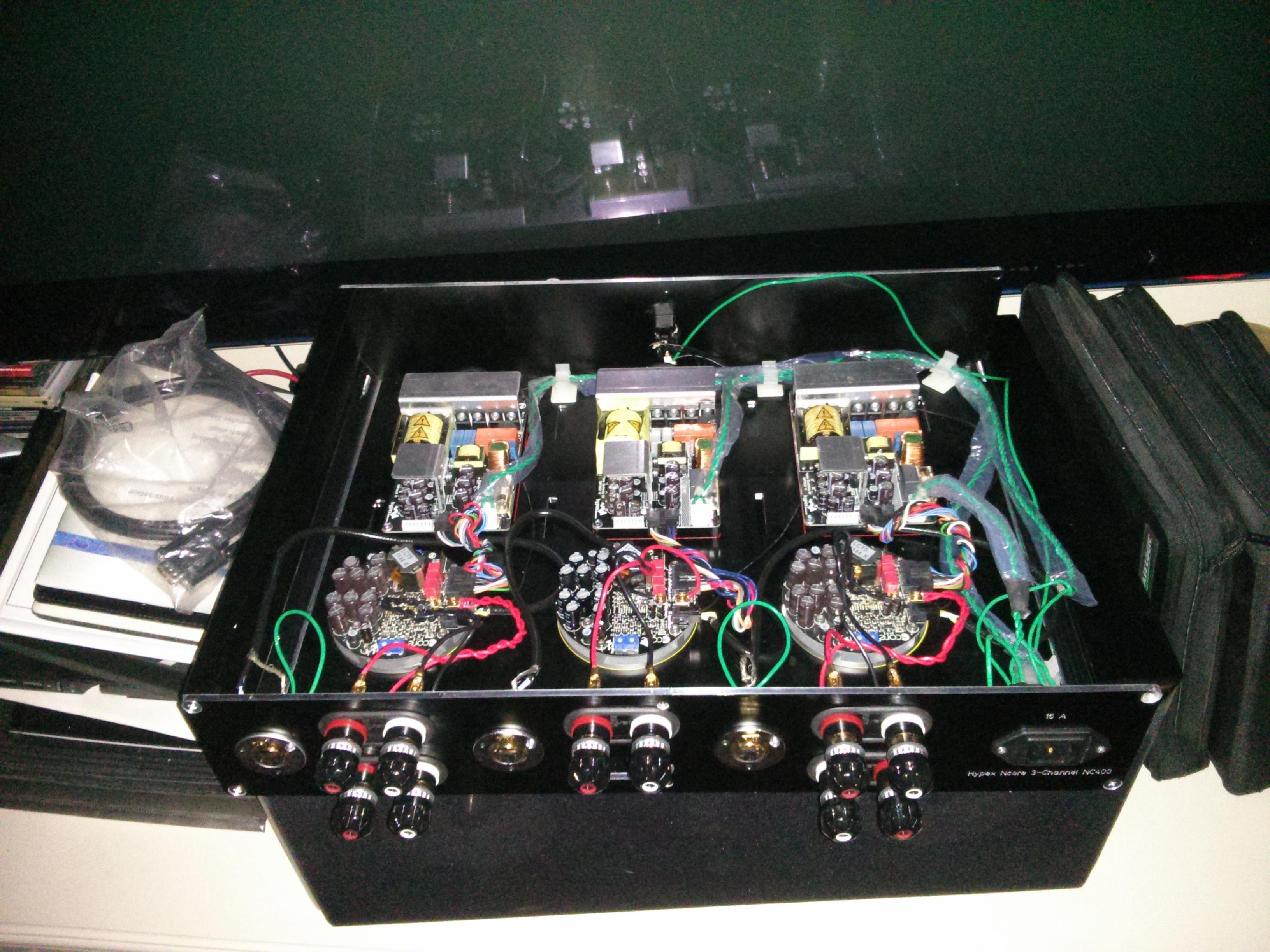

Please see the attached photos. I know they are terrible photos, but you can see the first one is version 1. Close to the center, you can read on the board "C23". Then, on the second is version three. You can see there is an extra "box" on the board, where it used to say, C23. I can also tell you that when you power them up, the new one takes about a second longer to click on. No idea on heat or sound, yet...
The third photo is me showing off. That is my three channel amp. any suggestions?
SMPS standby setup help
I have a three channel Ncore amp and I just leave the unit on all the time. However, the heat buildup is too great, almost too hot to touch. I want to setup the SMPS to go into standby. I know I use pin 1 on J1 connector of the SMPS and need build/buy a trigger circuit that applies a constant voltage, to keep it in standby mode? I also understand that once the SMPS is in standby, it will send the amp portion into standby, within 15 min? My question is, how do I go about setting up this circuit. Any help would be great. I have never build something like this.

Well glad too hear I am not alone. There is just no way that you can leave these on, with three in one case. Its just too hot. The case is all aluminum, vented on the top and bottom, but it just does not matter.
I realize after reading this tread over again, that I can use a 12v trigger. My processor has a 12vdc trigger. Is there any reason that this won't work? Its a programmable trigger. If not, could you help me with this? Spent an hour on Digikey, and couldn't find it.
