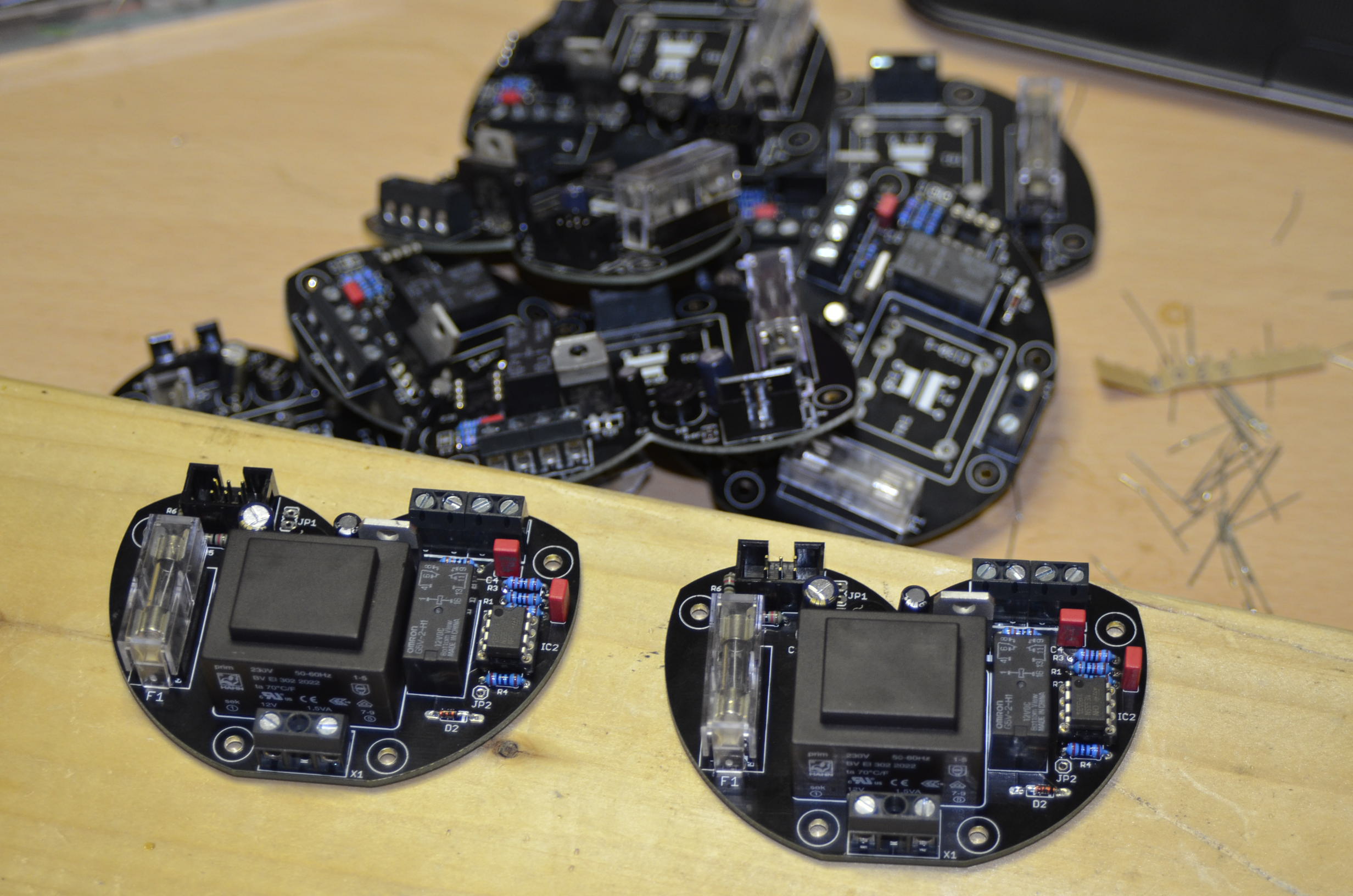

my ncore (only 2 channel) never got anywhere near warm, lukewarm at most.I have a three channel Ncore amp and I just leave the unit on all the time. However, the heat buildup is too great, almost too hot to touch. I want to setup the SMPS to go into standby. I know I use pin 1 on J1 connector of the SMPS and need build/buy a trigger circuit that applies a constant voltage, to keep it in standby mode? I also understand that once the SMPS is in standby, it will send the amp portion into standby, within 15 min? My question is, how do I go about setting up this circuit. Any help would be great. I have never build something like this.
I know ds23man has made a hypex standby print which will supply the 9V to the SMPS standby pins, and has a relay to switch the ampon at the same time. he set it up that it will work with both pushbutton or a switch

I get that you have a device that reduces a 120VAC current to a 9VDC. This connects to the IEC and then to pin one on J1, via the power button. I am just not sure what I am looking for on Digikey, despite a couple hours of searching. Any help would be great.
The small DC supply robbbby linked to should do it, possibly coupled to a small relay if your power switch isn't AC level.
Is there a post where he shows how he did it? i'm a bit curious. Where did he get the 9V from?
don't kn he also posted it here, but on the Dutch DIY forum there is a thread: forum.zelfbouwaudio.nl • Toon onderwerp - Hypex standby stuurprint and a groupbuy forum.zelfbouwaudio.nl • InloggenIs there a post where he shows how he did it? i'm a bit curious. Where did he get the 9V from?
on the print there is a small trafo

Tadaaa:
oh wow, all done in a nice pcb. i'd definitely be interested in purchasing 2 of those rather than using my hack together method. Is he a poster here?
ds23man is the guy who made these. 😀
