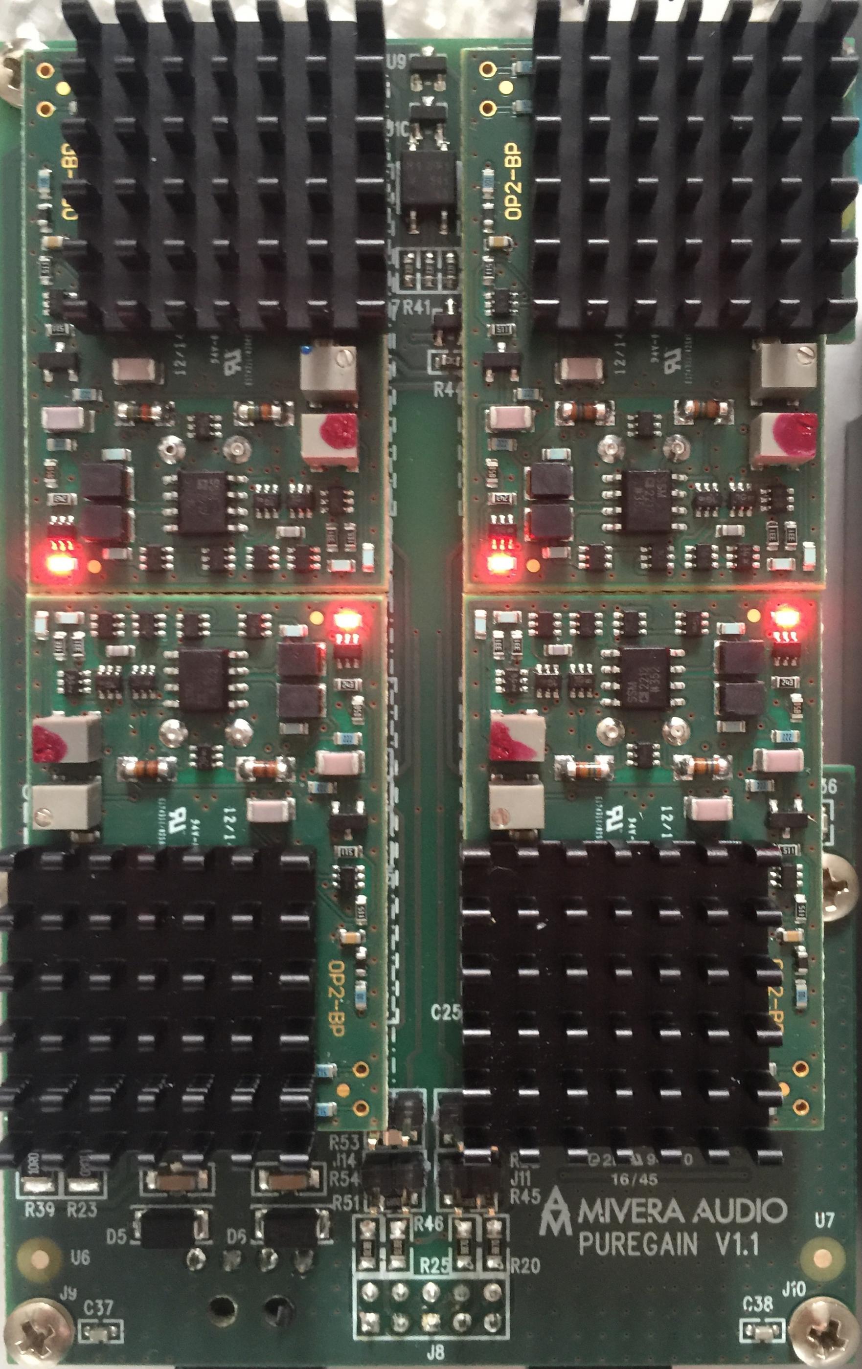

Sounds like "hidden" advertising of your company.I wonder how this would sound...
I thought it was rather open. 🙂 It's our DIY version of Pure class A gainstage.
Interesting !!!
Will you present it ?
Yes it's available now in our Purestream DAC. And shortly in our Purepower integrated amp. Compatible with any 990/2520 standard opamp. Including this DIY kit:
DOA-17 Discrete OpAmp, DIY OpAmp Kit for Microphone Preamp Upgrades - FiveFish Audio

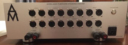

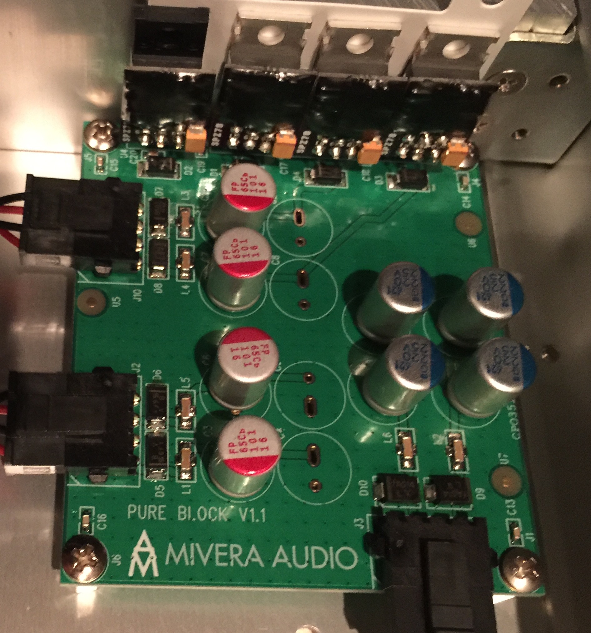

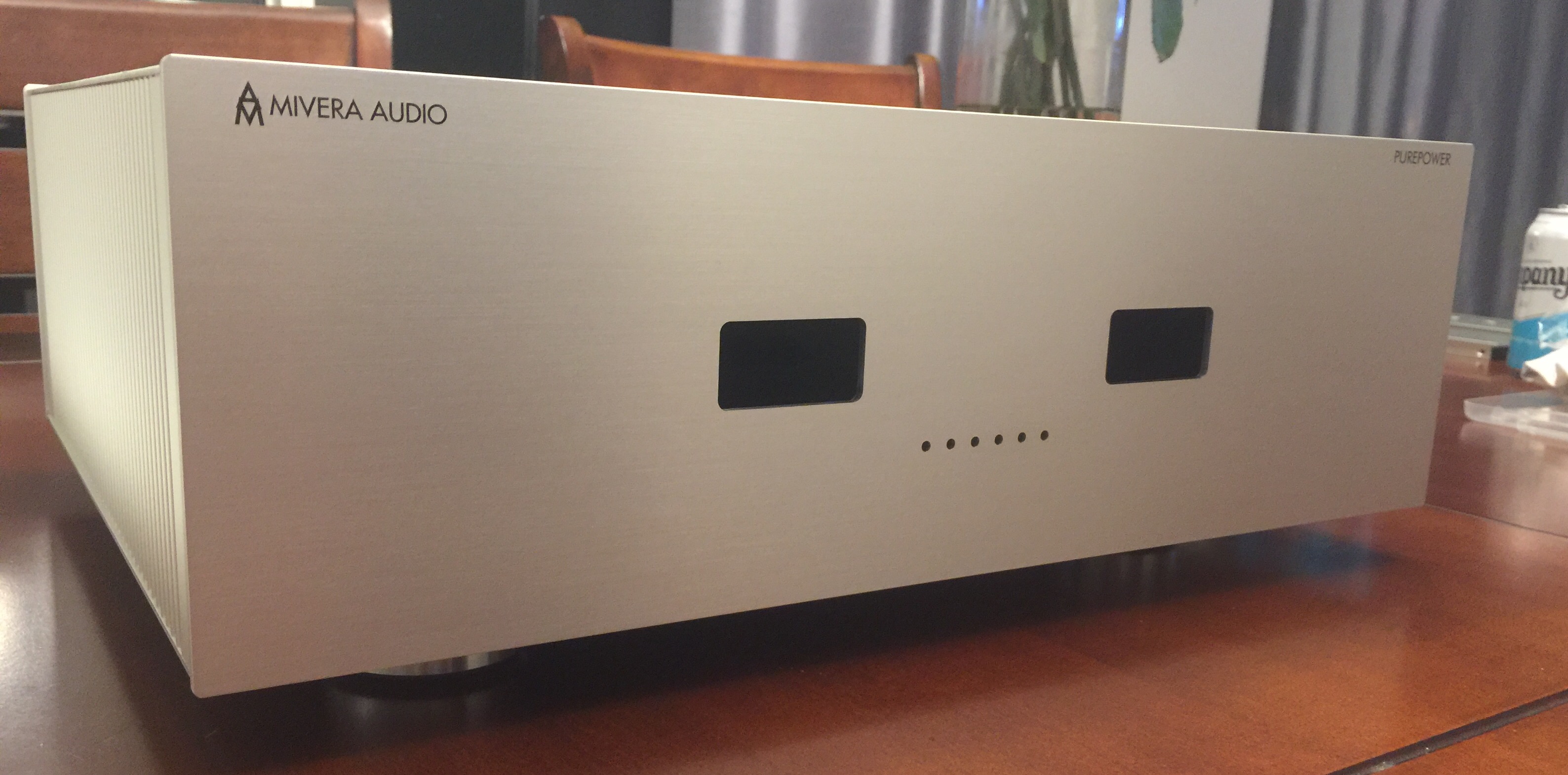

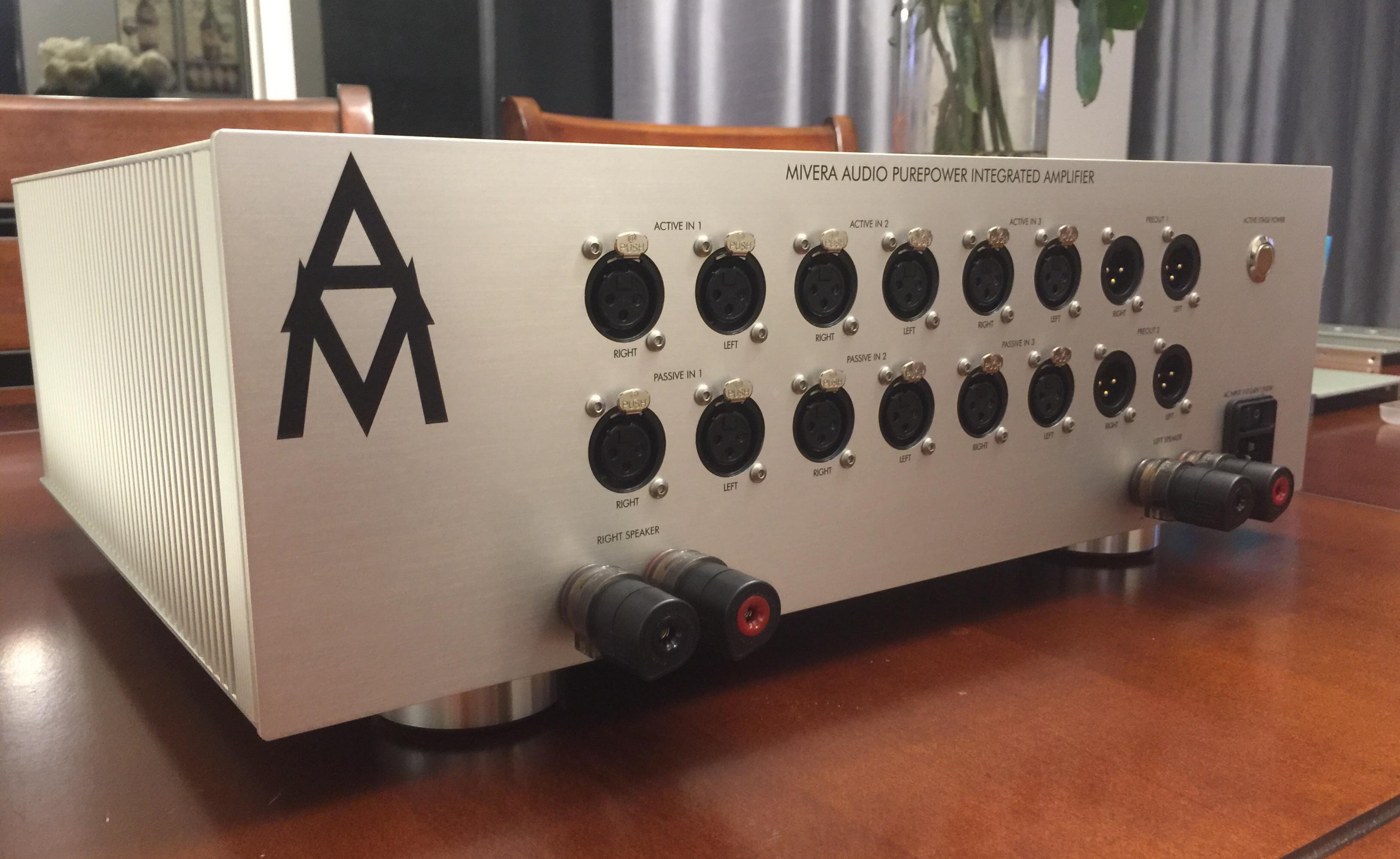

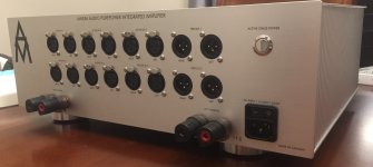

Our latest DIY build. 2 channel in, 6 out. Preamp section has dual sets of balanced Bent Audio Slagleformer AVC volume controls (8 in total). The dual displays on the front go up and down simultaneously with the remote. The left indicates the level of the dual preouts that are connected to the 2nd set of Slagleformers. The right display is the level of the internal dual mono NC-500's. It's designed for a guy running an active tri-amped setup. If you press the right/left buttons on the remote, the output of the left (preouts) and right (internal amps) fades between each other. He will be connecting a pair of active subs up to one of the pre-outs, and a Nord amp up to the other to run his woofer section. So left turns up the mid/highs, and right turns up the woofers/subwoofers. Internally depending on the source driving the amp you can use the passive inputs and drive the NC-500's direct and buffer-less. For example when used with our Purestream DAC's with quad Weiss OP2-BP opamp gainstage with 10 ohm output impedance and 6V output. However if the source is weak, you can connect to the active inputs, press the button on the back to turn on the active stage, and our internal buffer with Quad Weiss OP2-BP's provides a buffer for the NC-500's beyond anything I've ever experienced 🙂
