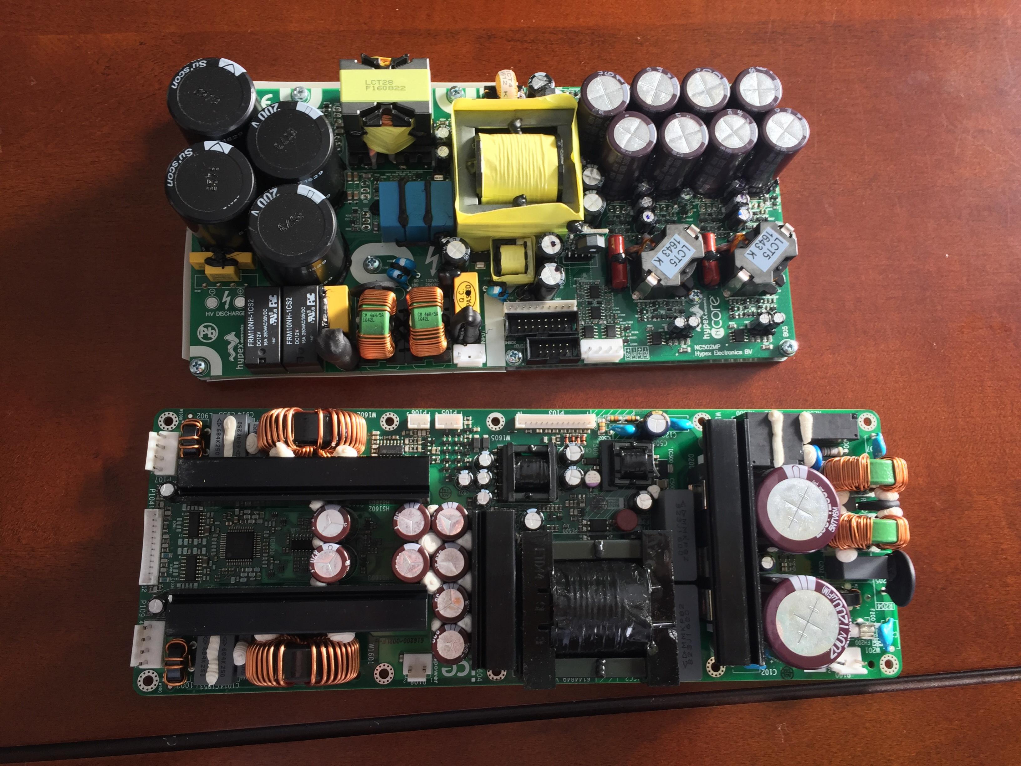

Listened to the flagship Icepower 700AS and didn't like it. Sounded colored and tonal balance was off. Nowhere near NC500 territory. Tried the Hypex MP502 and got rapid popping out of both speakers. Disconnected the inputs and same thing. Not sure what's up. Waiting to heard back from Hypex tech support. Already going on day 5 and no response from them. I guess they must be backlogged with emails or something.
I haven't listened to them yet. The Hypex looks better built.
Data sheets:
https://www.hypex.nl/img/upload/doc/ncore_mp/nc502mp/Documentation/NC502MP_02xx_03xx.pdf
http://www.icepower.dk/files/solutions/icepower700as2_datasheet_1_0.pdf
You could probably tell us what sounds better from the data sheets alone 🙂
The input impedance on this Icepower installment looks much better (36kohm) did I read that right?
