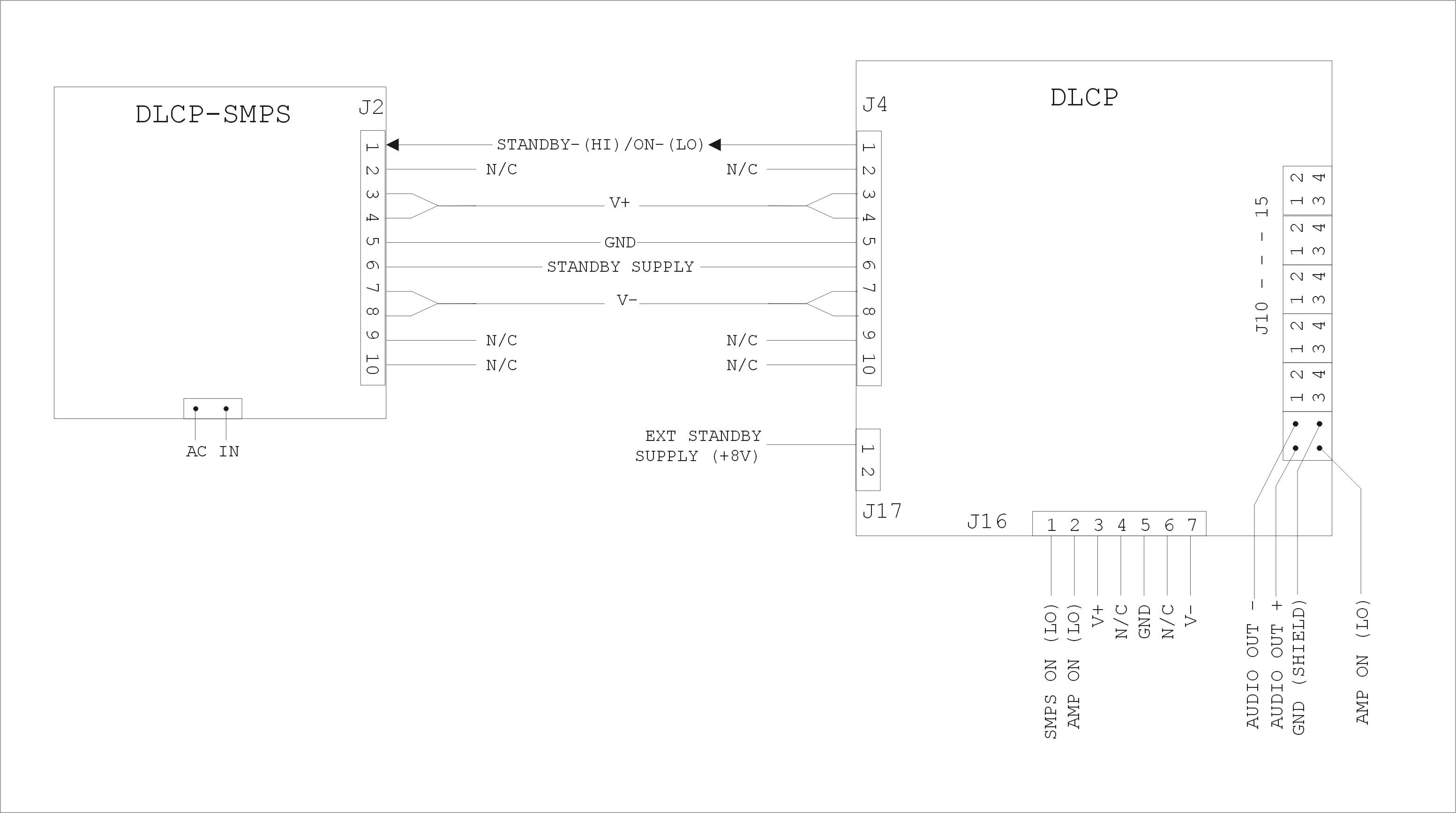

As outlined earlier, the DLCP is the system controller, and in order to take advantage of its features like stand-by, triggered fom the remote control, the DLCP should remain powered by a Standby power source. For reference, the DLCP-SMPS recommended by Hypex and its connection with the DLCP are given in the block diagram.
When the main power switch is thrown on, in the default condition, both the V+/- supplies and the standby rail (+8V) are on. For initiating the standby mode, the microcontroller issues a shutdown command for the main V+/- rails. Hypex documentation is not very clear about certain aspects, but it is obvious that the micro-controller and its allied digital circuitry remain powered by the always-on Standby rail, while the signal processing circuitry are powered by the V+/- rails. Upon receiving a wake-up command from the remote, the controller pulls the power control line to (LO), switching on the main power rails.
Kindly also note that the DLCP provides separate SMPS-ON and AMP-ON control signals. In various scenarios, a mix of these control signals could be used in a complex system. The individual DLCP outputs J10 to J15 are particularly convenient for system builders, each connector offers two lines carrying the balanced audio +/- signals, the third happens to be the shield/ground and the fourth wire carries the Amp-on, active low control signal--this could trigger on either an SMPS (with its feed to the amp module via the Auto amp-on line), or an amp module when fed to the Amp-on pin directly.
Hypex approves of the DLCP module being operated from the auxiliary V+/- rails of the standard SMPS (like the 400A) that power the amp modules. However, kindly note that Standby mode can be entered only when an external standby voltage is fed into J17 (+8V, with the 0V rail going to Ground).
Many builders make use of small, cheap switching supplies here as they believe it is not critical, as it only powers the digital circuitry.
However, more than once it has been reported that the use of a "cheap and cheerful" PSU here 'somehow' affected the sound quality of the DLCP outputs. Builders have, to my knowledge, experimented with DIY regulated power supplies built to high specs, which have 'restored' the audio quality. This is getting a mention here as it will be foolish to brush under the carpet such claims without ample experimental evidence, which surely is within the capabilities of the average experimenter. One particular builder has gone to the extent of claiming 'fabulous' improvement when he employed twin transformers and regulators, one set for the V+/- rails and the second exclusively for the Standby rail powering the micrco-controller and the associated digital circuitry.
Objective auditions are called for here before favouring one or the other approach.
--UKP

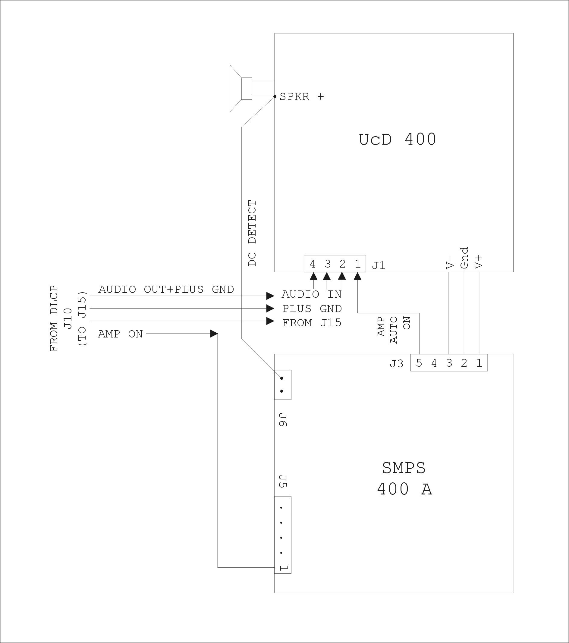

SYSTEM OPTION-1
Let us take a look at the 'standard' option of an all-Hypex system.
The system has the DLCP and its recommended SMPS, amp modules like the UcD 400 or 180, and their associated SMPSs.
The hookup is pretty straightforward. As recommended earlier, the Auto amp-on feature is used, the relevant SMPS in its turn getting triggered by control signals from the DLCP.
Other options will be examined in future posts.
--UKP

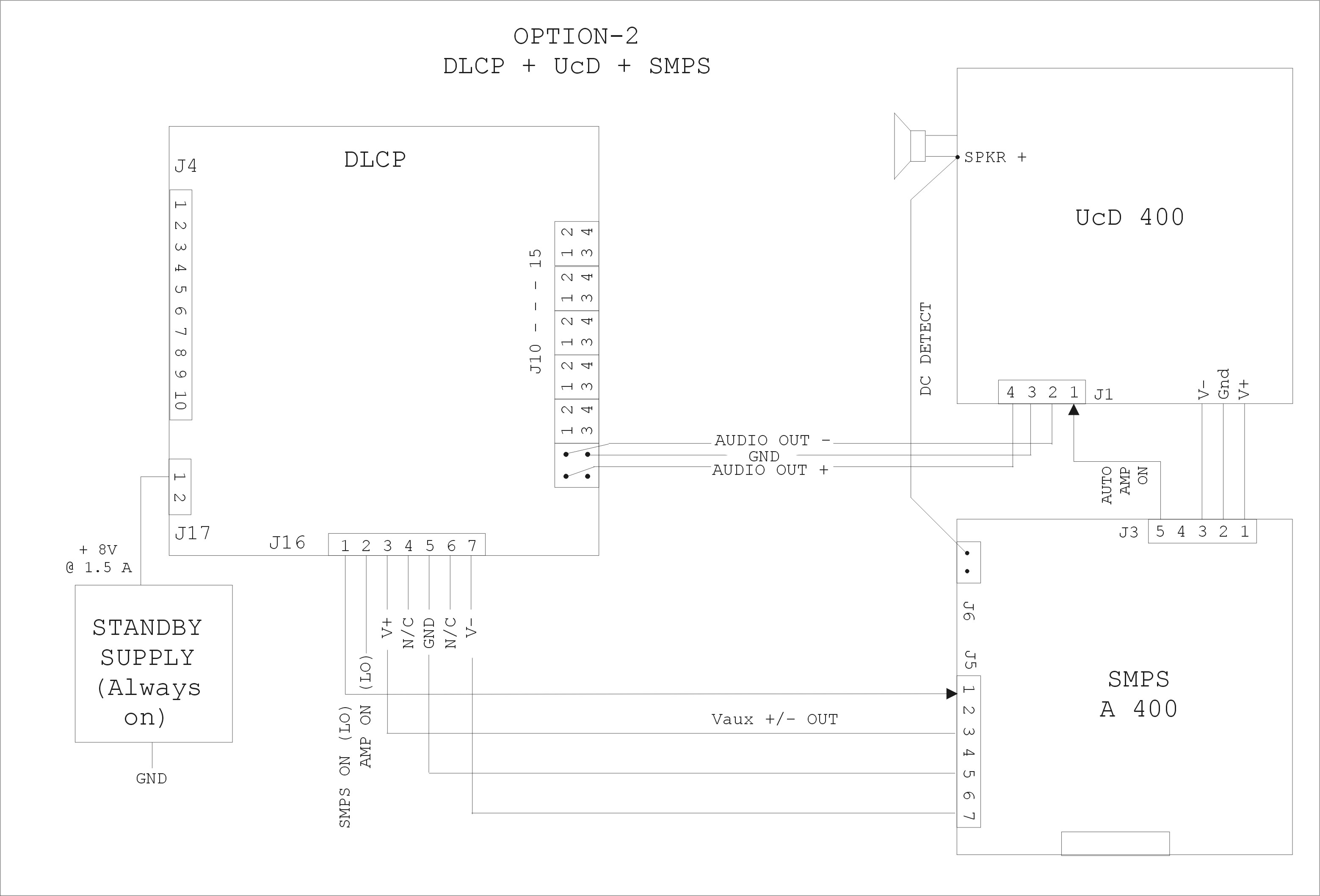

SYSTEM OPTION-2
The second option available to the builder is to run the DLCP from the SMPS powering the amp module.
SMPSs like the A400 provide a couple of auxiliary V+/- rails (about 20V) which will handily power the DLCP. But the caveat is that in order to be able to use the remote-triggered Standby mode, you need to plug in an external supply of +8V/1.5 A, which remains 'live' while the main SMPS/s go to sleep in Standby mode. Do make sure that the 0V line (Ground) has continuity with the SMPS ground. (DLCP J17 pin#2 is Gnd.)
The wiring up is straightforward, with the DLCP triggering the SMPS off and on, the amp modules getting turned on by the relevant Auto amp on signal.

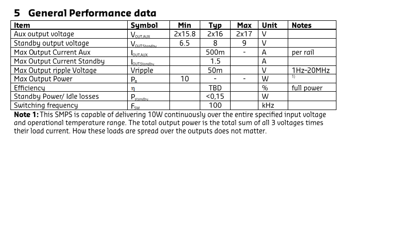

Here I am also attaching the specs of the Hypex DLCP. Kindly note the Standby rail voltage and current. The 30 mA is while the DLCP in Standby mode.
Kindly note a correction also.
The DLCP main power supply rails are +/- 16 V typical and NOT +/- 18 V as I had posted earlier. My apologies.

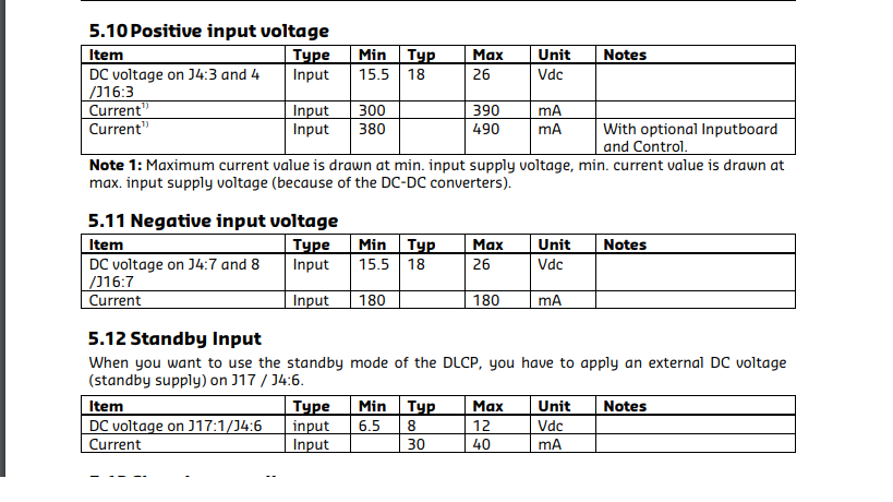

@ ds23man
Thank you for that warning shout!
That woke me up, and I did take a good look at the DLCP spec sheet.
You are right!
Hypex say the DLCP V+/- typically is 18 V @ 500 mA, while the standby voltage is 8 V @ 40 mA max.
I had thought that when you chose to substitute one piece of equipment with another, you followed the specs of that one. How foolish of me!
When it comes to the petite DLCP SMPS, Hypex say the typical V+/- voltages are only 16 V @ 500 mA and the standby rail is 8 V @ 1,500 mA. Ah, maybe Hypex thought that hobbyists have ample ESP to figure out all these mysteries. So much for their data sheets... And thank you ds23man for your eagle eyes.
However, I feel that feeding a connection that needs 40 mA with 1,460 mA more is not going to bring the skies down. Had I sleepily typed 18 V instead of 8 V, this ought to have merited a loud vocalization, no doubt. Perhaps ds23man, living so close to Hypex, could kindly choose to wake up Hypex, and correct THEIR document.
