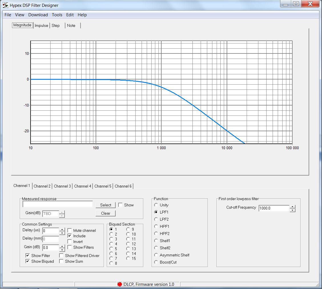

I only see first and second order filters in the software. Quite limited if that's the fact. Is there a requirement to make measurements or import any in order to set crossover settings?
I don't find the sotware very explainable and there's not much information from the help menu.
