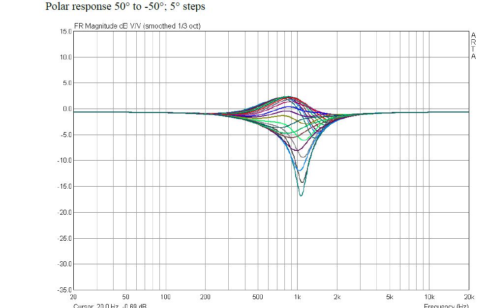

I also think linear phase is overrated....
We have to see everything in it's perspective. Only a loudspeaker with 1 driver hase a linear phase, if you ad a driver it aint anymore. Phasing will be dependent of listening position and can't be corrected with a filter ( or you should put a sensor on your head attached with your dsp😛) The only thing you can do is correcting the phase on one position ( aka the sweet spot) and is done with delay. If you change your listening position in the vertical plane, the delay time for the drivers to reach your ears change and so will the phase..... The most important thing in filtering is to get the phase right at the crossover point related to the intended listening position.
The attached picture is from the earlier mentioned linear phase xover, but demonstrates this phase "problem" clearly ( and does not solve it!).
