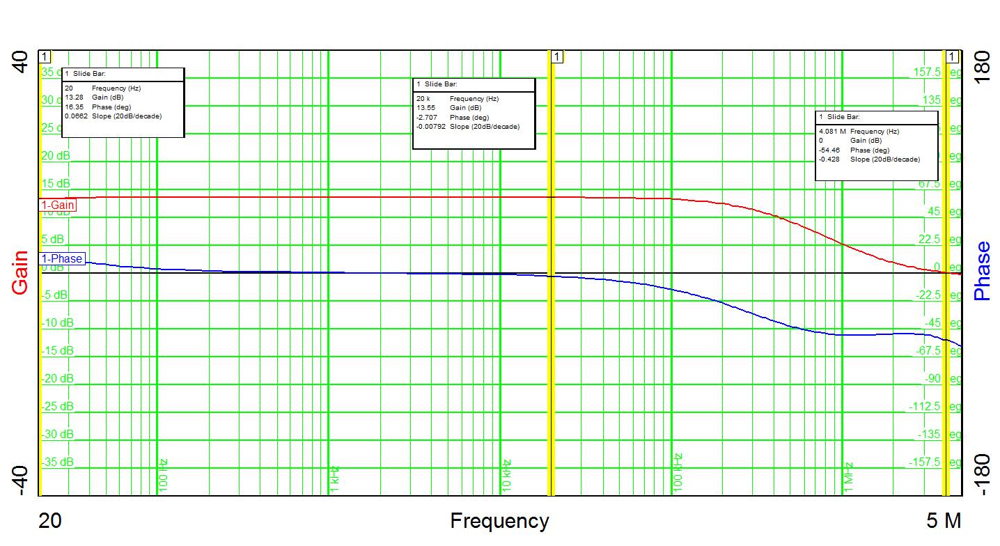

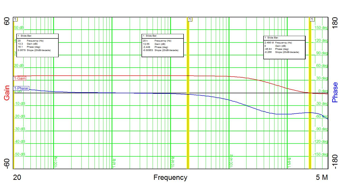

OK, I changed resistor values to lower standing current in the gain blocks, though each tube 1/2 still gets 5 mA bias current. Here are the gain-phase plots for the line amp. I may or may not proceed with the new layout, as the lower bias current will reduce the temperature for the SOT-223 output fet for each gain block. I will need to add a a bias network network for the RIAA 2nd stage to boost the output voltage and output fet standing current. The line amp, however looks fine with the new resistor values and a reversion to the 2-capacitor compensation scheme.
One of the things proven by this G-P run was my diagnosis of the peaking problem in the previous plots. Cutting away the section of the PCB heat sinking trace (connected to output drain) that was under the input capacitor of one line amp channel got rid of the peaking response and restored normal operation. The trace under the input cap was supplying capacitively coupled positive feedback and causing the peaking. Feedback can happen in sneaky ways...

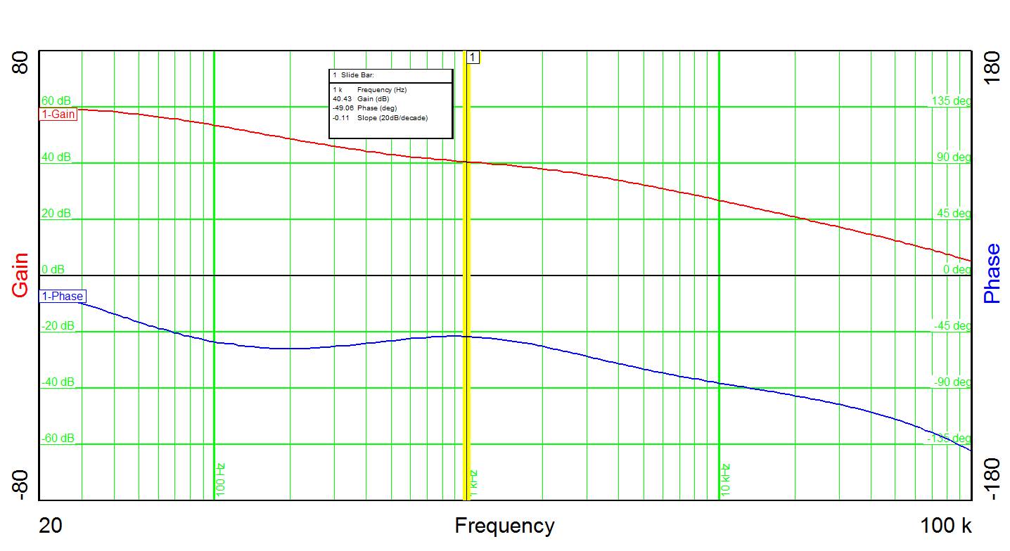

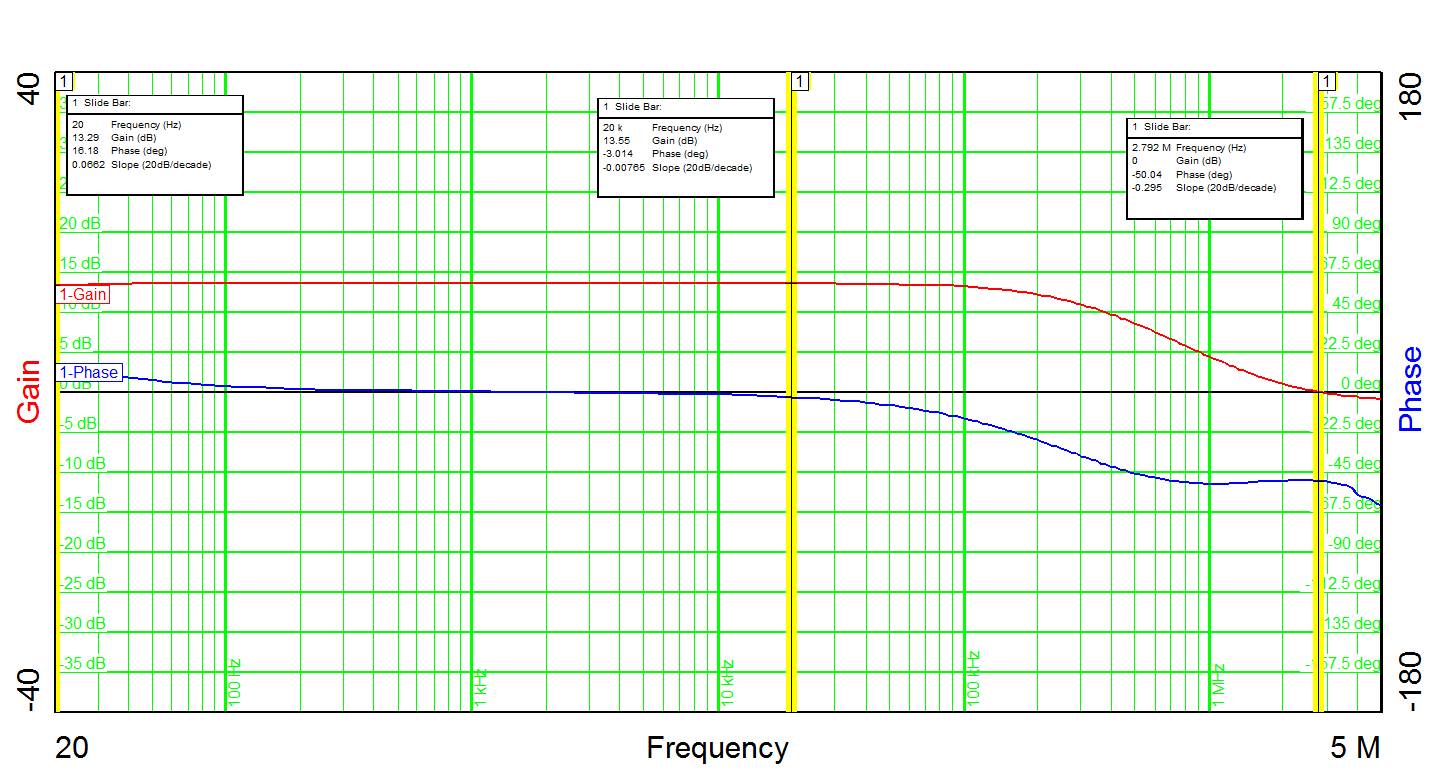

OK - I ran gain-phase plost on the line amp and on side of the phono stage. The line amp looks OK (both sides), and one sode of the phono amo is OK as well.The other side of the phono amp is out of sync with DC and AC results. This may be a reaction to improper design or a defect on the boards I got back from PCBway.I may be looking for another board vendor, as this is not the first circuit mishap I've seen for boards that are nomilally laid out OK.

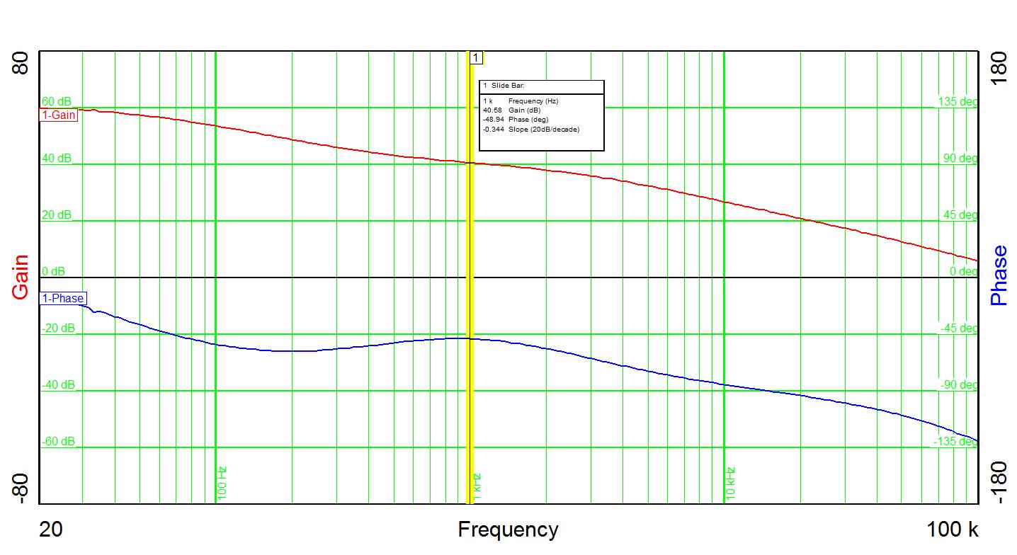

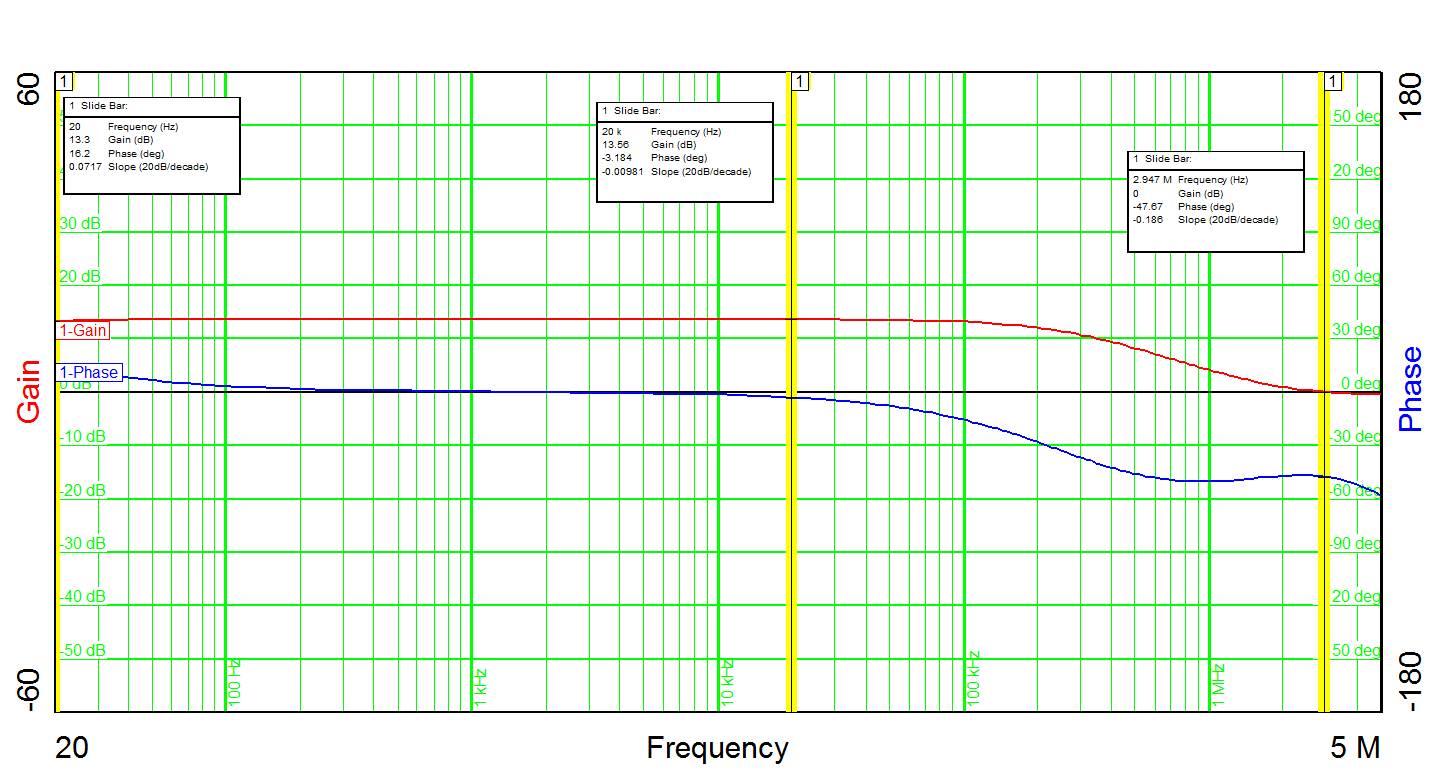

I figured out the problem with the other RIAA channel of the preamp - it was my bad, and a touch with the Dremel fixed it right up... I'll be running the gain-phase for that channel tomorrow. After that, it's just a matter of bringing up a suitable DC-DC converter to supply +150 VDC from the 19V switching adapter.
Here's the gain-phase scan of the 2nd RIAA channel that was giving me conniptions for a while - trouble is, when you use surface mount parts, sometime they look like they're soldered when they actually aren't... Fixed, anyway. The gaon-phase scan shows a close match with the other RIAA channel.

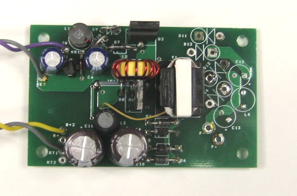

I have a DC-DC converter board that was originally paired with the first version of this preamp using subminiature tubes and an all-semiconductor line stage. I'll be rewinding the transformer on that board for 19 VDC input. I figure if I plop the converter into a die cast aluminum box with feedthrough caps and a common - mode inductive filter to clean up the output, I'll be cooking with gas...

I fired up the little DC-DC on the bench with around 90 mA load, and temperatures are 50C and below, with the transformer the hottest thing on the board. Efficiency is 93-94%, and operating frequency is around 70 kHz.

I'm looking at a regulated option for the HV DC-DC converter using the venerable TL494 controller. The topology is a push-pull variant of a boost converter using the dead time option of the controller to vary overlap between the two phases to regulate the output voltage. Bench tests on the breadboard look promising.
