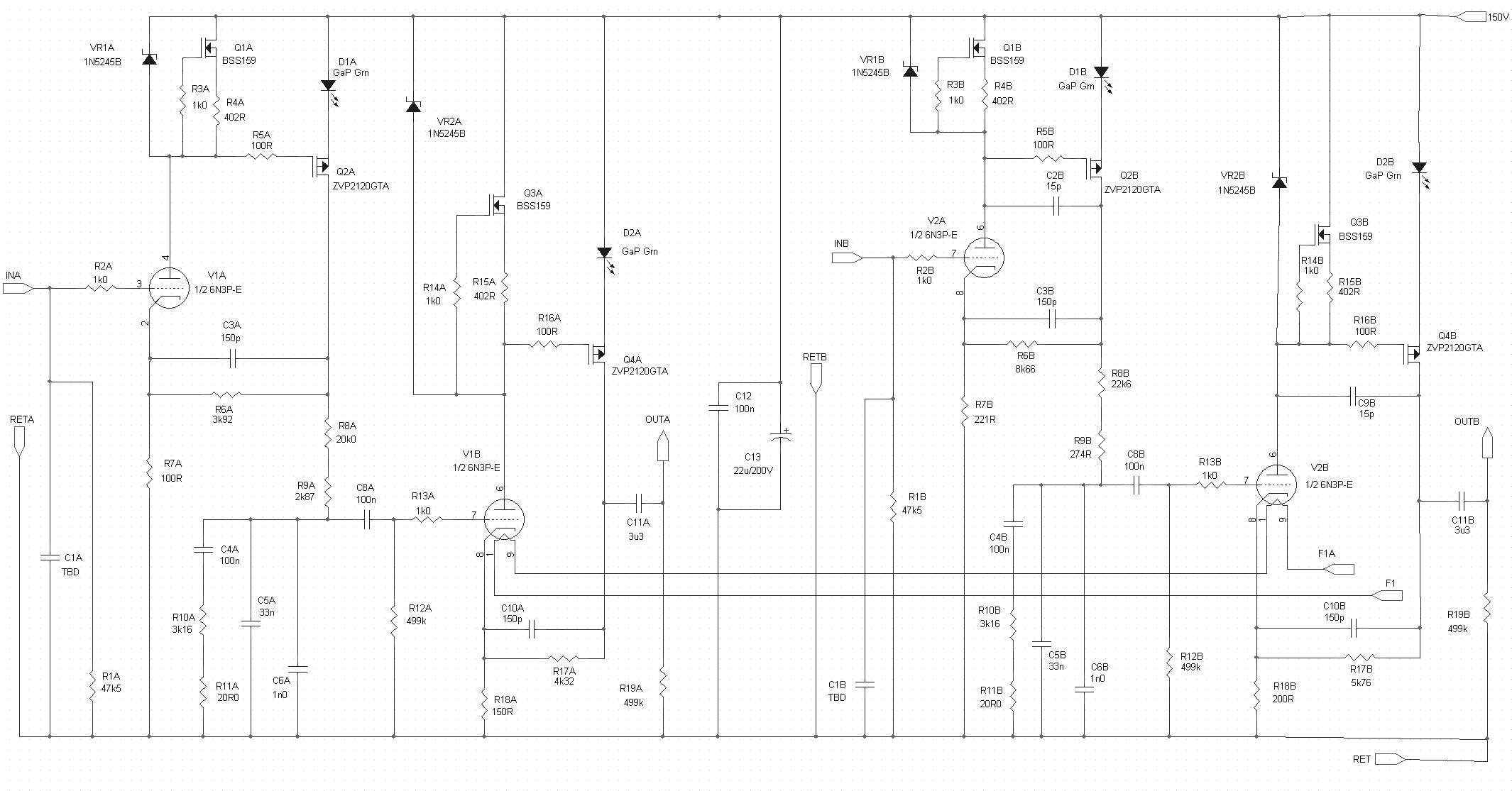

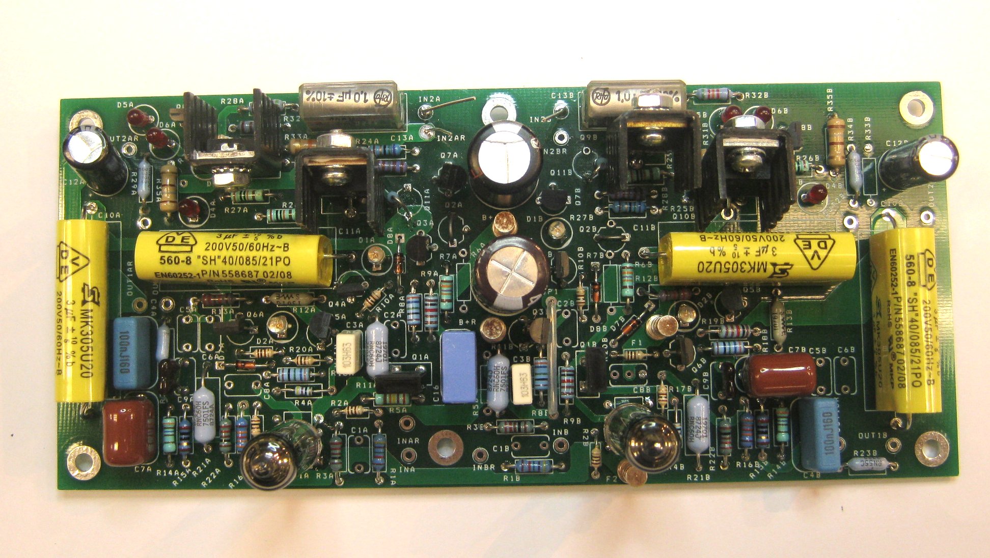

Attached is a view of a partially stuffed board that incorporates a hybrid RIAA preamp using a pair of submini Russian dual triodes with sand helpers, and a unique line stage utiizing a solid state triode emulator that acts like a gain-of-6 triode with 75 ohm output impedance. The fake triode is loaded with a cascoded current source to minimize stray capacitance and reduce distortion. The fake triode circuit shows impressively low distortion in simulation.
The top of the board contains the fully stuffed line amp. I'll be running some gain-phase plots on it tomorrow, along with time domain response. When I'm satisfied with the line stage performance, I'll finish stuffing the RIAA section and characterize that. This is one project that will likely make its way to this year's Burning Amp.

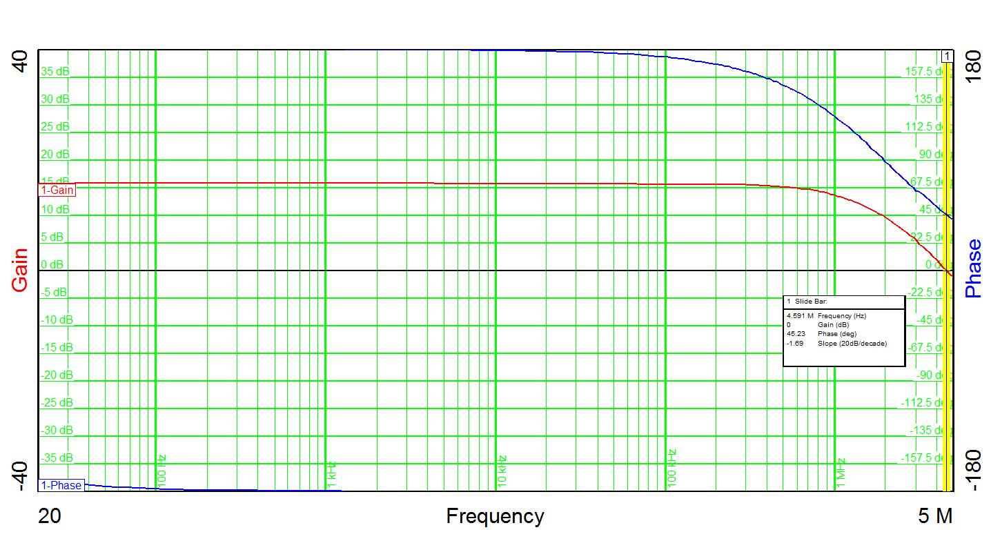

Attached please find the gain-phase plots for the two sides of the line amp. Response is zippy, but 40-45 degrees of phase margin leaves some room for improvement. Reducing the impedance feeding the output stage might help.

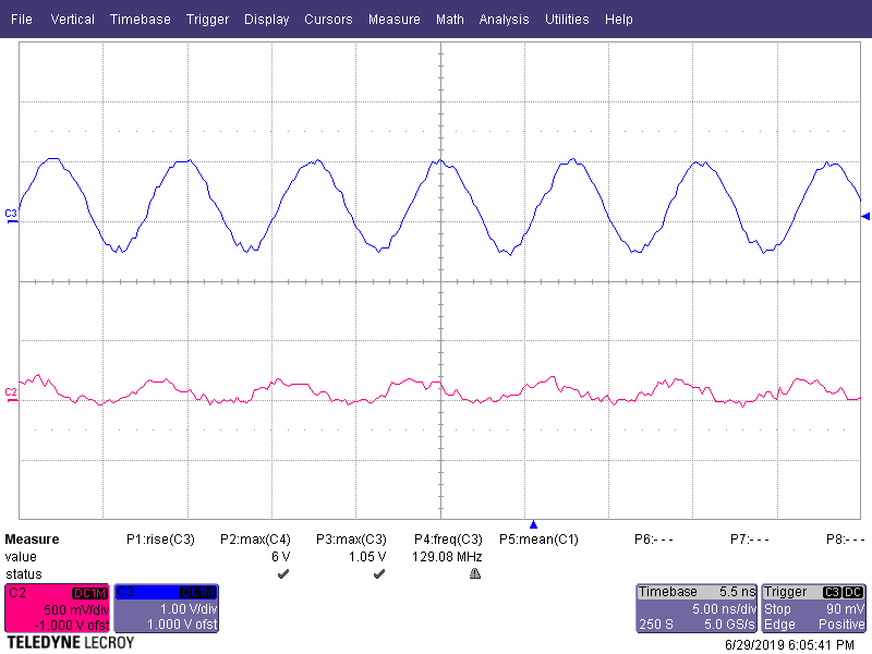

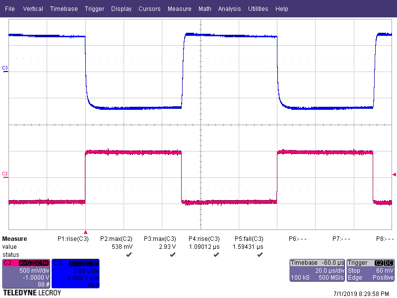

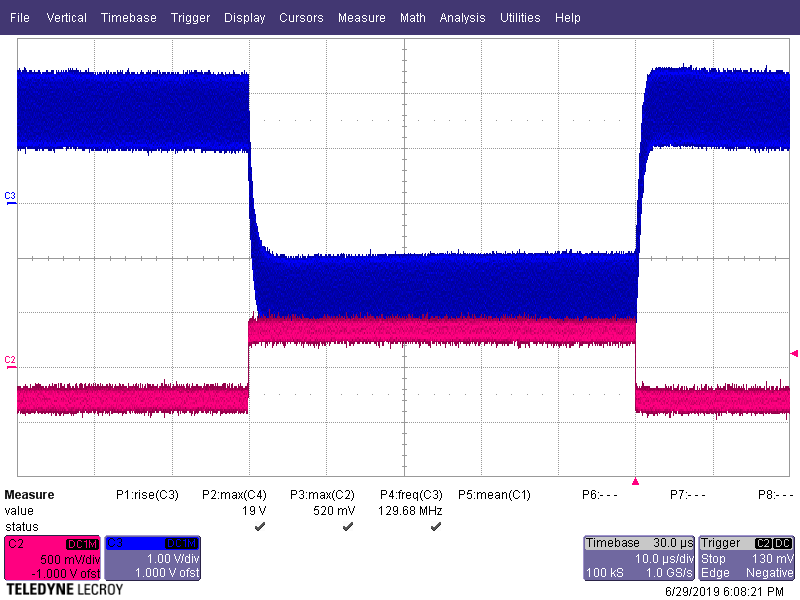

Finally, the time domain response shows a problem really needing fixing. As can be seen, the output waveform looks "wooly". Expansion of the waveform shows a ~120MHz parasitic oscillation. I suspect this might be coming from the current source load, and a judiciously placed ferrite bead might fix the problem.
More later, as I dig into these issues.

Here's the board with everything that matters stuffed. The tubes light up, the bias LEDs light up, but the bias levels one the output stages of the phono stage needed adjustment. Done now, so I'll be doing some characterization of the phono stage tomorrow.

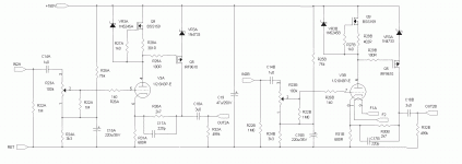

I did a re-do of this project using 6N3P-EV instead of the submini tubes. I also used a hybrid solution for the line amp instead of the all-solid state circuit as in the original project. The 6N3P-EV also has a shield between sections, which should reduce cross-coupling between channels.
There is some method to this madness, as with the addition of the 3rd tube, the filament voltages add up to nearly the output of a commonly available 19V computer power adapter. I'm thinking rather strongly of using a Baxendall converter fed by a buck converter to generate the B+. The Baxendall converter operates with a sine waveform. I've already breadboarded the Baxendall converter half of the DC-DC converter, and it works satisfactorily.

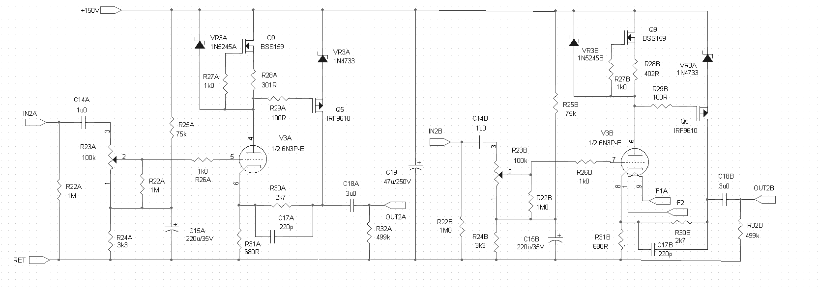

Here are schematics for phono and line sections of the hybrid preamp utilizing 6N3P-E. 6N3P-E is several times cheaper than the submini tube I started with, easier to find, and of course, are compatible with std 9-pin PC sockets.
Resistors and p-channel fets are coming soon so I can finish populating this preamp and power it up for testing.

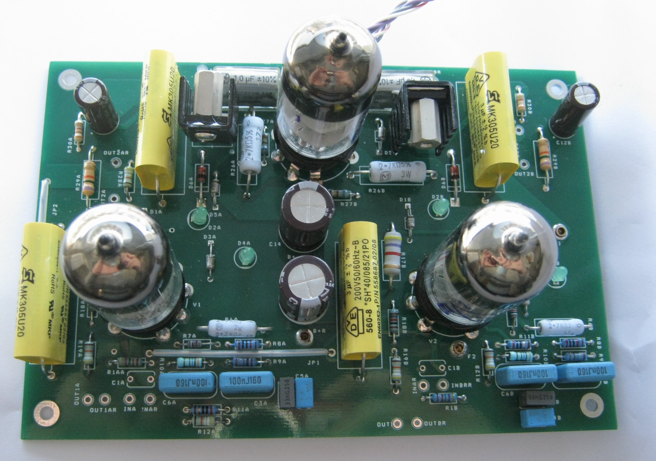

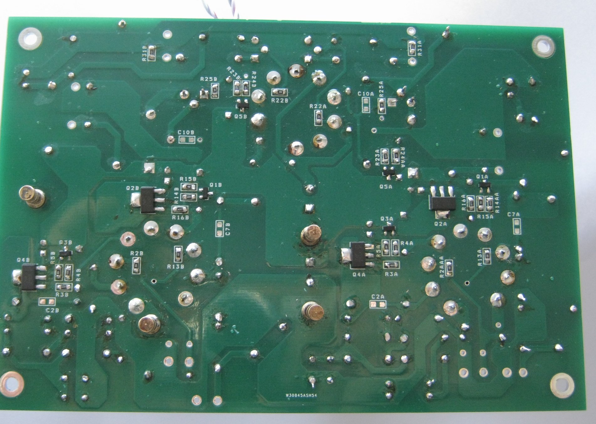

Here are top and bottom views of new board utilizing 6N3P-E. I chose to implement the line amp using a vacuum tube hybrid circuit rather than the original total solid state to avoid a big voltage transient from the line amp output during power-up. I will probably also use a capacitance multiplier on the B+ to get a slow rise characteristic (belt and braces). The last thing I want to do is to hook this preamp up to some poor, unsuspecting solid state amp and blow its input due to a power-on transient.
