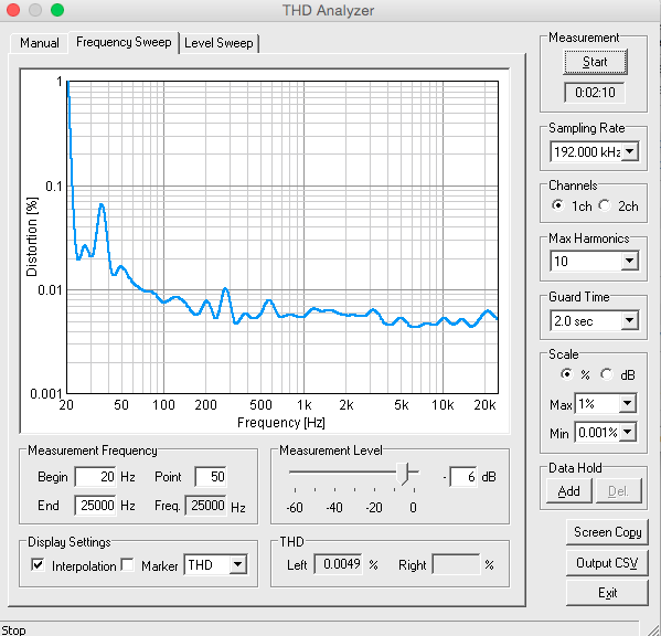

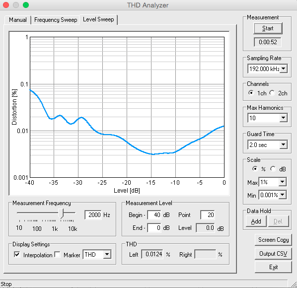

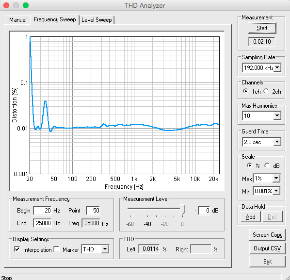

preliminary thd plots
The file name describes plot. To make all happy, I'm plotting to 25khz at 192.
I'm gradually increasing output power in increments as a detailed study.
Final target power is 10watts. These plots are headphone level.
Again: same two active component CFP , 12au7 and a single semiconductor.
cheers.

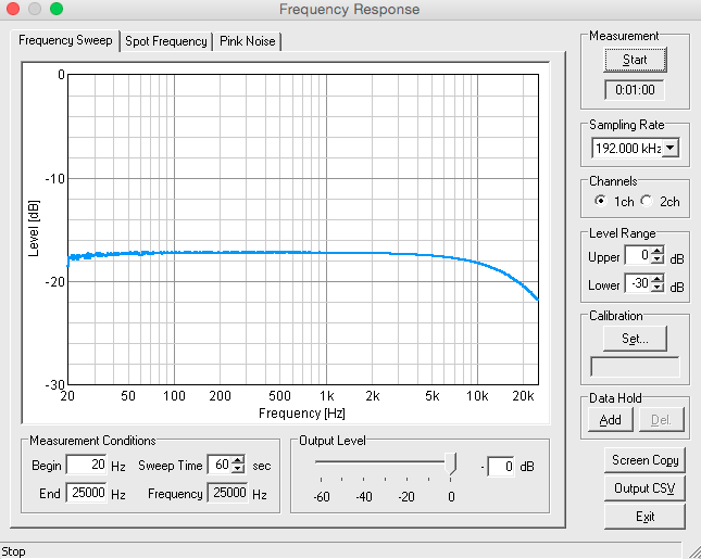

Hint: slew rate... ;-)
don't know it looks great at 100khz , no compensation cap needed either.

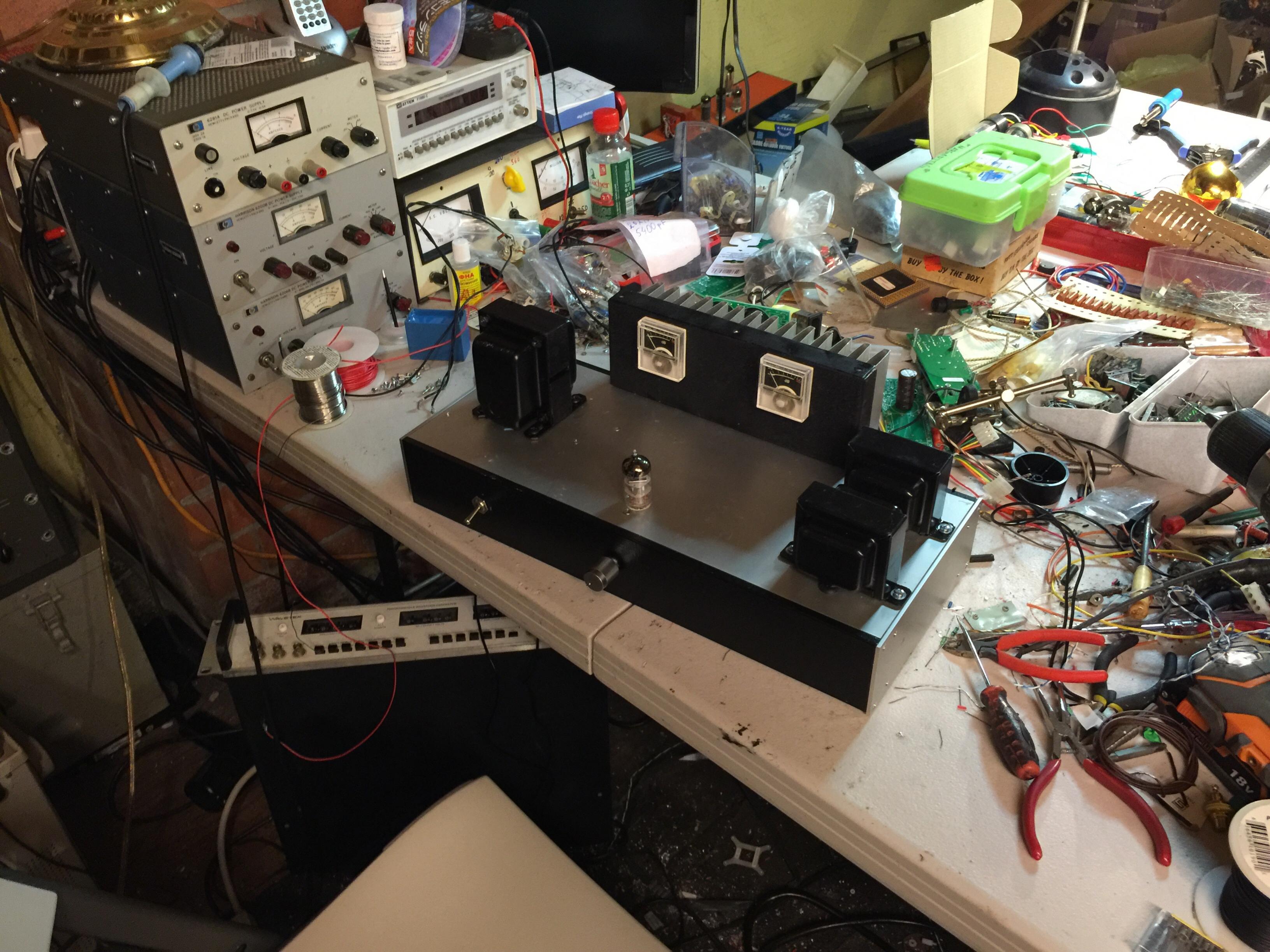

Time to connect VU-meters... Enough listening... ;-)

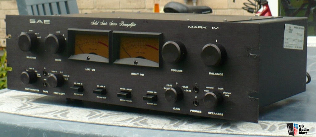

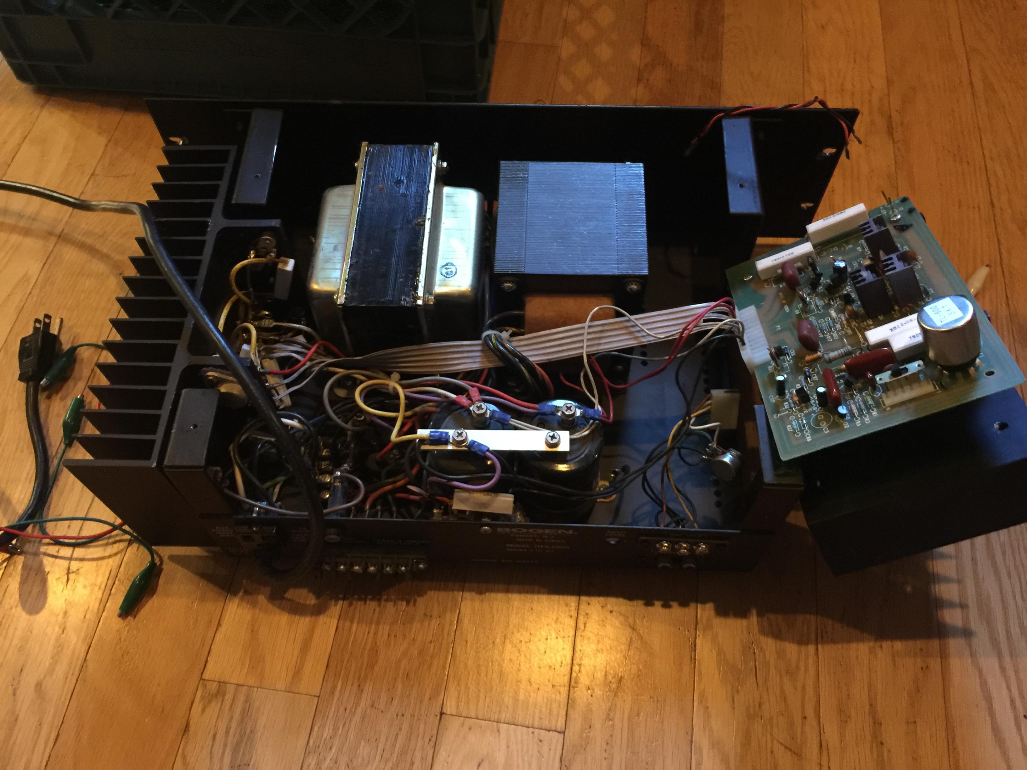

I was out looking for donor chassis yesterday and picked up a SAE 2200 power amp for $60 with led 'VU' meters.
I thought it was going to look silly but was really nice to watch.
So will leave it alone and get another donor.

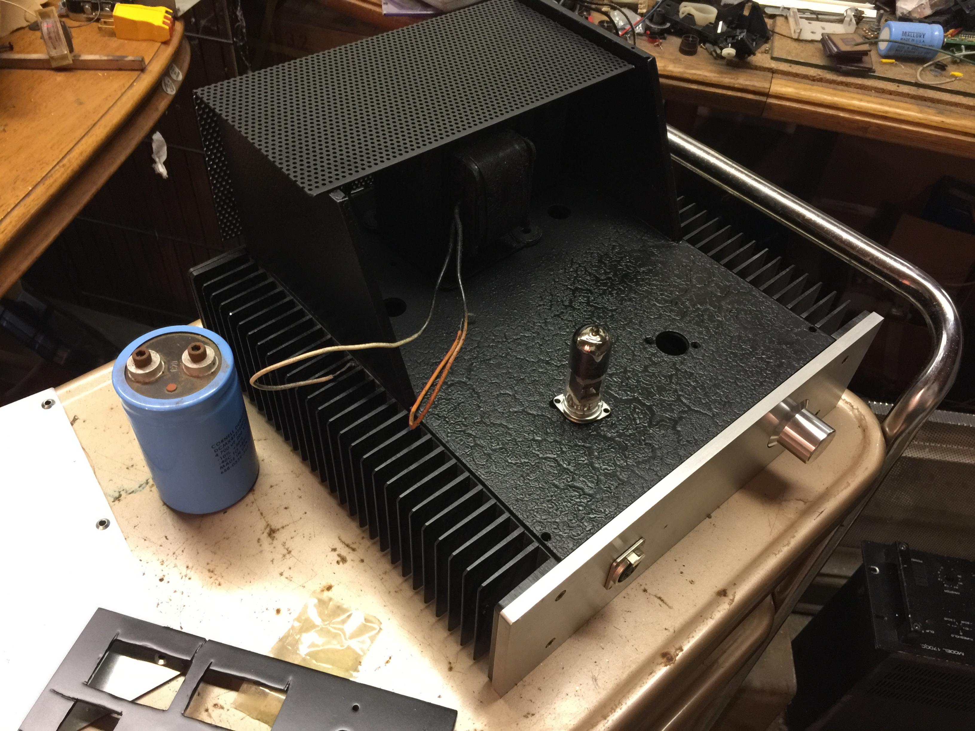

also the circuit now has enough power to properly drive a reverb pan and tone stack.

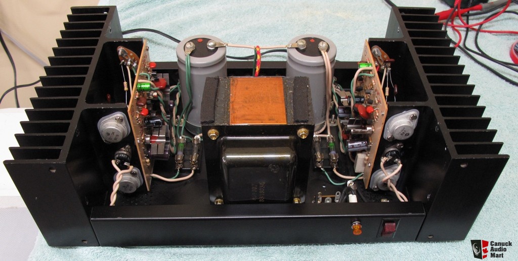

going to need a serious heat sink for next stage.
hafler has some old mega heat sink models that can be found either on ebay 'for parts only'
or just plain cheap.
this pic is dh200.
p3000 has biG find too.
this pic is dh200.

This one will look like tank. 🙂
nice.
I was re-arranging my test equipment and had all the enclosures turn around so heat sinks were facing out. Wow I think its an accidental discovery. I like the Klingon equipment look.

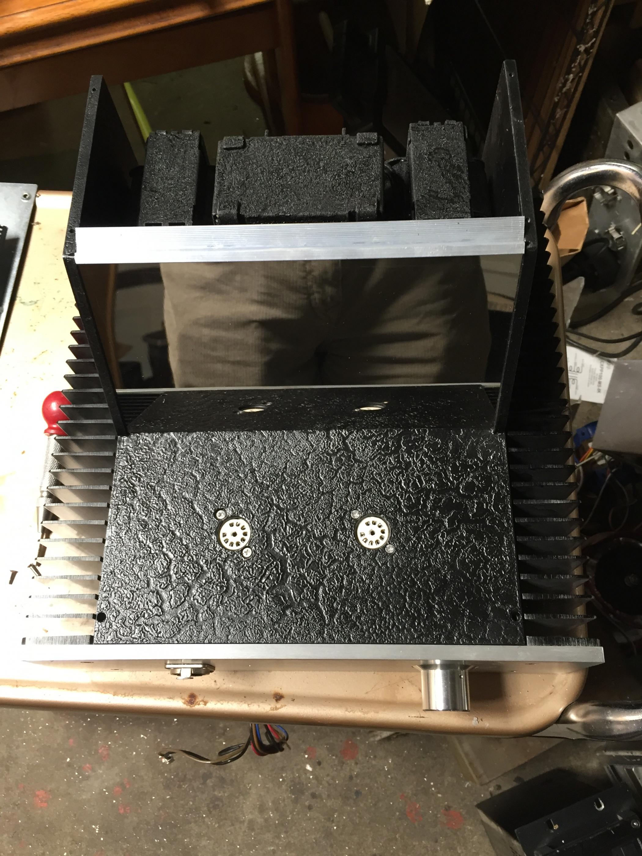

Transformers are bolted... Going to solder.

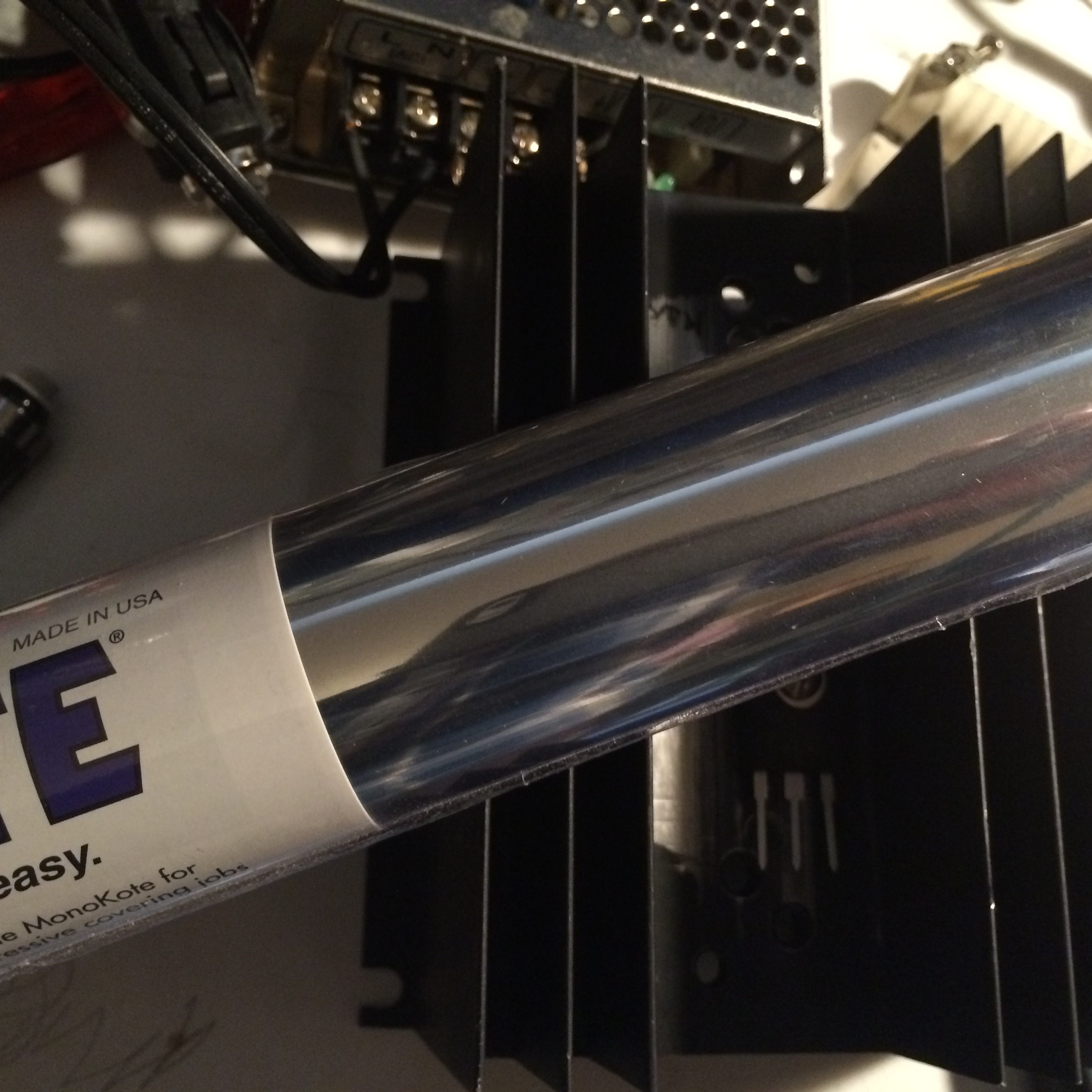

looking at your chrome i realized an easy way to get 'chrome panels' using Mcintosh's sandwich concept.
Just put the 'chrome' behind a lexan or glass sheet. For chrome maybe use Monokote foil.
I am afraid Lexan is not transparent for IR?
I use stainless steel. It is reflective, and have low thermal conductivity.

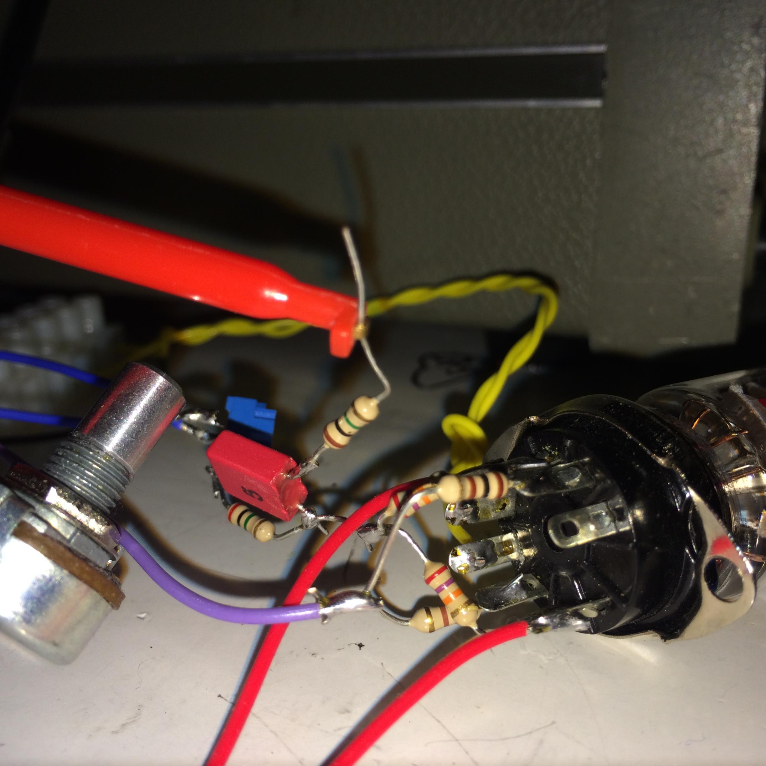

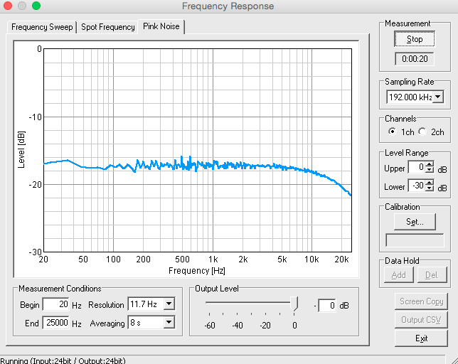

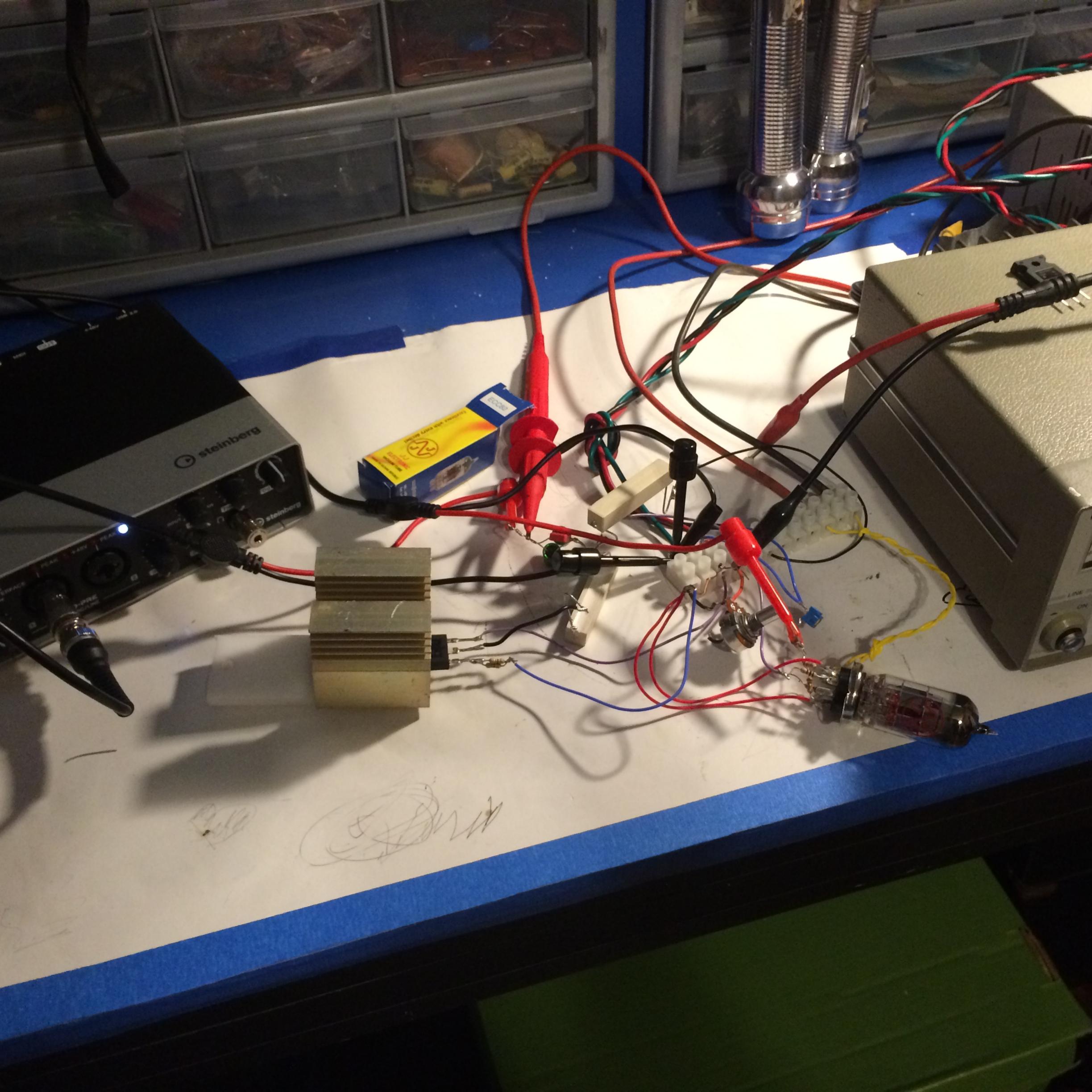

Grid leak test
Here is a grid leak test arising from pre-amp thread, only change is series 1M resistor for the test itself. Same +-25VDC supply.
As on the SS version, THD actually does down due to the introduced input divider.
Some new HF loss is seen and low f distortion artifacts. The test resistor is normally not present.
The big pot is R2 and trim pot is bias.
Note: the response plot(s) includes pink noise version
The UR22 has 150 ohm output z feeding the 1M resistor, UR22 input z is normal channel 20k ohm z.
The tube is a new JJ with about 4 hours on it, using Heathkit IP-17 HV lab power supply 12vac heater.(not shown)
File names have description of pic.
Cheers
Bruce
