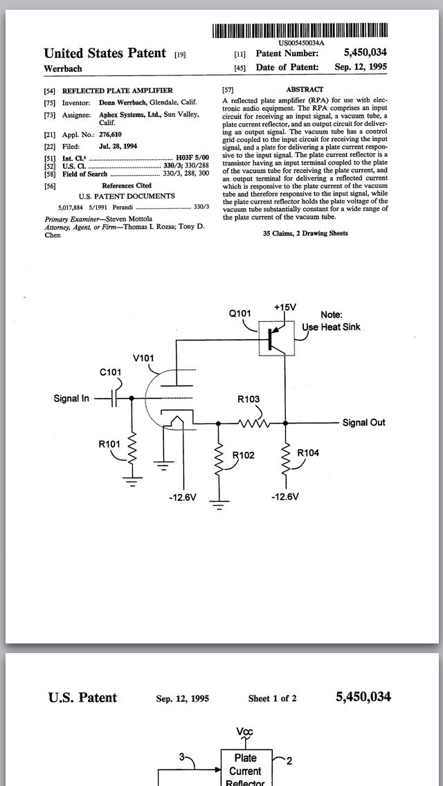

I finished preamp:
http://www.diyaudio.com/forums/solid-state/290026-simple-discrete-sziklai-pre-3.html
now workin on hybrid output.
Did some searching and considering something along this topology.
opinions? good bad ugly ?

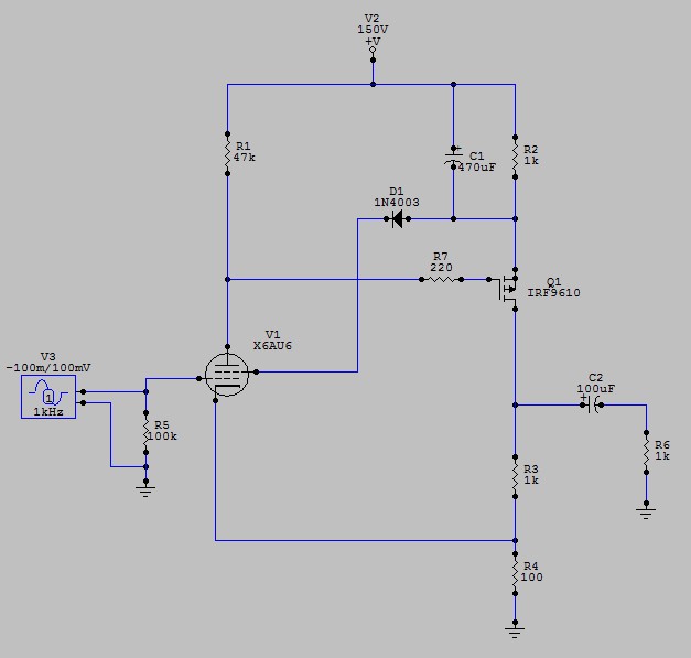

I have done something similar in my most recent headphone amp using the 6418 and ZVP3306 with a ZVN3306 sitting on top as a mu follower (discovered the circuit myself somewhat by accident last fall, though its topology was probably known before). It simulates very well with these parts, but I've not successfully generalized it with other combinations of tubes and MOSFETs. Seems some playing with settings is required to get it to settle down. At any rate, the amp works great with the 6418 and 3306's, and I just posted pictures today of my completed build.

I used similar topologies. However, some measures for stability of the working point have to be taken.
its an old expired patent. look like could be easy to improve. add gain etc.

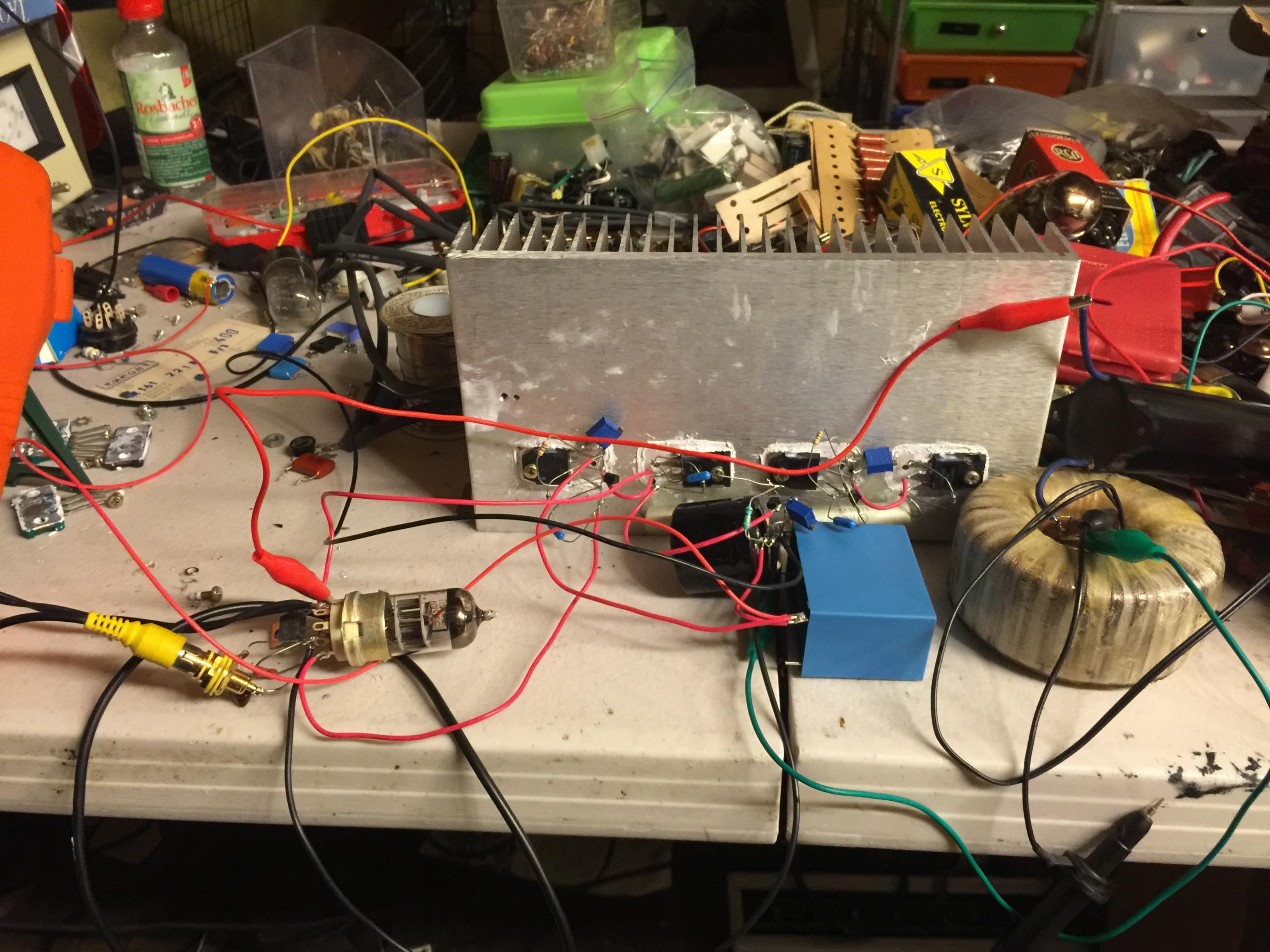

I've had success using something like this for the input section of a SET power amp. My breadboard version uses a 6J6 twin-triode diff amp, an NPN constant current load for the PNP gain stage, then a BJT Sziklai pair buffer driving the power tube in class A2. I don't use the diode. Distortion at closed-loop gain of 100+ and 90Vpp output is below the FFT mud in a good Tek scope, so better than 50dB down.

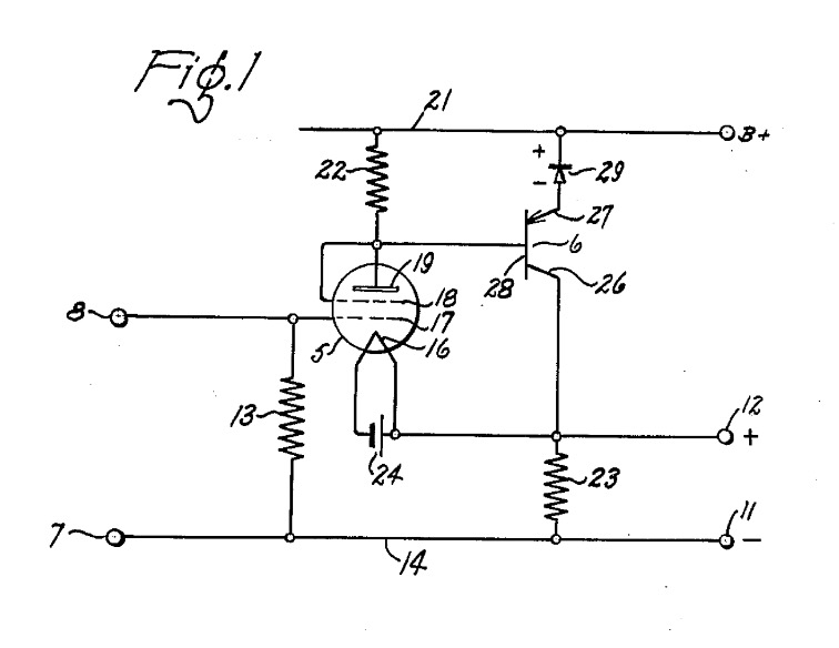

Another example using device characteristics to self stabilize operating point.
Yes, very close to mine. 😎
I use additionally 2 CSS', and one opamp for servo. This one is good for a preamp.

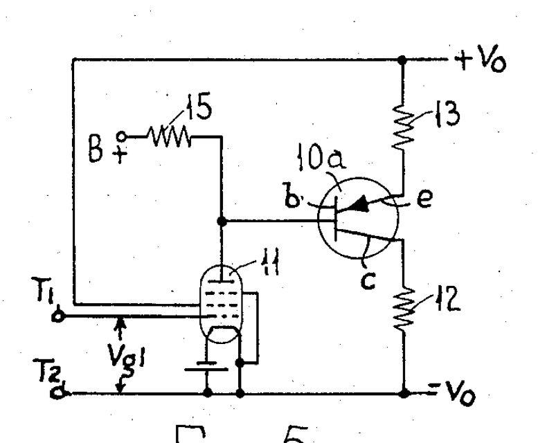

One more I found also expires soon
Ri non-linearity reflector. ;-)
