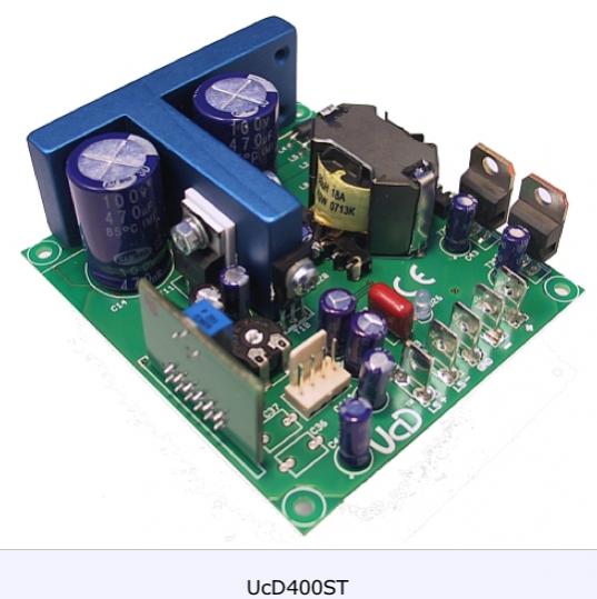

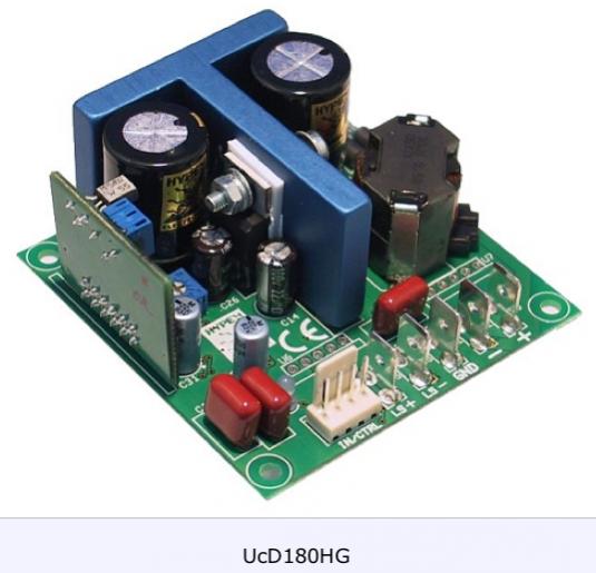

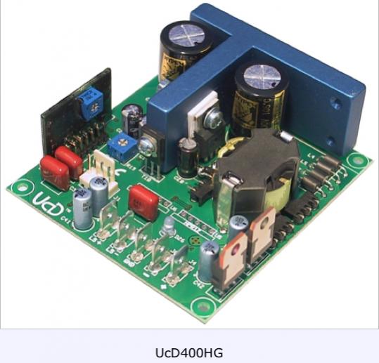

I've put together a power supply with a 300VA 35+35v toroid which I hope will supply either a UcD180 or a UcD400. About +-50v output - don't need much watts in a small room.
But I have the first version of the UcD400 - Ver1.0. This has a layout similar to the current UcD400ST shown below. The OEM version layout koifarm is using to remove the two caps is a different one - is this the UcD180 OEM? On mine removing the caps would be a nightmare, since there are lots of surface mount small parts underneath. So I'll have to leave it intact.
So a question about the hybrid version - which of these commercial modules can be used easily? On the HG versions there are a couple of red caps by the input - are these the ones to remove or what? Help please! I'm thinking UcD180 if I have to buy another couple of modules, but which version?
First picture is my original UcD400 Ver1.0, then current models

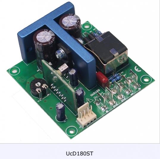

Andy, the first picture on page 1, 1 reply, you see the UCD180st. This board has the easiest access to the coppling capacitors.
Ronny

Can someone post pics on how EXACTLY to route, going from unbalanced DAC into the naked balanced UcD 180st with the bufferstage bypassed.
Thanks.
Thanks.
Just connect sheilding of the dacout to the white and copperwire on the ucdboard as in the picture above. And connect signal from dacout to the redwire on the ucdboard.
