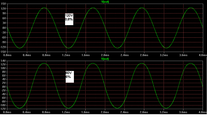

Had to go through the Hypex papers to check what is was all about. First of all if you go single ended into the + input Zin will NOT be 1,8k, it will be in the ballpark of 10k. This is great as 1,8k is not easy to deal with. To build a better tube interface you should go differential and use a transformer but that add costs.
Anyway, 10k makes things a little easier for the SRPP. Still with 60V i guess you don´t have more than in the ballpark of 0,4V on the lower cathode. If you also bother to check the link I sent you, it might be even worse....
When you go 120V, the SRPP will be able to take the needed input voltage for full output. Below is a simmed example that explains it all. You will get a nice wooly(compressed) THD(mainly secondorder) of over 5% at full output at 60V B+ but with 120V it will be well below 1%.
At 60V you will get in the ballpark of 2,5V rms below 1%.
Probably this is acceptable as the compression with higher input is what you need not to blow your speakers. And at usual listening levels you might be right about the 0,5% you spoke of🙂 .
To get the best performance out of 6N6P or 6N30 they need over 100V over each triode and 20mA.

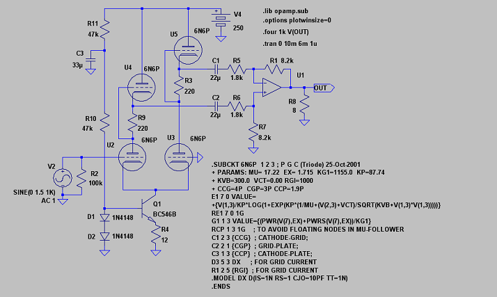

Hi Koifarm,
Hope you don´t mind me recommending a better driver for you very fine amp. The combination Redrock and Hypex seems to be a winner!
As I understand you like SRPP and you like 6N6P 😉. With this driver you will also have the possibility go balanced if you want.
THD will be low even at 400W/4ohm and probably well below 0,1% at normal listening levels.
If you want play around a little, I recommend downloading LTSpice from www.linear.com. I can then mail you the files and models you need.

Lars, i like to try the LTspice software. So if you could send me the files and models, Thanks.
I know there a lot of possibilities to drive the hypexmodules do not forget to ad a mute between tube stage and UCD. The UCD do not like any DC with occurs during tube warming up.
Just change the file name from *.txt to *.asc and open in LTSpice. You do not need anything else to try it.
You can mail me if you want other models or help.
Right-click on ".tran 0 100......" to get AC analysis or DC.
In "Transient" change 100m to 10m. 100m is only used in distortion simulations.
Right-click on "V2" to change input voltage.
Also note OPamp is ideal so clipping will not be there. Also note waveform voltages are peak.

Lars , thanks for the files and i played around with it.
The diff. file looks great. But when i use differencial input i do not need to convert from a sym. to sym. because my cd player has sym.out. But i must ad a second volumecontrol board.
The SE file does not work here, something about not reconising the LED.

Hi Koifarm,
I am the wrong computer at the moment. A LED can be added by pasting these models last in ...lib/cmp/standard.dio .
.MODEL REDLED1.7 D (IS=93.2P RS=42M N=3.73 BV=4 IBV=10U
+ CJO=2.97P VJ=.75 M=.333 TT=4.32U)
.MODEL REDLED2.1 D (IS=93.1P RS=42M N=4.61 BV=4 IBV=10U
I am not sure I follow your symm discussion, more info please😉 !
