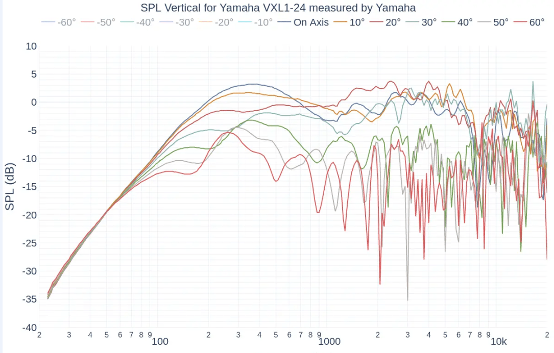

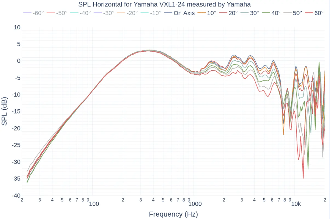

Something that made me feel a little better about how difficult it is for me to come up with working array, is how bad the professional arrays behave.
For instance, this is Yamaha's new line array. Look at how atrocious those polars are. The horizontal response varies by +/- 10dB!!
  • 2022-11-07 19_21_00-VXL Series - Features - Speakers - Professional Audio - Products - Yamaha ...png
