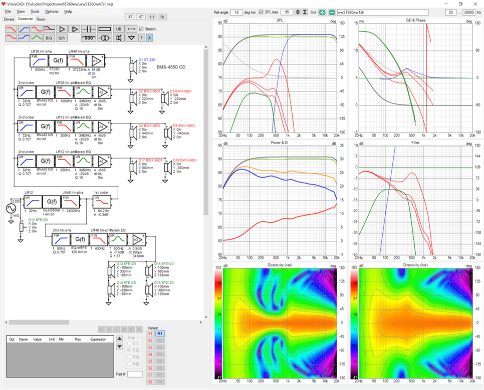

I think you could be well satisfied with a full range driver line array. I was with mine. I used a 2.5" driver for a wider beam than provided by the TC9. You could go even smaller using e.g. Dayton DMA45, a 1.5" driver. But an expanded array with cardioid bass also might work for you. This simulation shows Mabat's ST-260 flanked by 3 pairs of 6.5" mid woofers using DSP FIR XO. Those drivers from Misco have an Xmax of 10 mm so it will have plenty of bass. Its an active cardioid with side drivers placed vertically between the front woofers. I had a speaker with just 2 pairs of miscos on the drawing board and added the 3rd pair to improve the VDIR. The 3 pair version will be almost 2m tall. Too much for me but I don't have your problem. Above one khz the beam widens to where it likely hits your MBR wall but 1 khz ++ is easy to absorb. The 2nd attached file is the simulated VDIR of my 32x2.5" driver line array. You see the cardioid expanded array does a better job in the low end but is narrower up top.

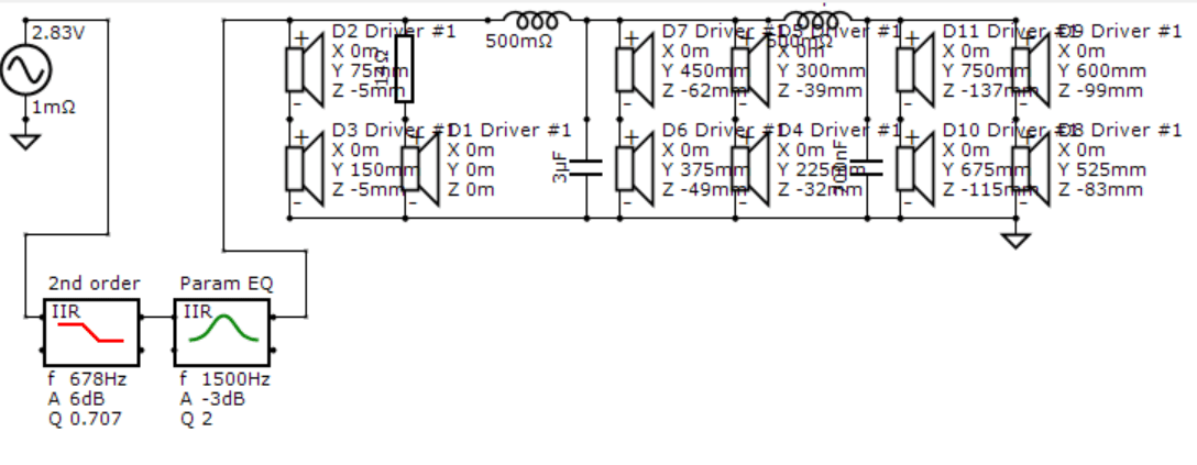

I figured out "point number four" in post 24. Basically VituixCad considers a negative Z value to be closer to the listener, and I assumed it was the other way around. So the passive xovers are behaving as expected, I was just reading the locations backwards.

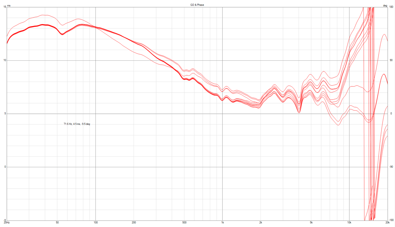

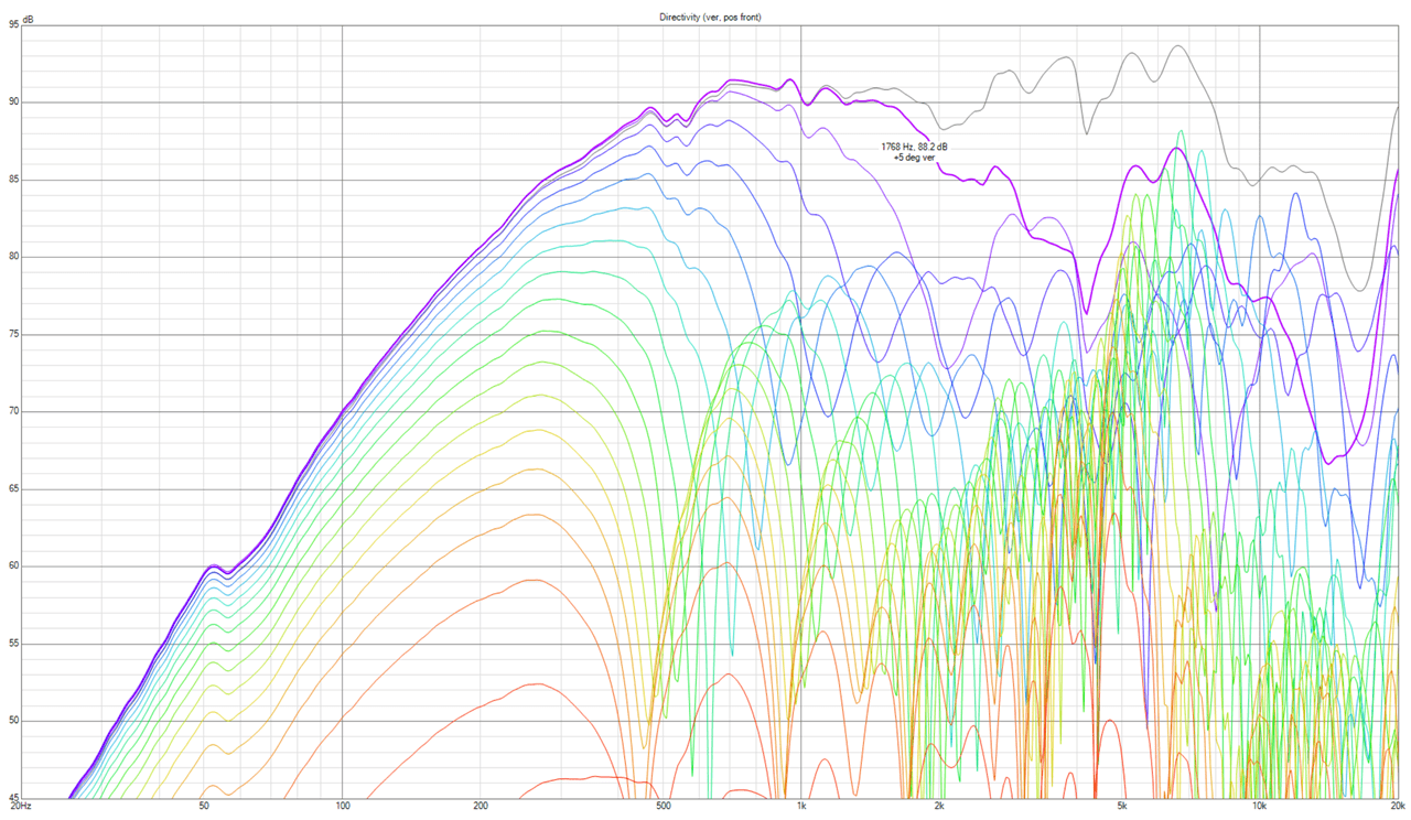

Attached is the horizontal polar response of a focused array, the vertical response, the phase response, and the crossover.
Crossover is quite simple - this is important to me, I hate making crossovers. Crossover is hybrid (active EQ and highpass) / (passive filtering and delay via the use of inductors.)
The entire crossover is two inductors, two caps and one resistor.
It's largely inspired by the JBL CBT crossover here: https://www.diyaudio.com/community/threads/passive-loudspeaker-delay.280664/post-4473934
The zip file includes the frequency response files, impedance measurements, and the VituixCad project.
This is a dipole, that's why the horizontal polars are so pretty...

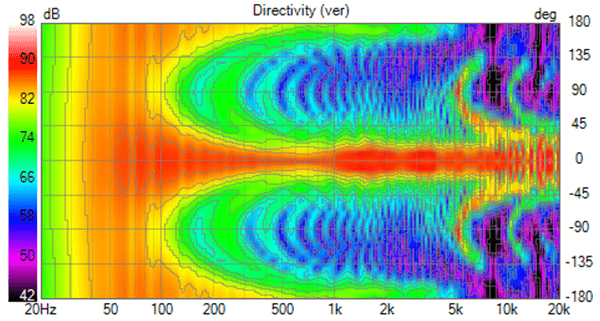

Less than 5 degree vertical window?
I did some sims of a conventional CBT array, and it has a much wider vertical beamwidth, but the phase is a mess.
I guess the challenge is whether you want a wide vertical window or pinpoint imaging.
Tom Danley and I discussed this a few months back, in regards to his new speakers. Basically, both speakers were well received, but some preferred the pinpoint imaging of his new point source horn, while some preferred the spaciousness of his Paraline based speaker.
It really depends on the recording, IMHO.
That's them. Lots of ways to arrive at the same sort of result but for stopping sound going up a long vertical spread of the drivers is a simple answer.
A zero degree vertical windows is what's really needed.
