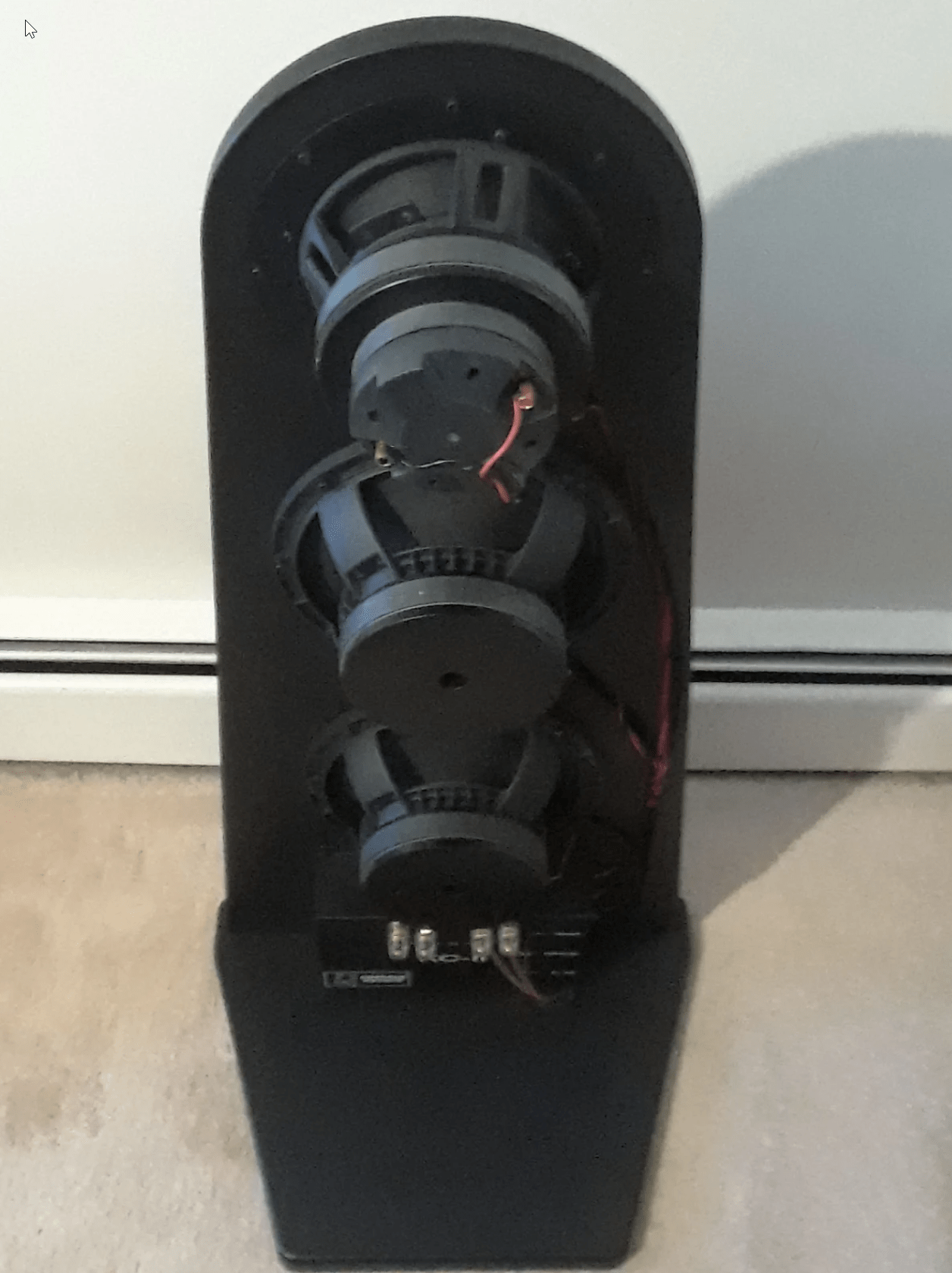

Based on my experiments with cardioid boxes, they really seem to excel in small volumes. Basically use a driver that's 4X as big as you normally would, in an enclosure that's very small.
Similar to Emerald Physics, but Cardioid
interestingBased on my experiments with cardioid boxes, they really seem to excel in small volumes. Basically use a driver that's 4X as big as you normally would, in an enclosure that's very small.

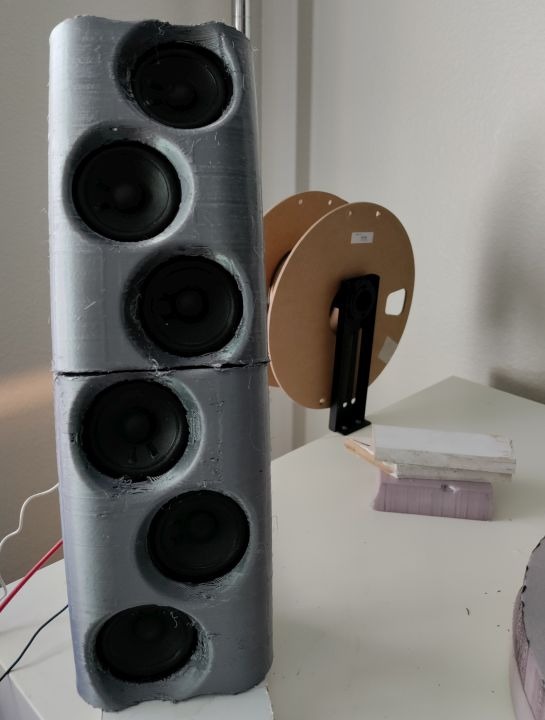

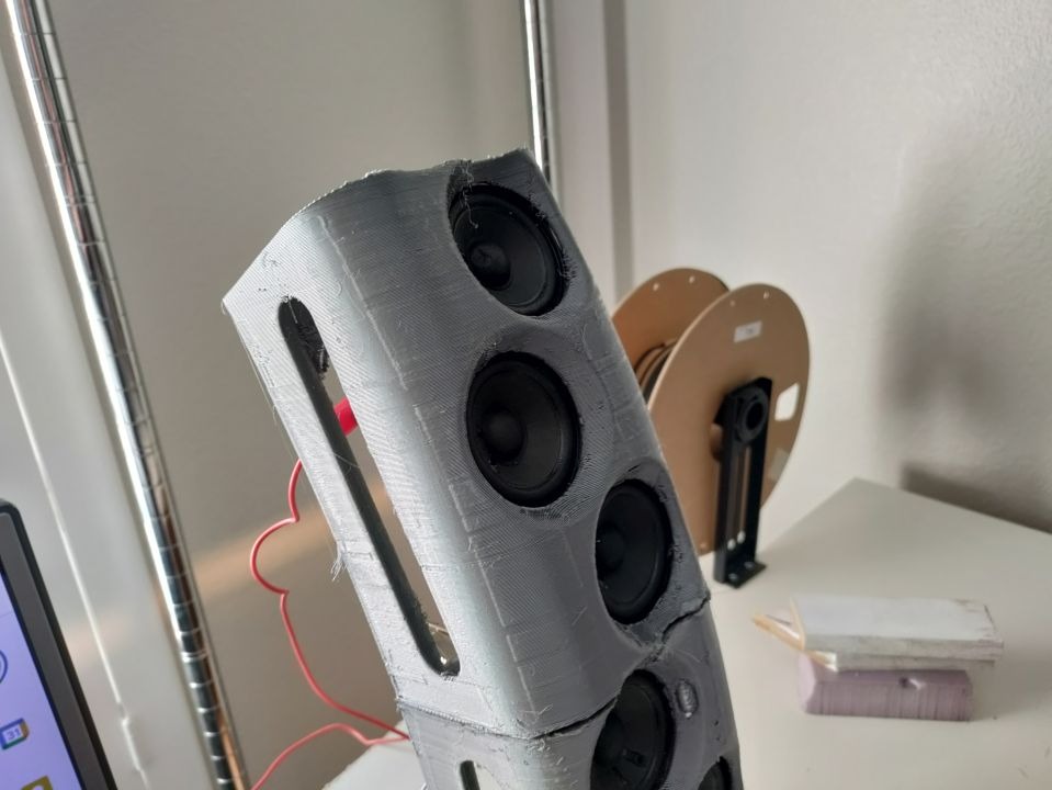

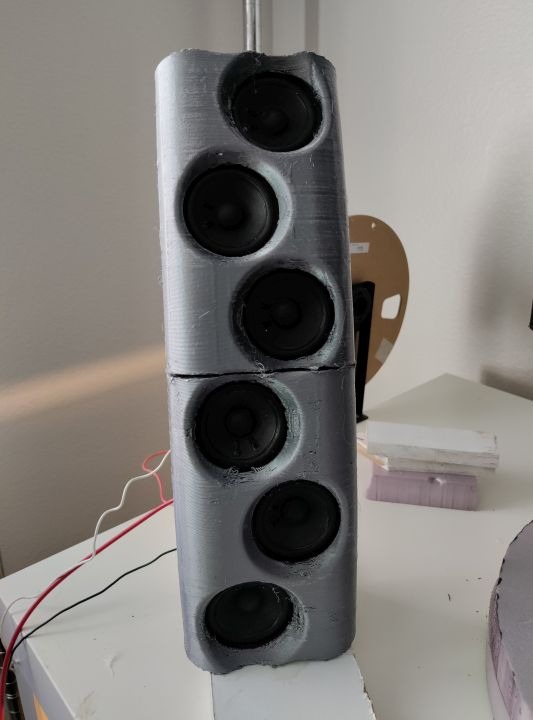

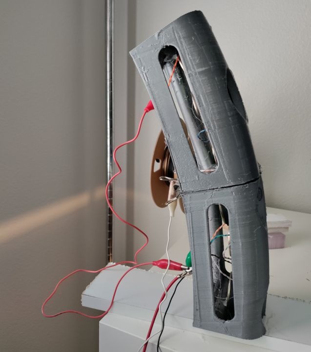

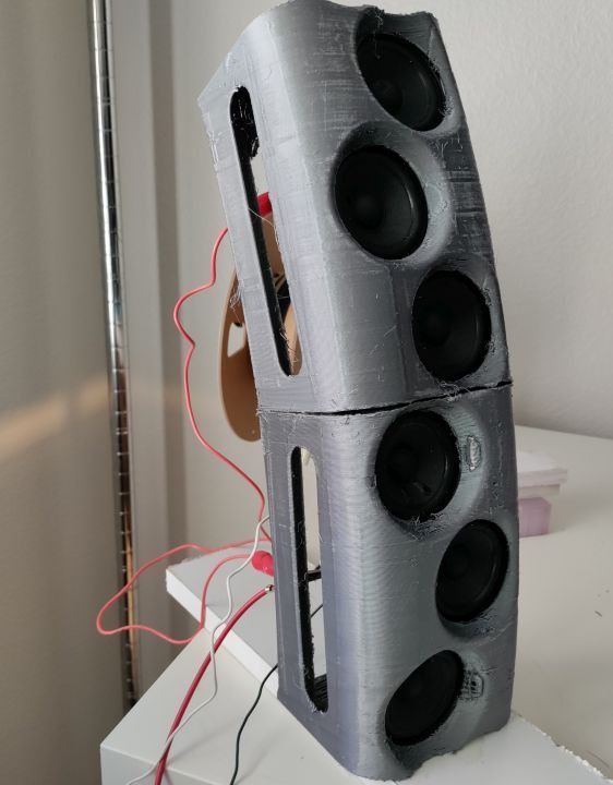

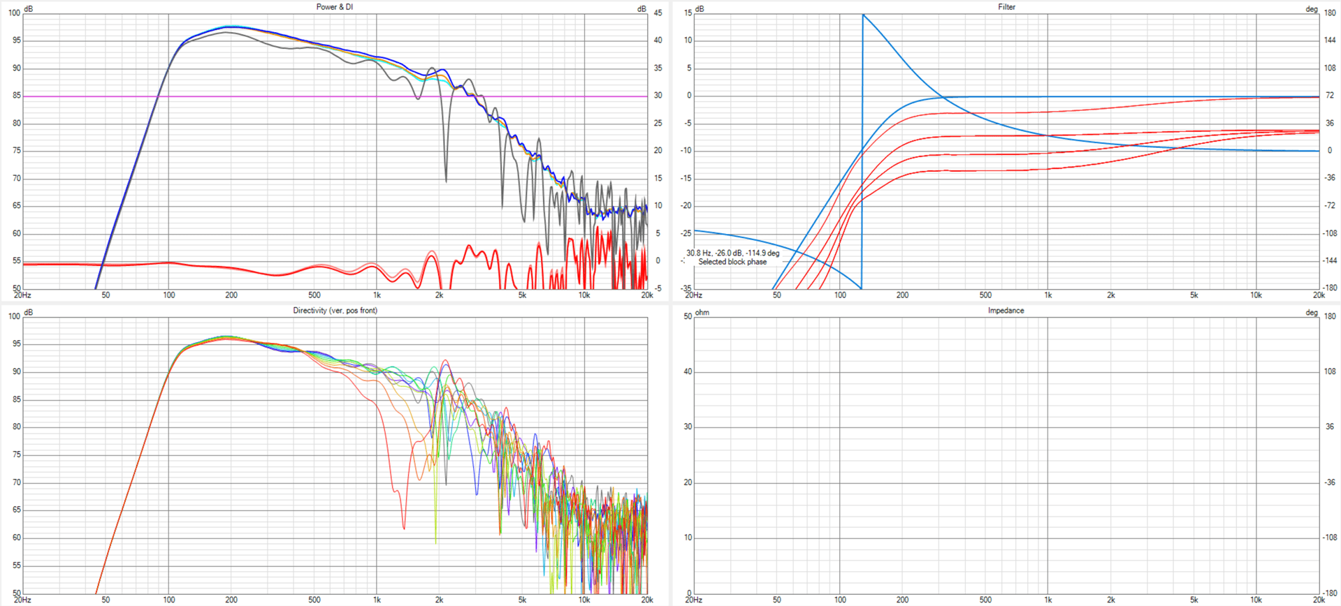

Since I'm generally not a big fan of arrays, I decided to build something extremely cheap.
Basically I didn't want to invest $400 in parts, only to find it sounds bad.
Here's what I came up with.
The cost of these is hilariously low.

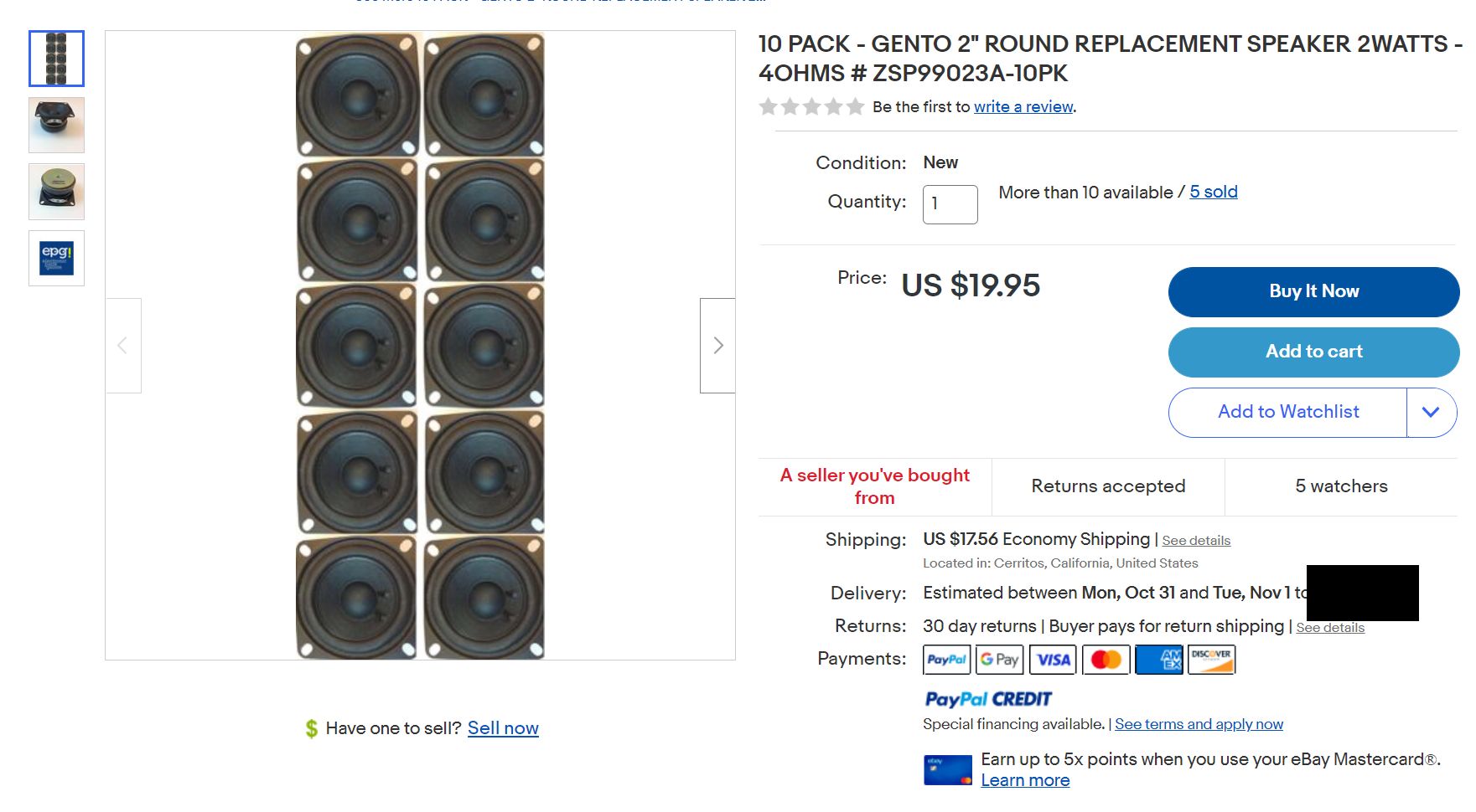

Drivers are two bucks each. (Same midrange as Bill Waslo's Cosyne horns)
You can get them from eBay
Each segment of the arc has three woofers
The cost of the filament for each segment is five bucks
So you could make a six driver array for $22

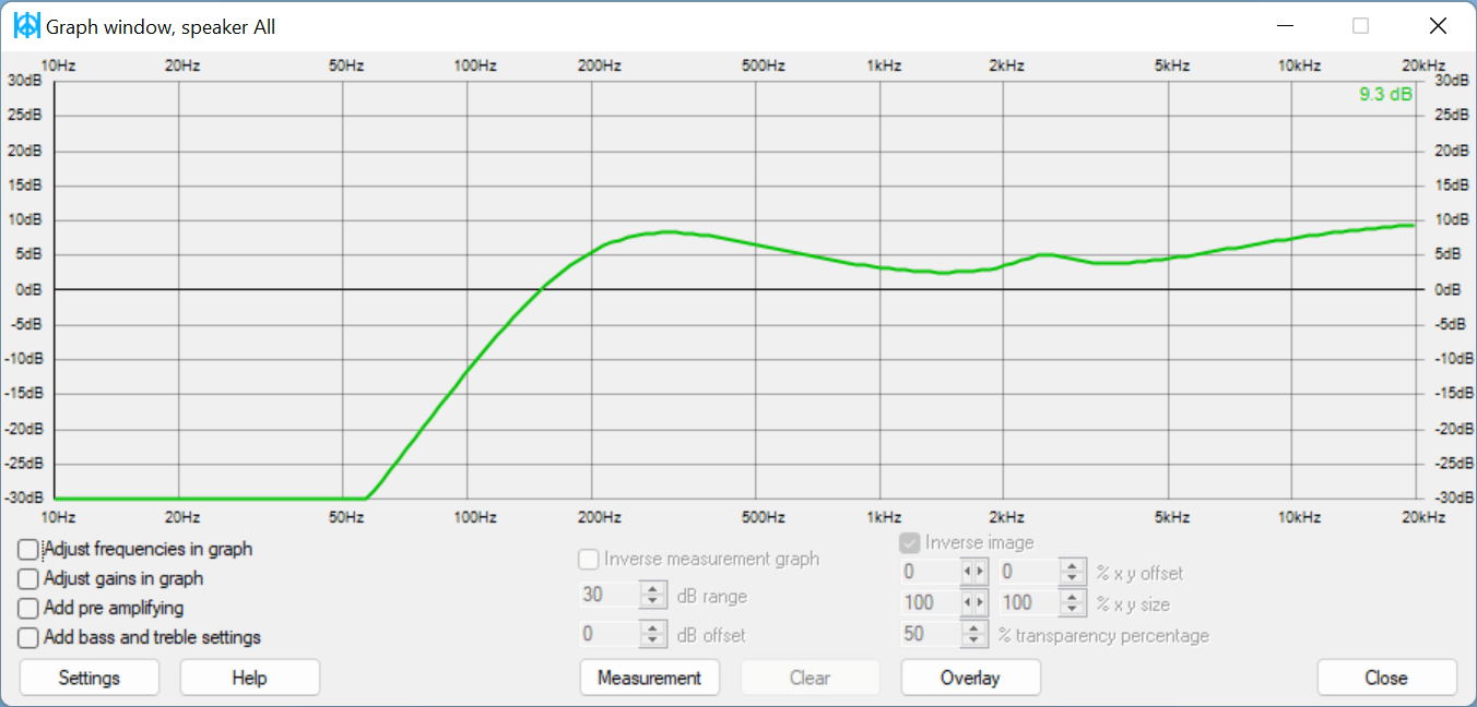

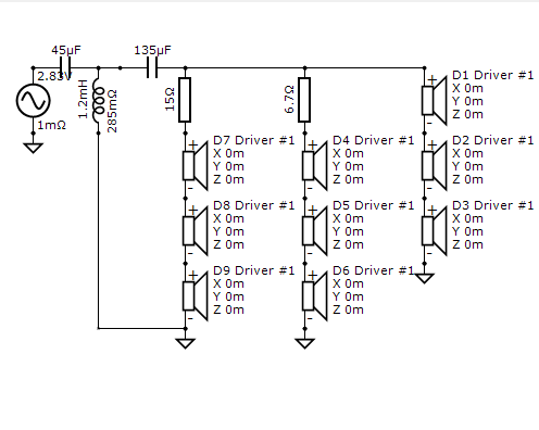

Here's how the frequency response looks with a fairly wonky network.
Basically the lowest driver in the array is getting full power, the two above it are wired in series with each other, and the three above it are wired in series with each other.
And then the three sets described above are wired in parallel.

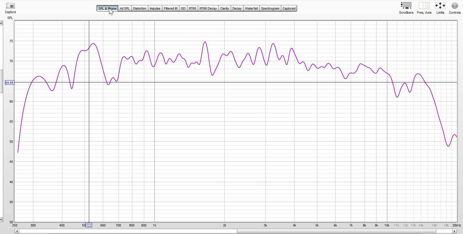

The response is much better than I expected.
This measurement was done under the crudest of circumstances, I just set the mic up on the desk of my office with the speakers set on top of my 3D printer about two meters away AND quite close to a corner. Far from ideal.
This isn't the final crossover, but gives you a general idea.

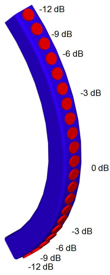

Basically the resistors are used to power taper things to achieve something comparable to Keele's CBT shading and the crossover in front of the array is there so that I can cross the array over to a woofer.

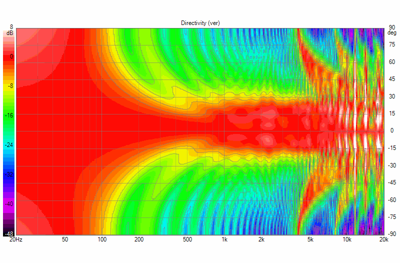

Based on the comments in post #54, I tried make something CBT-ish, but only for low and midbass frequencies.
The idea that I had, was something comparable to a "sub / satellite" system, where directivity above about 700Hz would be controlled by a waveguide, and directivity below 350Hz would be controlled by the shape of the array.
I found something that I think is kind of interesting. Basically the geometry and shading of the array led to a design that's close to omnipolar.
That might sound uneventful, since subs are omnipolar in general, but this particular design measures nearly one meter tall by one meter deep. So one would expect it to be directional above about 340hz. But it's not, for the most part. I think the reason for this is because the geometry is so curved - 90 degrees in total.
So I'm going to take another crack at it, and this time use a narrower arc, perhaps 45 degrees instead.
The third pic below is the exact same array, but measured from the BACK instead of the front. Basically illustrating that the CBT concept widens the beam in FRONT of the speaker and narrows it BEHIND.

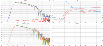

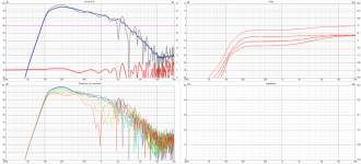

I tried narrowing the angle of the array, in order to narrow the beamwidth. Results weren't really great TBH. I think that the shading of the array creates a situation where the beamwidth control collapses at a higher frequency than you would expect.
Basically -
In an array that's not shaded, the beamwidth control extends to about the size of the array. For instance, if you have an array that's two meters tall, and it's unshaded, it will control beamwidth down to about 170Hz. (sound travels at 34,300 centimeters per second.)
With this shaded and curved array (CBT-ish) the beamwidth control only extends to about 350hz or so. Basically, the array would need to be four meters tall to control directivity down to 170Hz.

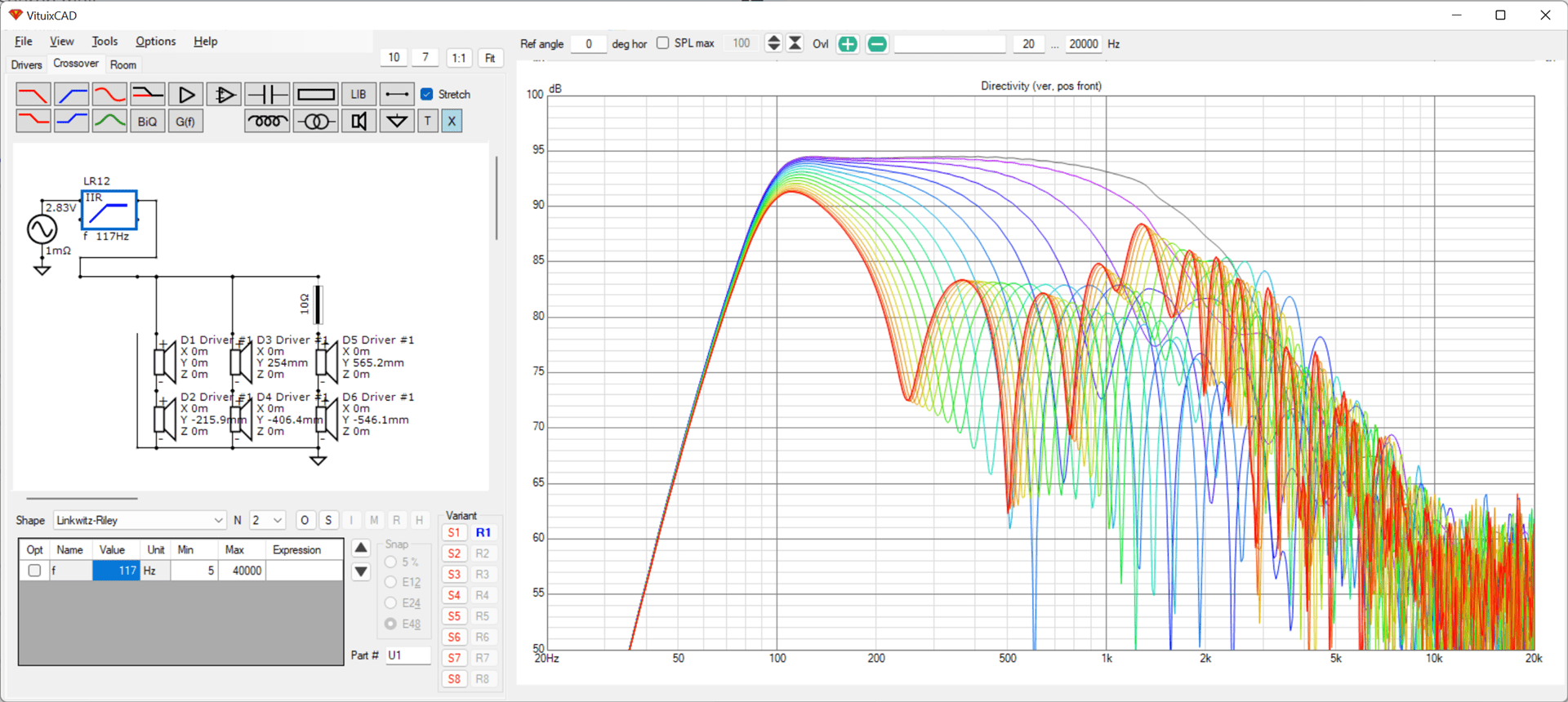

Here's the response with no lowpass crossover
Here's the response with a 2nd order LR crossover
Basically -

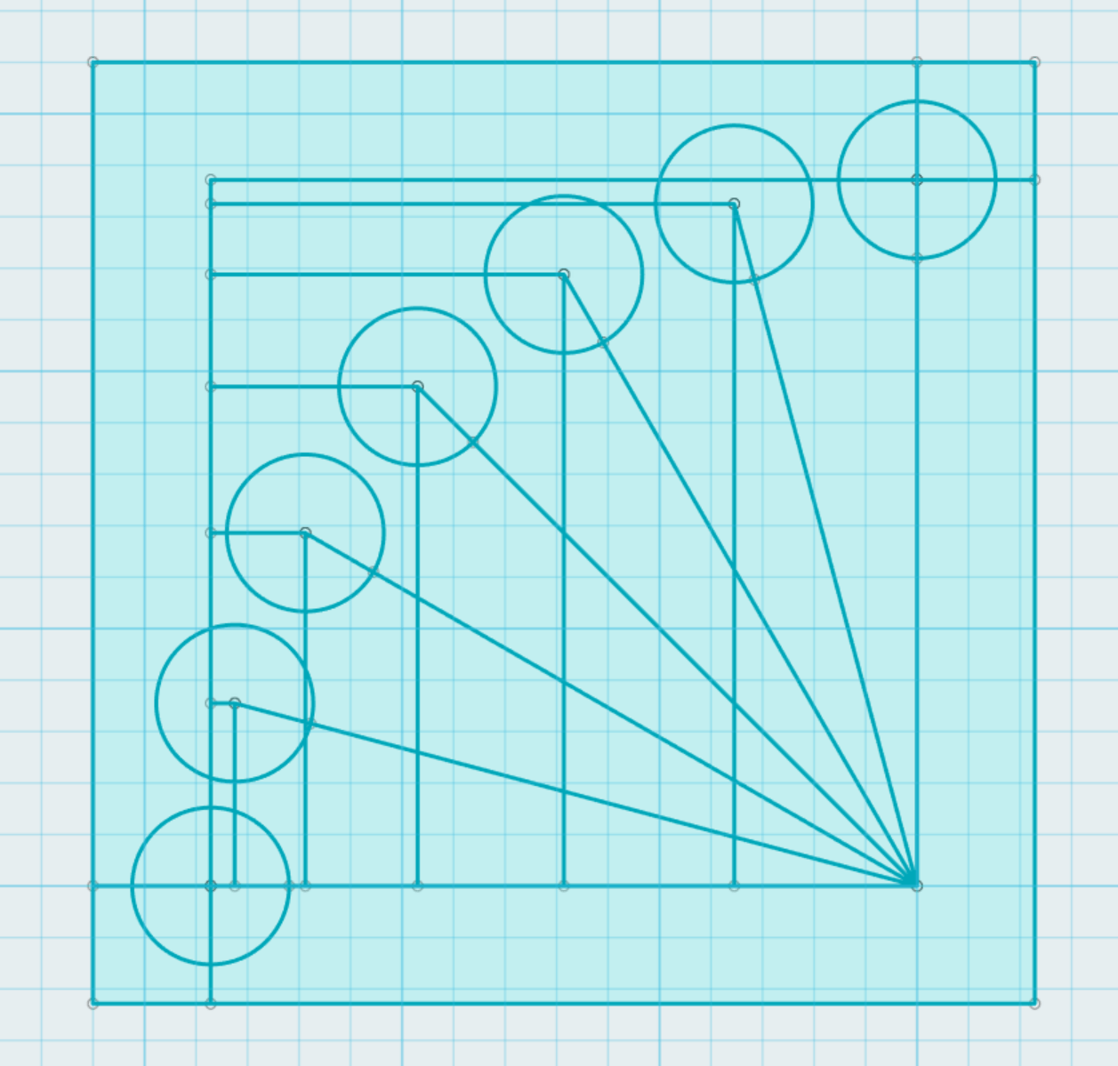

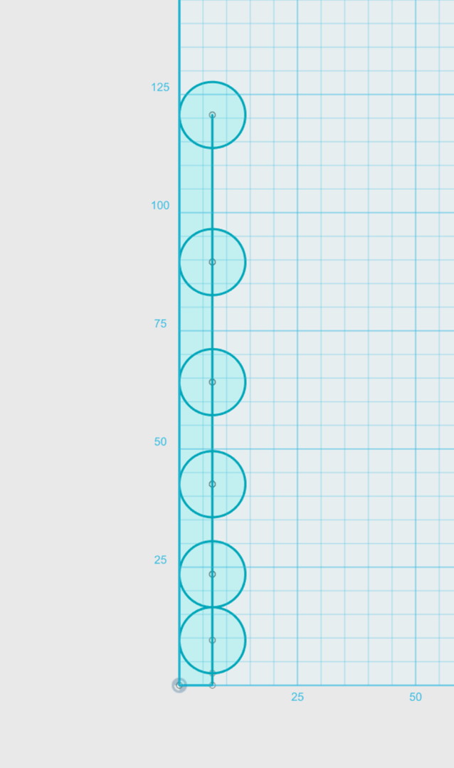

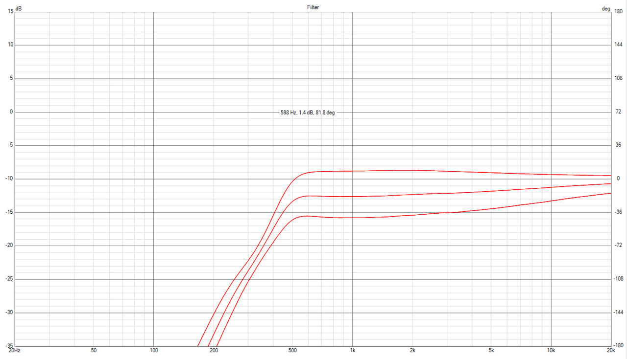

Here's how things look with a log spaced array. I think this is better. It's much easier to build (because the baffle is flat) and the directivity control works over a wider beamwidth.
The CBT array seems to offer WIDE beamwidth over a wide bandwidth, but what I'm looking for in NARROW beamwidth.
But I think I can improve on this a bit, by curving the array electrically, via the crossover network, similar to JBL's commercial CBT speakers:
https://www.diyaudio.com/community/threads/straight-line-cbt-array.254402/

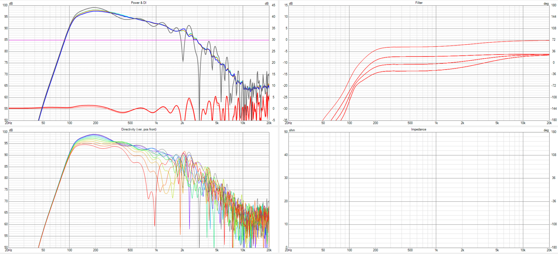

Comparison between an unshaded straight array and a frequency shaded straight array. The frequency shading means only the higher frequencies are shaded, the bottom end still has full power on all drivers. I don't know about you, but that's what I would be looking for if I were in your shoes... 🤔
I'd want that vertical beam, to send as little energy as possible to the floor and ceiling...
Hardly any change between these two on the low end, more consistent beam in the shaded array.
