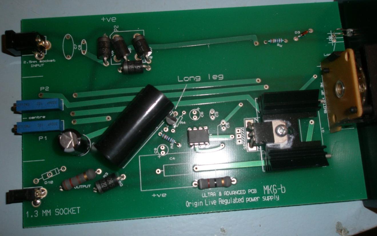

I thought the same. But no, I wouldn’t recommend to get that one, in fact I am going to post pictures I found on the web of the PCB so that you can understand what I am talking about!

Here are the pictures as promised. I found them on internet and I was pretty shocked!
Note that the heat sink used on the BJT is not even the right one as that is a stand up type of sink, but they threw whatever they had in there to fit the small package size.

It looks like the OL circuit is just a linear DC regulator. This will provide some stability, but a proper DC motor controller will need to monitor the motor current and provide some a negative resistance feedback as Mark Kelly suggested.

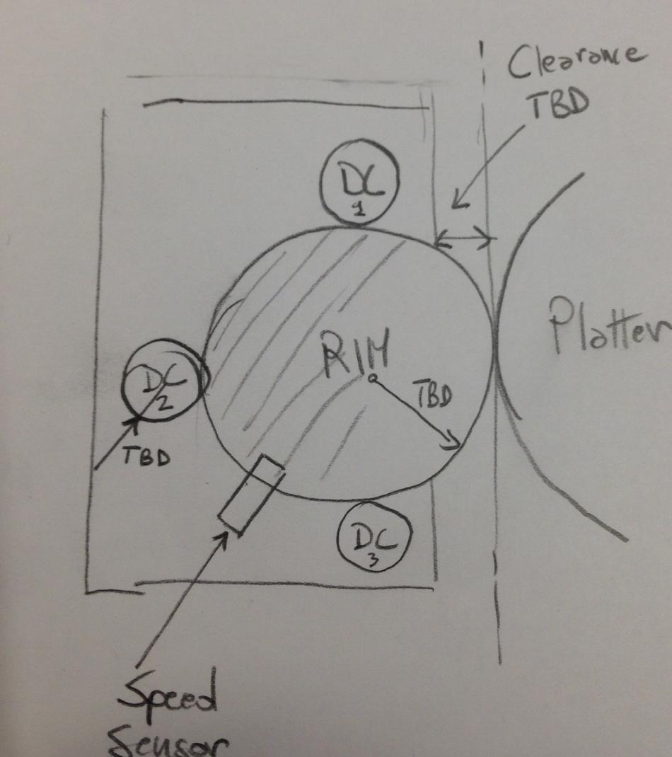

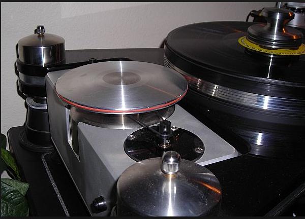

Idea is to get something on the form factor of this in picture (we all know that 🙂 ) but directly powered by the new DC motor system instead of dumb 2 AC motors in flywheel configuration.
Can you get a box like that and a pulley similar to that done? Do you have these capabilities?
As far as dimension you will be provided with all the physical dimension including dimension of box, holes, height, pulley dimension etc etc, but then the design concept has to turn into physical model 🙂
EDIT: the enclosure obviously will be a pod and not a box. But I will shortly post a design idea I have, I would like people to comment on it.
And here is the extended idea (you guys should know that if I engage and start something I will try to do it the best it can get!)
This arrangement should provide more torque, more uniform rotation and less vibration because the pulley in touch with the platter is not in direct contact with the motor.
It will however will be harder to manufacture and a much harder to design a proper control for it (especially a suitable PSU software won't have to change for now...it could get much more fancy and advance from a control standpoint, but I don't think it is necessary for the application). :sax: :sax:
