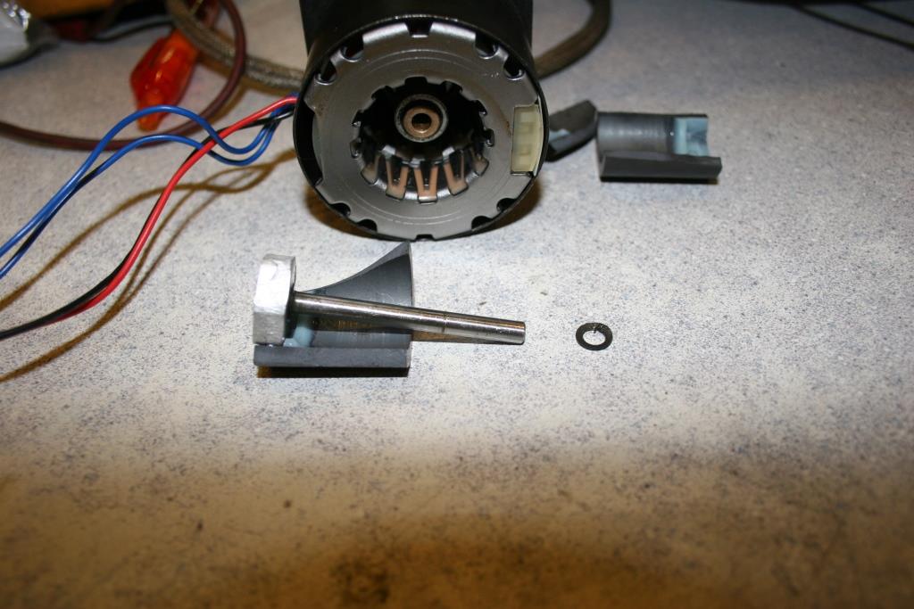

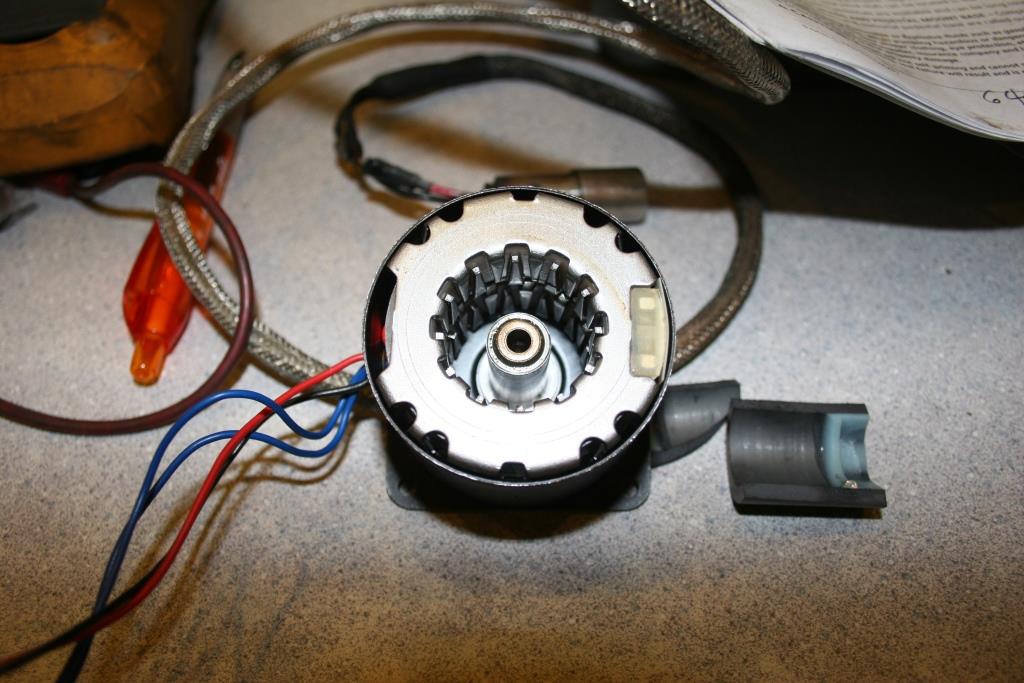

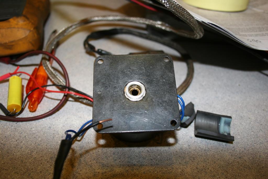

Here are the pictures of the original Hurst motor Autopsy from the other thread. I took this motor apart to try to identify the audible noise coming out of the motor from the shaft to bushing interface (not through the cartridge pickup).
One of the difficulties of working with this motor is that the top retaining washer, or thrust washer, it hard to access since it tends to sit down in the pocket of the bushing retaining sleeve. We removed the shaft and washer by driving the shaft out with a hammer which broke apart the magnet on the shaft.

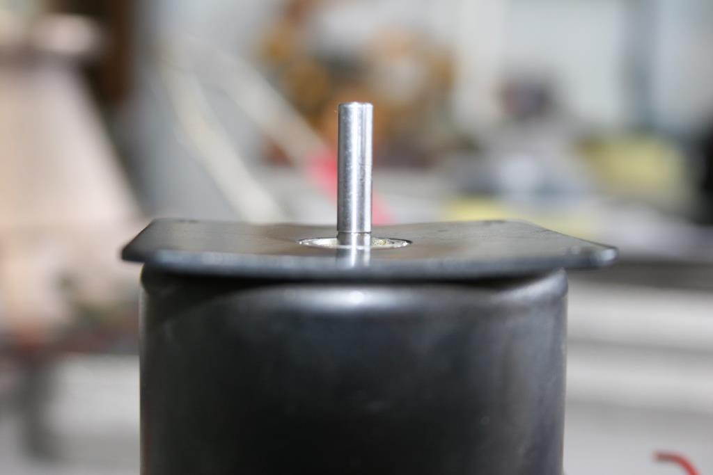

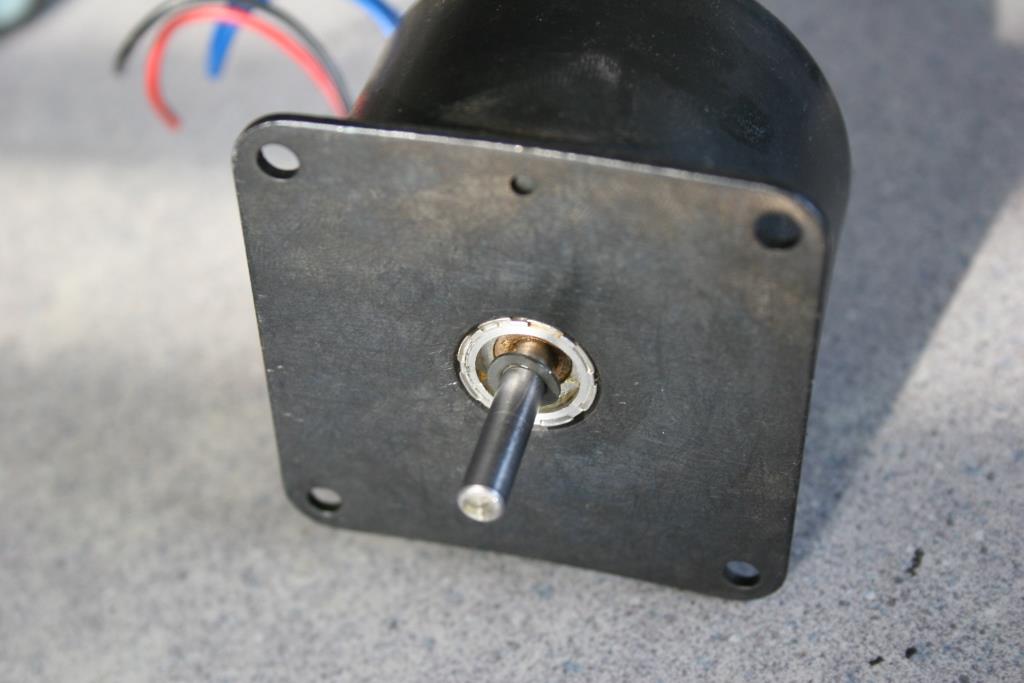

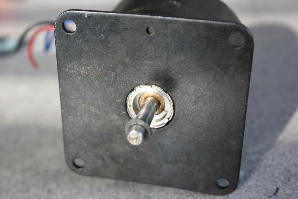

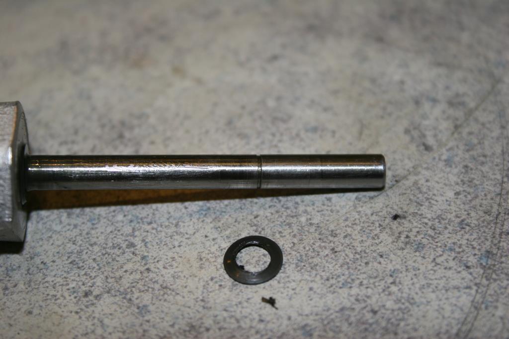

To get a better look at the longitudinal play of the shaft as retained by the two thrust washers on either side of the single bronze bushing I turned down the bearing retaining sleeve to get a better look at the top of the bushing in relationship to the retaining washer. I installed the motor shaft and pushed it till the thrust washer made contact on the bottom of the bearing sleeve. You can see there is a significant amount of play allowed between the top of the bushing and the top washer groove where the top retaining washer sits. I believe this causes the audible chatter.
I could only speculate that possibly the motor rotor is supposed to find it's "home" in the magnet field of the armature and that this play is by design. Or, I don't know.
With this particular motor it would be difficult to eliminate this play since everything is press fit together.
But, if someone wanted to disassemble this motor they should First remove the motor cap which is fairly easy to pry off. Then push the shaft up into the bushing. This might expose the top retaining washer such that it could be pried out of it's groove then the shaft is easily pulled out of the bushing.

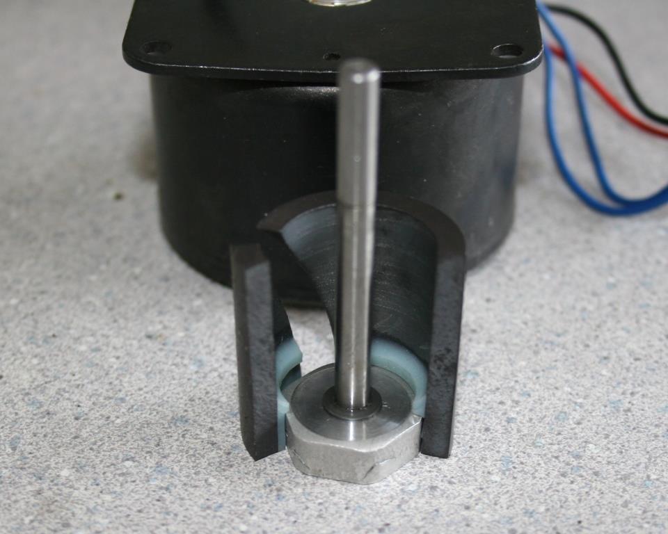

Regarding lubrication of this particular motor. I believe this motor should be easy to lubricate with whatever lubricant you like. For example oil, grease, whatever. There is significant clearance in the bushing and "pushing" grease or oil down into the bushing from the top should not hurt the motor. Notice that the shaft and magnet assembly tends to form a "cup" that would catch excess oil or grease or whatever. A thicker oil or grease might eliminate the audible chatter found in these motors and therefore almost all VPI TT's. Lube at your own risk but IMHO this motor would like some heavier weight lube.
So oiling the motor would be fairly easy but make DIY mods would probably not be doable. Too bad.
