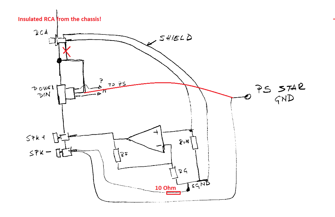

I have a question about the ground lift resistor. Maybe this is the right place.
•When both input and feedback ground are lifted together through a 10 ohm resistor like shown in post #41
•and the preamp is earthed.
Now isnt the lowest impedance path from the feedback resistors to the negative speaker terminal going through the earth wires?
Should this path from the feedback resistors to the speaker terminal not be as direct as possible?

Yes it does, even worst it goes through RCA shield, via signal device, its power cable , wall socket and back to this amp in question via its power cord.... Nice route to connect speaker return and amp feedback, but this path still has less impedance than 10RNow isnt the lowest impedance path from the feedback resistors to the negative speaker terminal going through the earth wires?
Yes, and you are thinking right!Should this path from the feedback resistors to the speaker terminal not be as direct as possible?
Do the benefits of a ground lift resistor remain if only the input is lifted and Not the feedback ground path?
I suppose is would still help breaking earth loops
Some people put 10 ohm and small capacitor between RCA and chassis, at place where jx put red X in post #41.Do the benefits of a ground lift resistor remain if only the input is lifted and Not the feedback ground path?
IMHO what I drow is best, post #39, hard wire to chassis. If you leave resistance in, voltage will develop over it and it is directly at your negative amp imput (aka SGND). Capacitor will short RF, but not 50Hz. Read 2 papers posted in #3

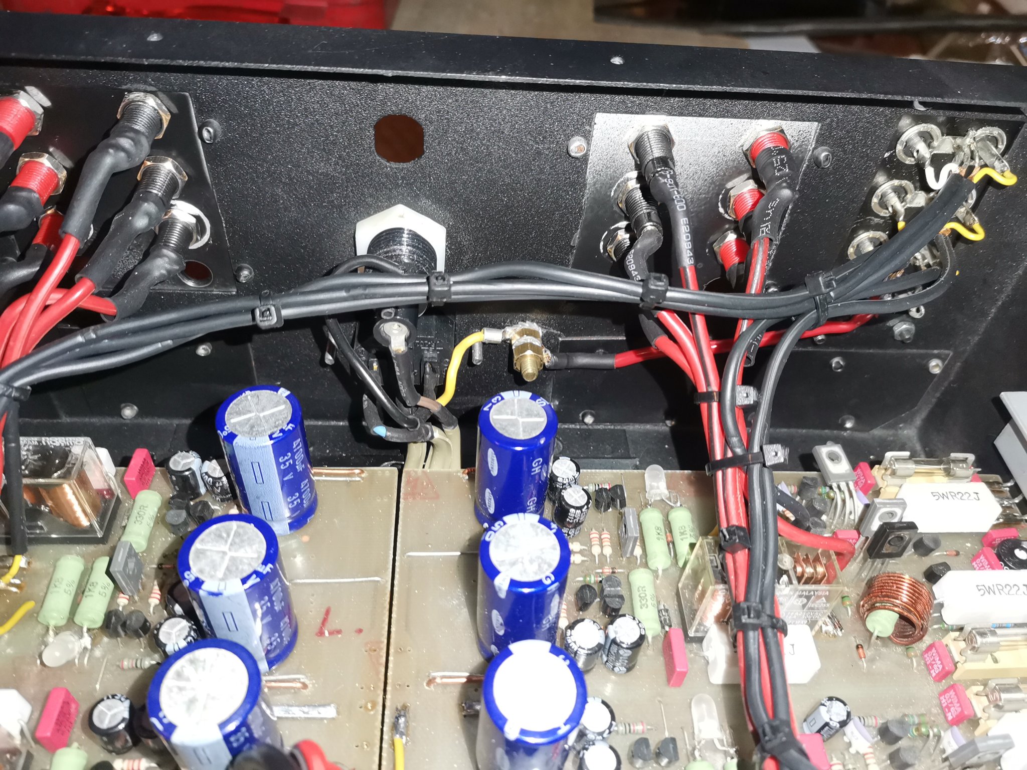

Yes, sure. I posted pictures before and after rebuilt here
Hi, It took me a while to find free time for audio, and than I went to finish one thing that was occupying my desk. So happy something is brought to an end 🙂 .
It is this PA 6 channel amp that I bought very cheap (2 of them identical) and the idea was to use it with DCX as speaker development tool.
I thought just to rewire it a bit as it was horribly noisy, but I ended up changing everything except PCB's and chassis (and they were very much modified too), I think over 40 mods altogether. On the picture below; to the right is original, and to the left an unit that I finished with. At...

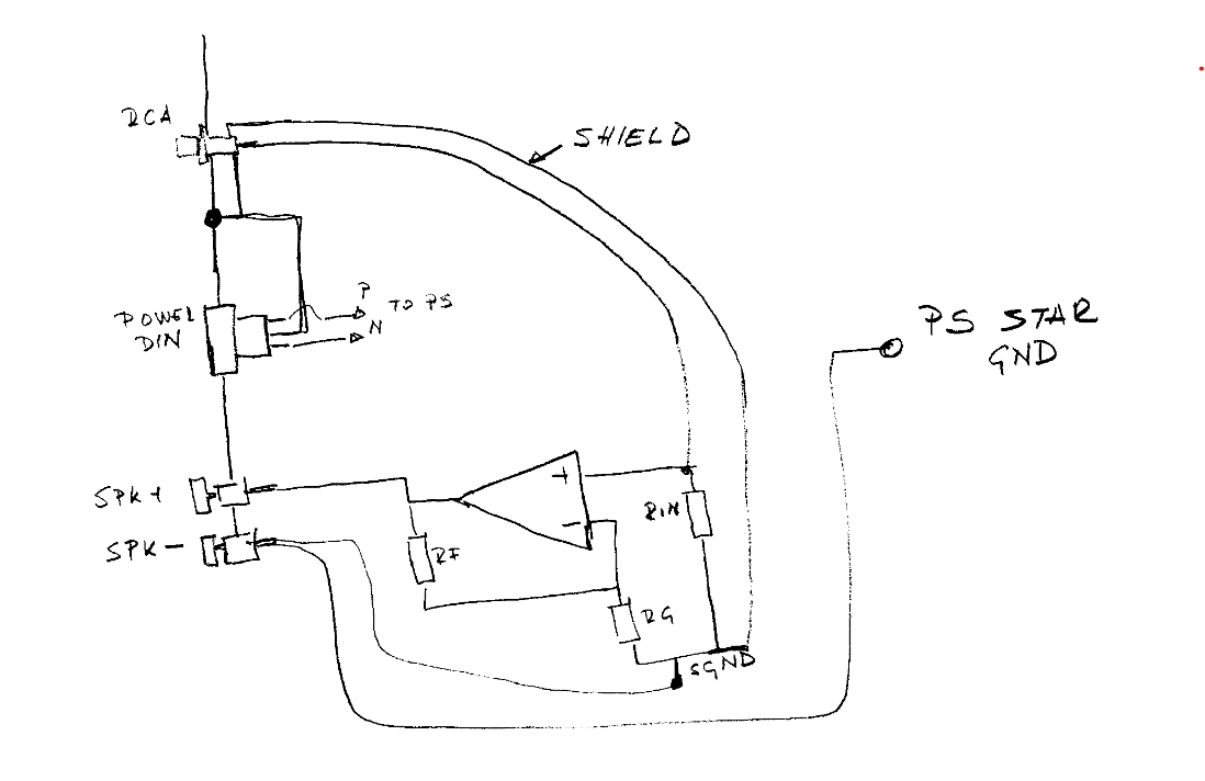

Here is what I do with them, as example last year I rebuilt 6 channel - dual power supply (cant get more complicated than this) from horrible hum to total silence. Once I will make small thread about it as many mechanical and wiring issues are shown there, still no time from my side.
This my raise some eyebrows as it is not how most people do it, sketch diagram:
All RCA connectors grouped together (not at each end of amp as some do) and its shield (ground) connected to the chassis as soon and as solid as possible.
Power input ground connected to the chassis also as soon as possible, at same place where RCA-s are grounded (if possible).
This will allow dirty ground signals to be shortened asap, without leading their ways into the electronics.
Input cable (coming from RCA) goes to amplifier; signal wire to + input, shield to SGND.
SGND is small point where Rin and Rg of feedback network connect . (this is simplified schematic without feedback condenser and other things)
Now we need to connect this SGND to system PS GND somehow, I take it from speaker negative terminal as this is where we want to measure feedback voltage, this reduces THD a bit too.
Speaker negative terminal is finally connected to properly built PS central ground. (by properly built I mean trafo- rectifier- capacitors and PS ground taken at the end of this chain)
Safety ground is connected to chassis directly, and to PS ground via input cable shield (I have 6 inputs , so plenty of cable surface for safety, cable with thicker shield can be used if anyone is concerned for safety) and than speaker - wire (this one is thick). There is no loop and chassis is extended shield.
Feedback is connected directly to speaker, where it belongs.
No ground lifters, no lifting resistors, ground insulators, and no hum.

Hi, this wiring I learned from pro gear, studied a lot while fighting dreadfull hum. All my early DIY amps had some hum. Then switched to differential and forgot it. Than started playing with some single ended rebuilds and rediscovered hot water.This looks like a similar technique to the one Douglas Self discusses in one of his books. You still have to take care of loop area issues and common impedance coupling on the PCB's etc, but it seems it produces good noise results based on what he said. I have not tried this myself BTW.
Yes, Douglas Self is using it, and it does work, with lots of care how to rout cables and separate PSgnd (for decoupling caps and eventually spk return) and SGND on pcb.
SGND is just point of connection between Rin and feedback resistor (or capacitor) to input cable shield and spk return, should be easy to separate it from PSgnd

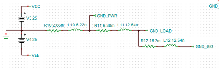

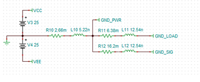

the schemes presented in the link above are "star" and "buss"
with "buss" you can choose in which order to return to psu
the schemes that are shown here and elsewhere only show a single amplifier - the problems start when you wire up 2 or more channels
