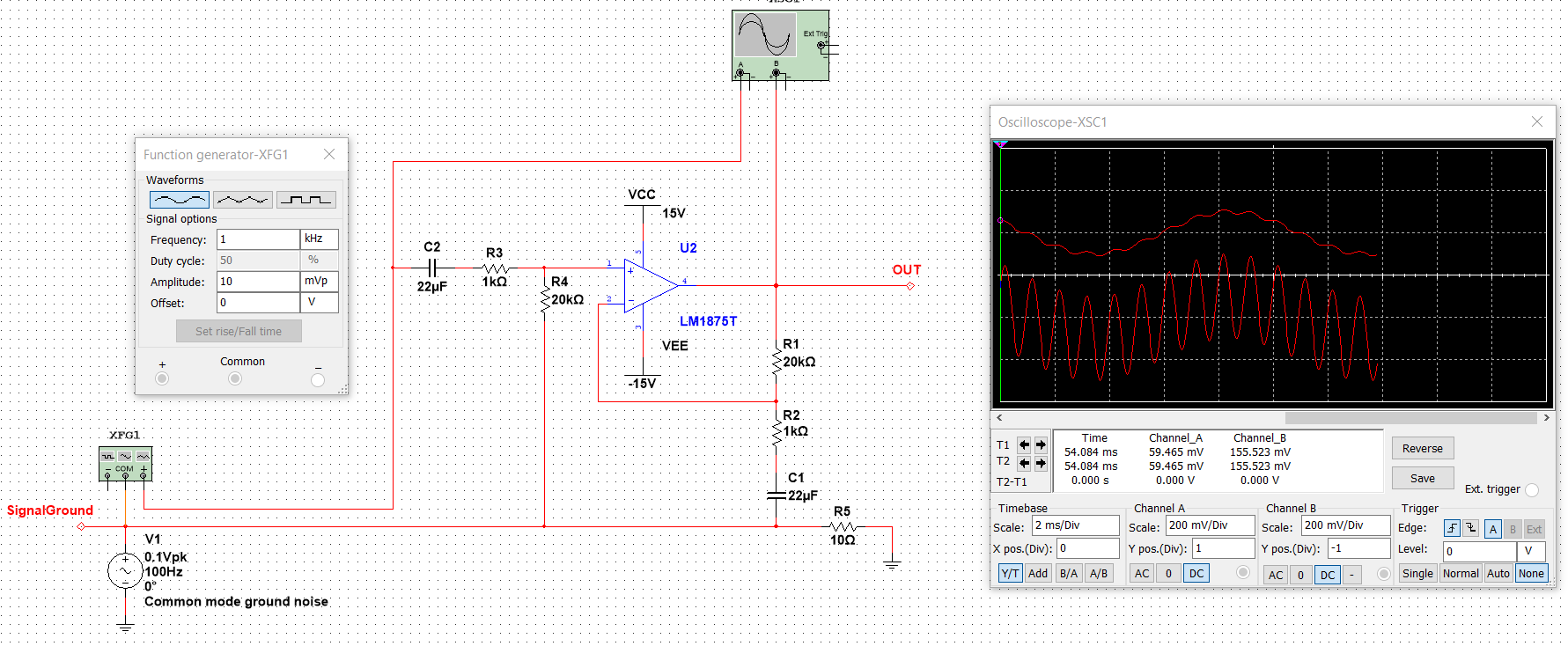

Hi @Drbulj
Here is what I would do.
There are benefits that let the signal ground floating.
1. It breaks the ground loop.
2. The ripple on the remote signal ground helps the amp cancel out the same ripple on the +input. If you shunt signal ground to earth, you only got ripple on the +input. That will cause the ripple got amplifiered.
Amp that I showed previously had diagram like this, with 10 ohm "lifter" and it hummed like fridge.
10 ohm is also effectively added to resistor Rg. Now SGND, a feedback correction point, sees more of dirty signal from source ground than from speaker return (what it should measure)
Dirty ground signals and ground difference potentials now must pass through SGND and will only cancel if the same dirty signal exists in signal wire, but signal wire is shielded, and shield is not... Than better use twisted wires on RCA cable, no shielded cable.
It is not always floating because in single ended source (I assume also source device is single ended) this ground is attached to safety earth and is making ground loop via power cords (this if source is Class1 device , grounded one), just this time via sensitive SGND and not through chassis as I drafted. This diagram will be good if source device is equipped with transformer or transformer - like circuit. Than we are back to differential topology. Could also be not to bad if source device is not grounded through power cord (class2 device) . Many are like that so it could work. But too many if-s.
Ground loops we cannot avoid unless we use class2 devices without safety earth (and open bigger can of worms). Differential topology is right way to get rid of it. But if single ended RCA must be used (whomever invented it should be charged for waste of time of millions 🙂) only way is to avoid these dirty loops going through 2 nodes of amp input, signal and SGND. Better to channel them through chassis.
Anyway, do it as you propose, but I believe with some sources you will still have hum, with others not (like battery powered, or class 2 to lesser extend). Plus 10 ohm lifter will slightly degrade THD.
I have a question about the ground lift resistor. Maybe this is the right place.
•When both input and feedback ground are lifted together through a 10 ohm resistor like shown in post #41
•and the preamp is earthed.
Now isnt the lowest impedance path from the feedback resistors to the negative speaker terminal going through the earth wires?
Should this path from the feedback resistors to the speaker terminal not be as direct as possible?
Or am I thinking about this the wrong way?😂
Reactions: Drbulj
Yes it does, even worst it goes through RCA shield, via signal device, its power cable , wall socket and back to this amp in question via its power cord.... Nice route to connect speaker return and amp feedback, but this path still has less impedance than 10R
Yes, and you are thinking right!
Do the benefits of a ground lift resistor remain if only the input is lifted and Not the feedback ground path?
I suppose is would still help breaking earth loops
Some people put 10 ohm and small capacitor between RCA and chassis, at place where jx put red X in post #41.
IMHO what I drow is best, post #39, hard wire to chassis. If you leave resistance in, voltage will develop over it and it is directly at your negative amp imput (aka SGND). Capacitor will short RF, but not 50Hz. Read 2 papers posted in #3

This only works well when the signal source is floated. It could not mitigate ground noise if the signal source is also grounded.
Also, gain loss won’t be necessarily translated to THD. If you have output inductors, you’ve got gain loss anyway.
It pretty much what is happening, but I don’t think there is anything wrong with it. When you have ground loop, this the price to pay to get reasonable noise rejection. The first option is to remove the ground loop, such as removing cable tv connection. When I try to integrate the amp into my AV theater system, at that point, breaking ground loop is not possible.
