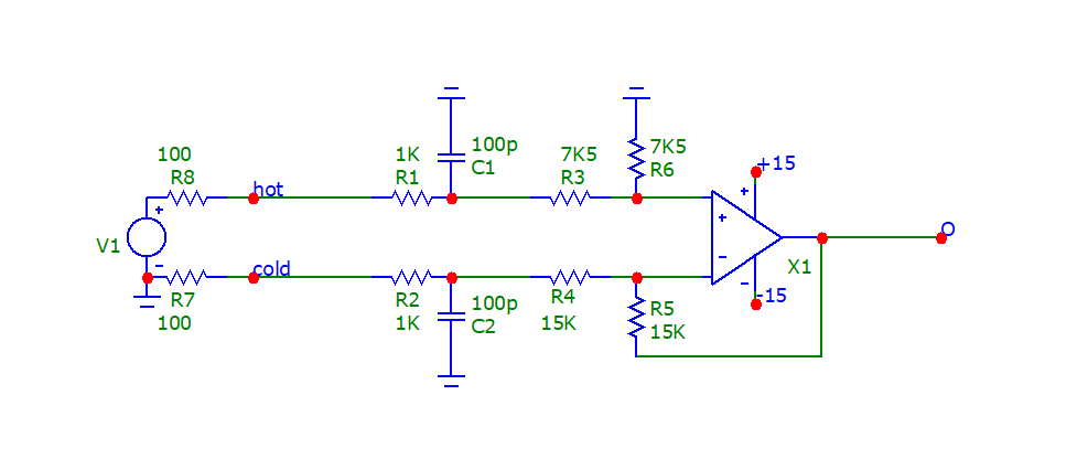

I realize the OP is looking for a simple solution. Rules out the instrumentation input (which has excellent CMRR, especially when you operate it with gain).

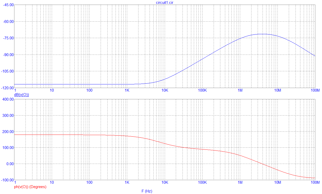

I think the next best solution is to use one opamp and balance the impedances at the source. You can measure the output impedance and add the same resistance for the "cold" connection. Use microphone cable of course. As shown it has a gain of -1dB and a cut frequency of 1.5MHz. (This universal input can be adapted for any type of source.)

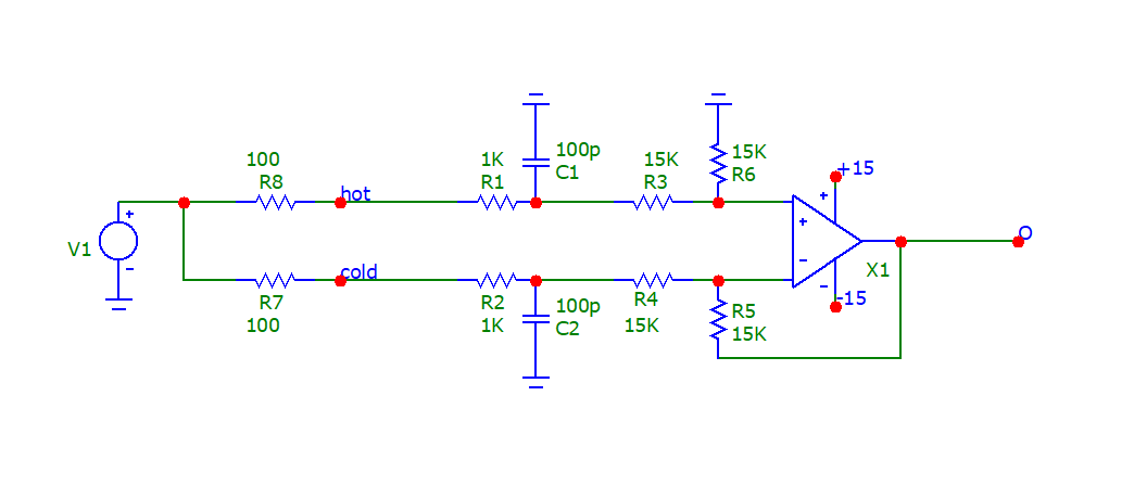

Surely the way to look at this is to short the + and - input legs together and to then apply a noise stimulus between the junction and ground. If you do this with a standard single opamp balanced input circuit and 0.1% resistors the CMRR is >50 dB. Quite a respectable number for little cost.
Hi, as pictured, circuit will still need very careful resistor matching which is normal, but in addition it requires very low current noise opamp (eg jfet input device).
What you said is correct, source needs balanced impedances which is actually super easy to make; just terminate source output (assumed it is not tube and it's output Z is close to 0) and return wire (this mostly being analog ground) with matched resistors in range 50 to 200 ohm.
Usual differential receivers (ssm2141 THAT124x) can be used at other end then and they already have precisely matched resistors on board... Hum gone 😊
Reactions: jan.didden
That sim assumes perfectly-matched resistors. Try the simulation with a 1% mismatch in the 15K resistors and see what you get. R1 & R2 also will affect the CMRR but to a lesser degree (percentagewise).
If you want to take that route, an instrumentation amplifier would perform better. Finding a resistor array with closely-matched resistors would work, too, but I suspect the combination would not as cost-effective. I found some .1% matched 4-resistor arrays on DigiKey in the 10K range. They will cost you somewhere between $4 and $10 apiece. For comparison, you can get a single instrumentation amplifier in the TI INAxxx product line for something like $2.77. That's for models with decent bandwidth.
Yes, you need good matching or you should select. That said, modern metal film resistors on a reel (SMD) are remarkably close in tolerance. I used this circuit on the front end of the ax-Amplifier and measured 45 dB without matching using 1% tolerance resistors. For a few pennies more, you get 0.1% tolerance and 54dB worst case. If you couple 45 dB CMRR and have good layout and hum mitigation in the amp overall, you are ‘off to the races’ in other words you will have a very good measured result.

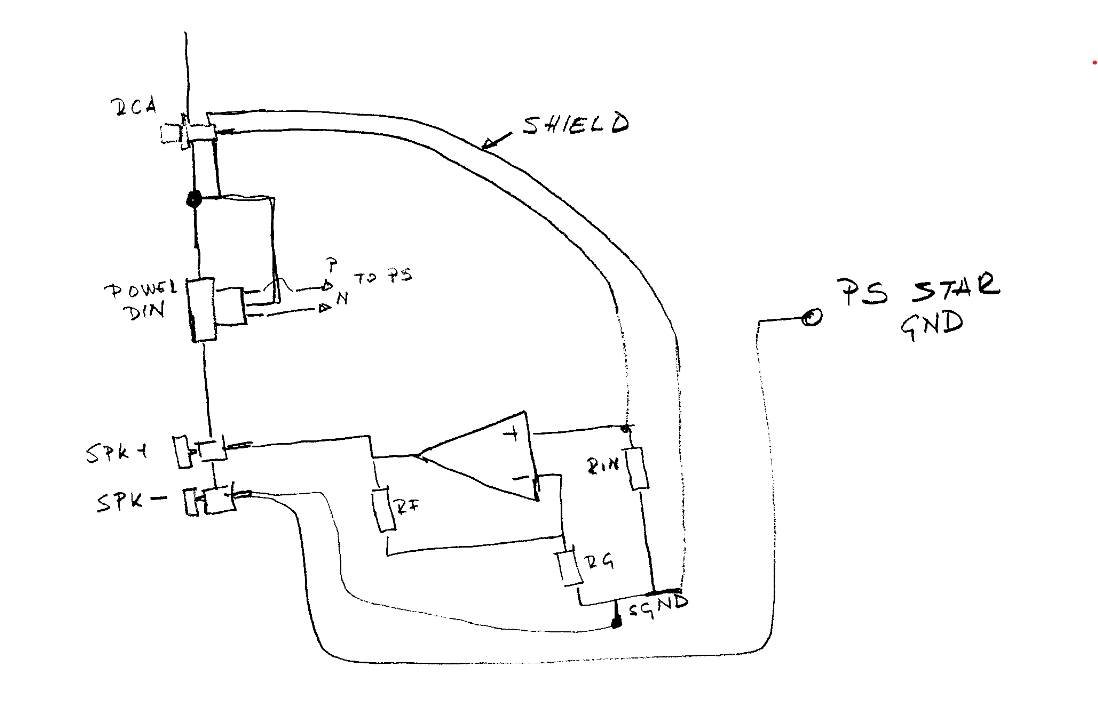

Here is what I do with them, as example last year I rebuilt 6 channel - dual power supply (cant get more complicated than this) from horrible hum to total silence. Once I will make small thread about it as many mechanical and wiring issues are shown there, still no time from my side.
This my raise some eyebrows as it is not how most people do it, sketch diagram:
All RCA connectors grouped together (not at each end of amp as some do) and its shield (ground) connected to the chassis as soon and as solid as possible.
Power input ground connected to the chassis also as soon as possible, at same place where RCA-s are grounded (if possible).
This will allow dirty ground signals to be shortened asap, without leading their ways into the electronics.
Input cable (coming from RCA) goes to amplifier; signal wire to + input, shield to SGND.
SGND is small point where Rin and Rg of feedback network connect . (this is simplified schematic without feedback condenser and other things)
Now we need to connect this SGND to system PS GND somehow, I take it from speaker negative terminal as this is where we want to measure feedback voltage, this reduces THD a bit too.
Speaker negative terminal is finally connected to properly built PS central ground. (by properly built I mean trafo- rectifier- capacitors and PS ground taken at the end of this chain)
Safety ground is connected to chassis directly, and to PS ground via input cable shield (I have 6 inputs , so plenty of cable surface for safety, cable with thicker shield can be used if anyone is concerned for safety) and than speaker - wire (this one is thick). There is no loop and chassis is extended shield.
Feedback is connected directly to speaker, where it belongs.
No ground lifters, no lifting resistors, ground insulators, and no hum.
Edit: forgot to mention; local PS capacitors at PCB: their ground is lead directly back to PS star ground, no connection to SGND.
